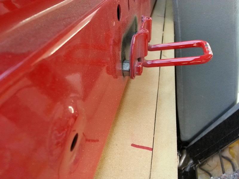

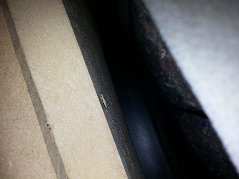

    Here's what I mean. Here's the spacers I used for the top anchor point.
    And this is the best pic I can get of how much room there is for the sub behind the seat.
    Hope that helps.

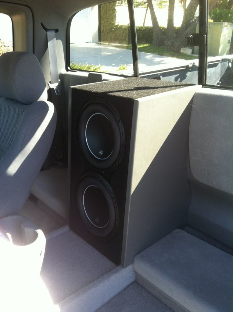

  18. Apr 14, 2014 at 5:36 PM
    #78
    shaneckc
    shaneckc Fyntünd Designs Vendor
    Jun 23, 2010
    #39362
    1,305
    Shane
    Thousand Oaks, CA
    2014 SR Package DCLB 4x4
    I'd argue that it sounds better than a "traditional" box. ;)
    I have no idea what dimensions I went with. I built it into the truck with much less planning and forethought than I typically would give a project like this because of time restrictions when I was finishing my setup. All I know is that I got my air space correct. But the reason I built it like I did was to retain rear-seat usability. It's much more crowded, but well worth.
