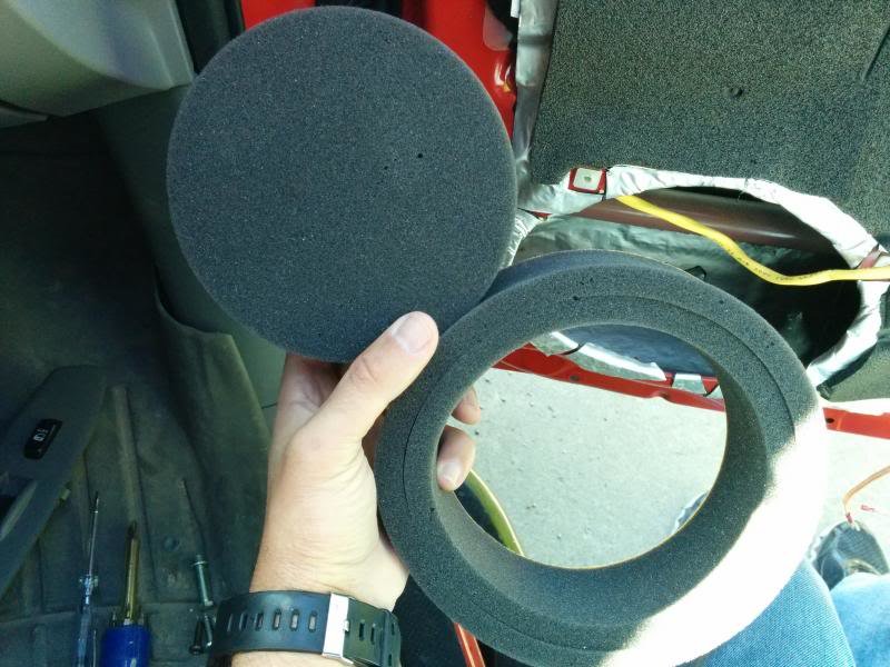

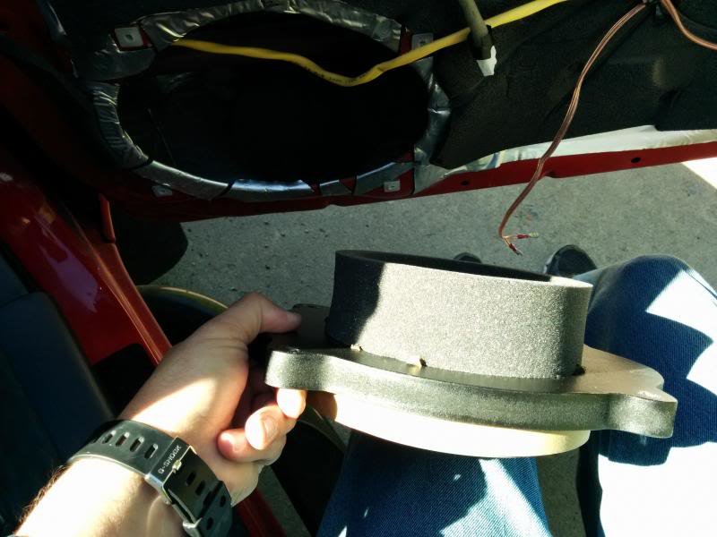

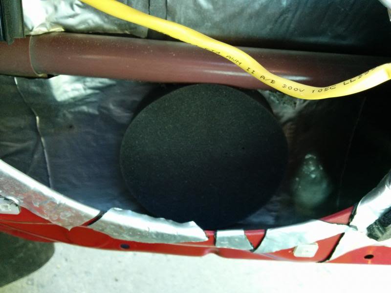

    Okay, so thanks to Aw9d, I got a set of F.A.S.T. foam mounting rings in the mail, and here's how they go in.
    First things first, take the door card off and reveal the speaker.
    Take your F.A.S.T. rings and pull out the middle plug.
    Put the plug on the outer door skin. We have an issue with our trucks of the safety bar going right where you want the plug to go, so it has to go about 2" lower.

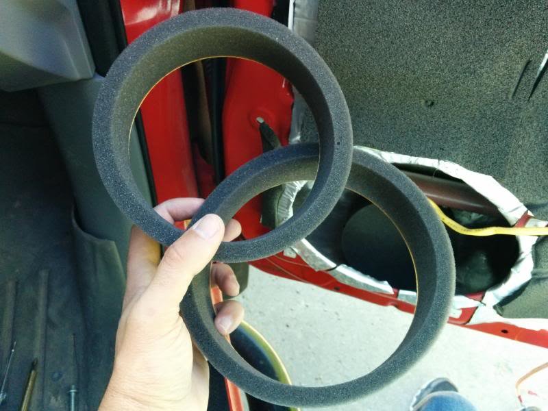

    Then separate the inner and outer rings.
    The inner ring goes on the back of the speaker adapter, do direct rear waves the correct way, and to cancel standing waves for better mid and midbass production.

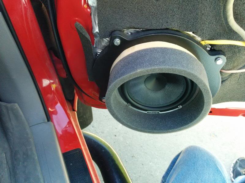

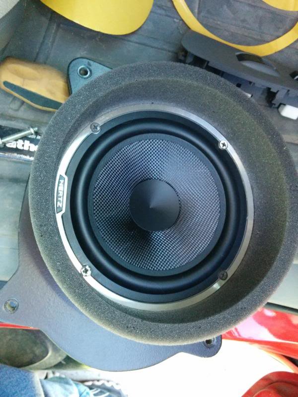

    Outer ring goes around the front of the speaker, to seal with the door card.
    Finished product. Remember to tighten the adapter plate in a criss cross pattern, to get an even pressure on the plate and a flat mount on the door panel.

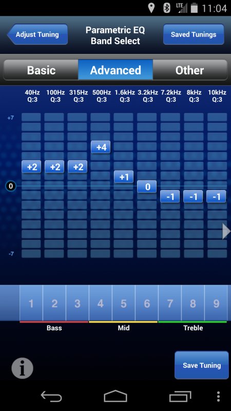

    "Finished" EQ settings. I dropped the 100Hz, 315Hz, and 500Hz levels by 3db each, and still get a full and rich sound.

    Looks good! Any big change in sound? Did you get that midbass response like you wanted?
  12. May 31, 2014 at 7:22 AM
    #132
    ZMan2k2
    ZMan2k2 [OP] “Hold my beer and watch this!”
    Aug 28, 2011
    #62491
    1,833
    Richard
    ‘Berta
    06 Rad Red DCLB SR5, ‘25 SS Red Sport Prem. (on order)
    Yes and no. It's close, I'm going to try changing up the tuning freq. a bit, I think. I might be concentrating on too narrow a band down low. It's a lot better than it was, but I've got more tuning to do. That's why I put the quote marks around "finished" tune. You're never truly finished tuning.:D

    Yeah, the foam rings are great! They really move the mids and midbass forward, and give a great seal to the door-card. They prevent rattles, and bring out the low end that I was looking for. Well worth the money. Thanks for your help.
