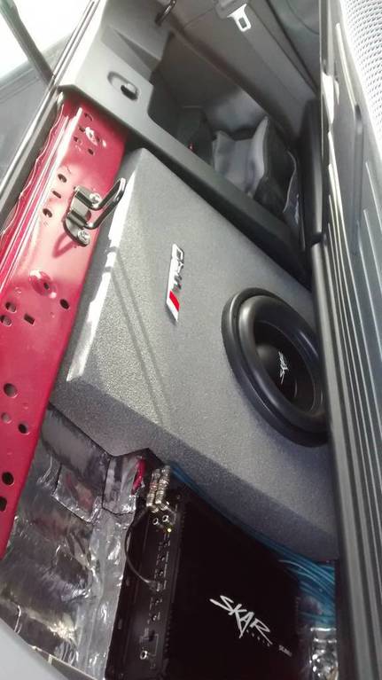

    "14 Tacoma TRD Sport
    Front skid-plate, bilstein shocks, custom 1000 watt Skar Audio sound system, quick-shifter, and TRD 6 speed shift-knob.
    About the deepest I can go with my box in my 2014 D.C. is 6.5" (if you want to keep the plastic). The picture below shows my SKAR audio VD-10 which has a top mount depth of 4.6" and it just barely fit in the box. With the x-max on the woofer, there's no way I could go any bigger.

    I would take the rear plastic off the seat. Allows for more excursion of the sub, and helps the sound some.
