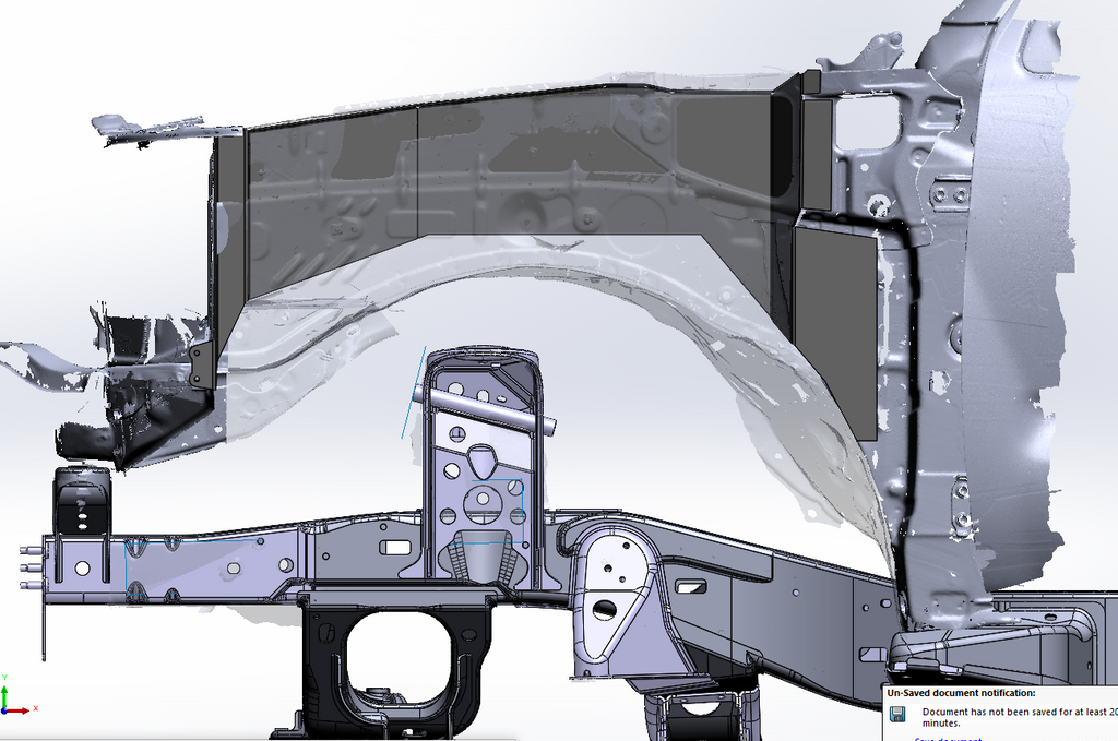

    Are there any good high-res 3d scans models of 2nd gen Tacoma body that shows this configuration/pathway, from the driver side fender into the cowl?

    This is about all I can find, not sure if it's a 2nd gen but seems like it is. Ignore the dark gray sections. Looks like the entrance into the cowl is in the top right.
