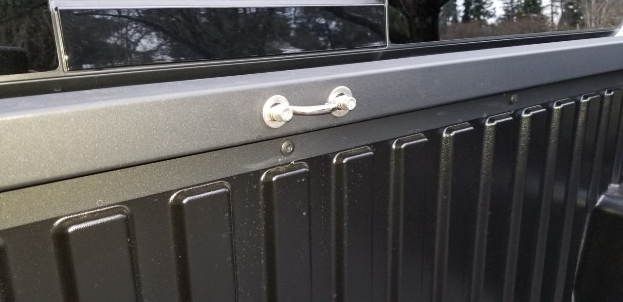

    I did just this, but I ride a MC also. But would not trust it for that. I am only going to trust it for a tie down for a mtn bike or a bed net. Here is the pic of what I did...I found the SS hook at a local hardware store, bent it just a touch to spread it to the right width, installed a few washers behind it to take up the extra room and I believe it is M6 SS socket head cap screws that I used. I also used med strength locktite.

    I can confirm M6 fits nicely
