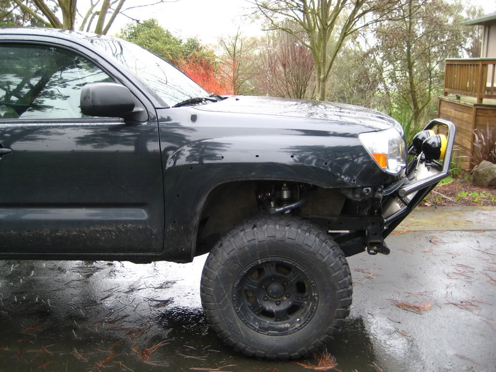

    6 luggers come stock with flares....5 luggers dont. you do not have all of the holes in the fender to accommodate the clips to hold them on. you would have to cut out all the holes in your fender to make them work.

    Yep, that's how it is. This isn't a great picture to show it, but you can see some of the stock fender holes from kevin1337's truck after he removed his stock factory flares:
    And here are the instructions I'm following to install the bushwhacker flares.
    http://www.bushwacker.com/Instructions/31920_r6.pdf
    You'd pretty much do the reverse. Wherever you see one of those colored plastic fender clips, you'll need to drill a hole.
