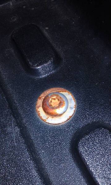

    So since I bought this truck in November of last year these pesky bed bolts have been bothering me. Its a 2010...I don't want rust! The whole bed is black and those damn rusty covered bolts just stuck out too much. Took them to the dealership to see if I could get them replaced but it was just “surface rust”. Keep in mind I plan on putting a bed mat in but I didn’t want to just mask a problem.

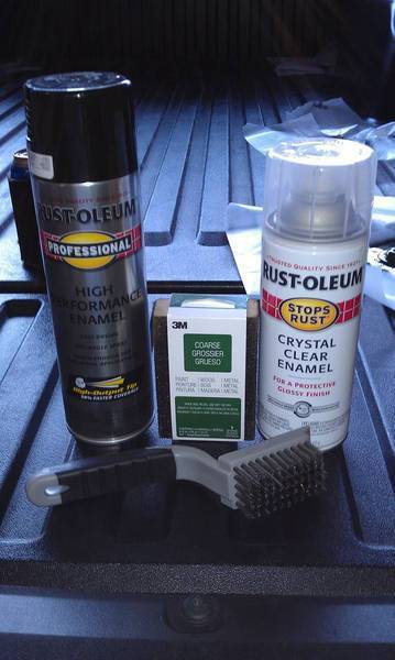

    Needed:
    -Masking tape
    -wire brush
    -wax paper
    -3M Coarse sponge for metal
    -Black High Performance rust-oleum
    -Clear rust-oleum

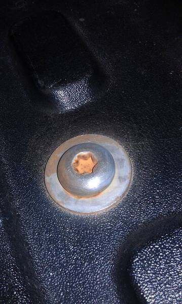

    First step- take that 3M coarse sponge and go to town on the bolts. I switched back and forth from the wire brush but saw better results with the 3M.
    Before:
    After:
    I was impressed with how easy that was....so I paused and had a cold one.

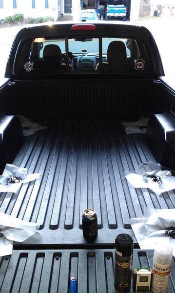

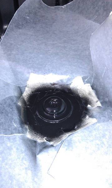

    Second step- tape up 6 bolts and enjoy another cold one. Tear up some wax paper to put around the tape for added protection. (You can actually slide the tape under the bolt). I didn't have any of the blue tape one would normally use for painting so I just grabed masking tape. Keep in mind I am putting a bed mat in so the little paint that got through the tape doesn't bother me.
    Second step- blast them with black rust-oleum….and drink another cold one. I went back over them with 3 coats.
    Third step- blast them with clear rust-oleum and wait for them to dry
    Fourth step- peel off tape and wax paper and step back and enjoy this cheap fix....while cosuming another cold one.

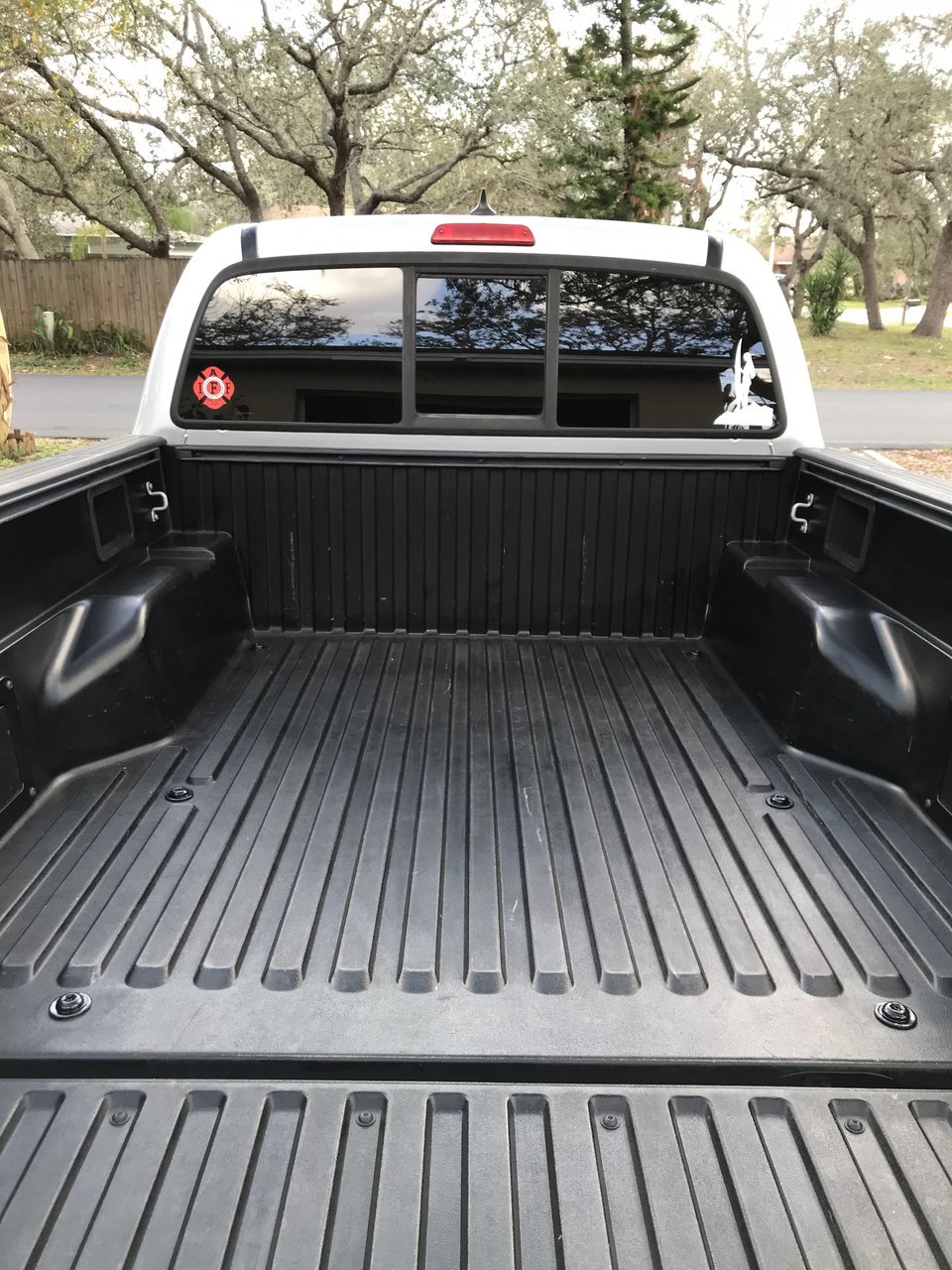

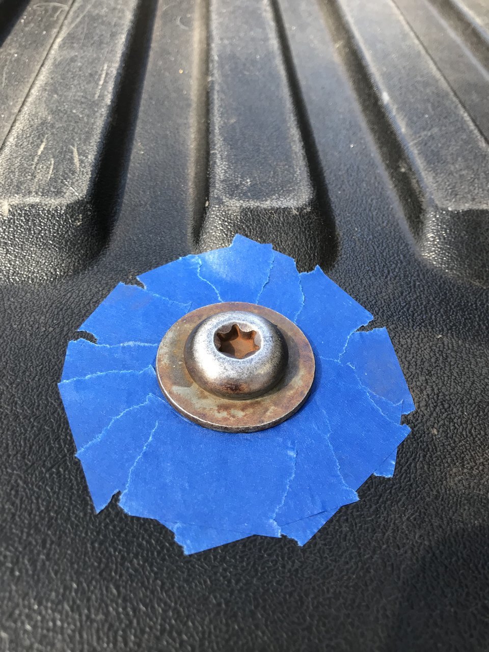

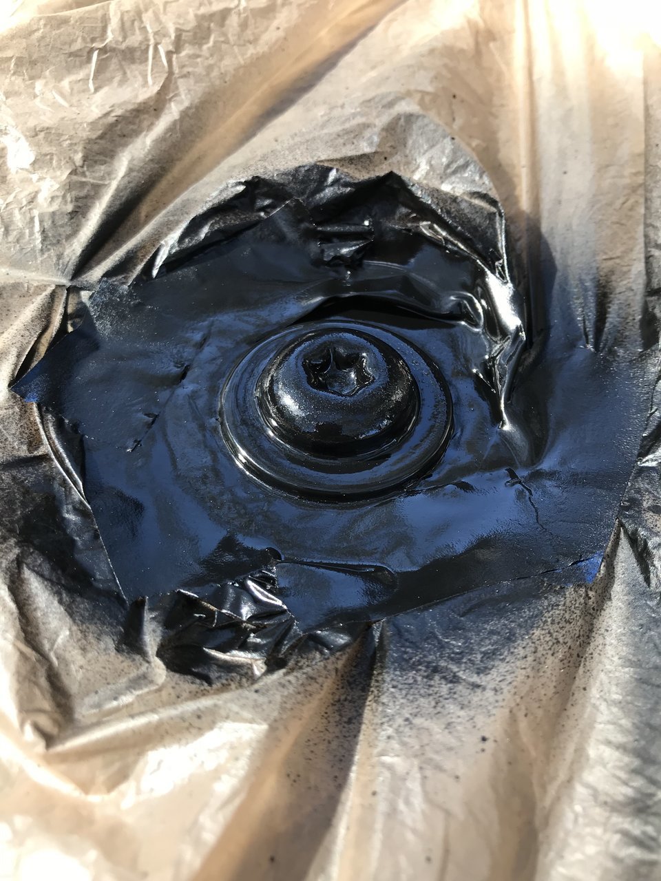

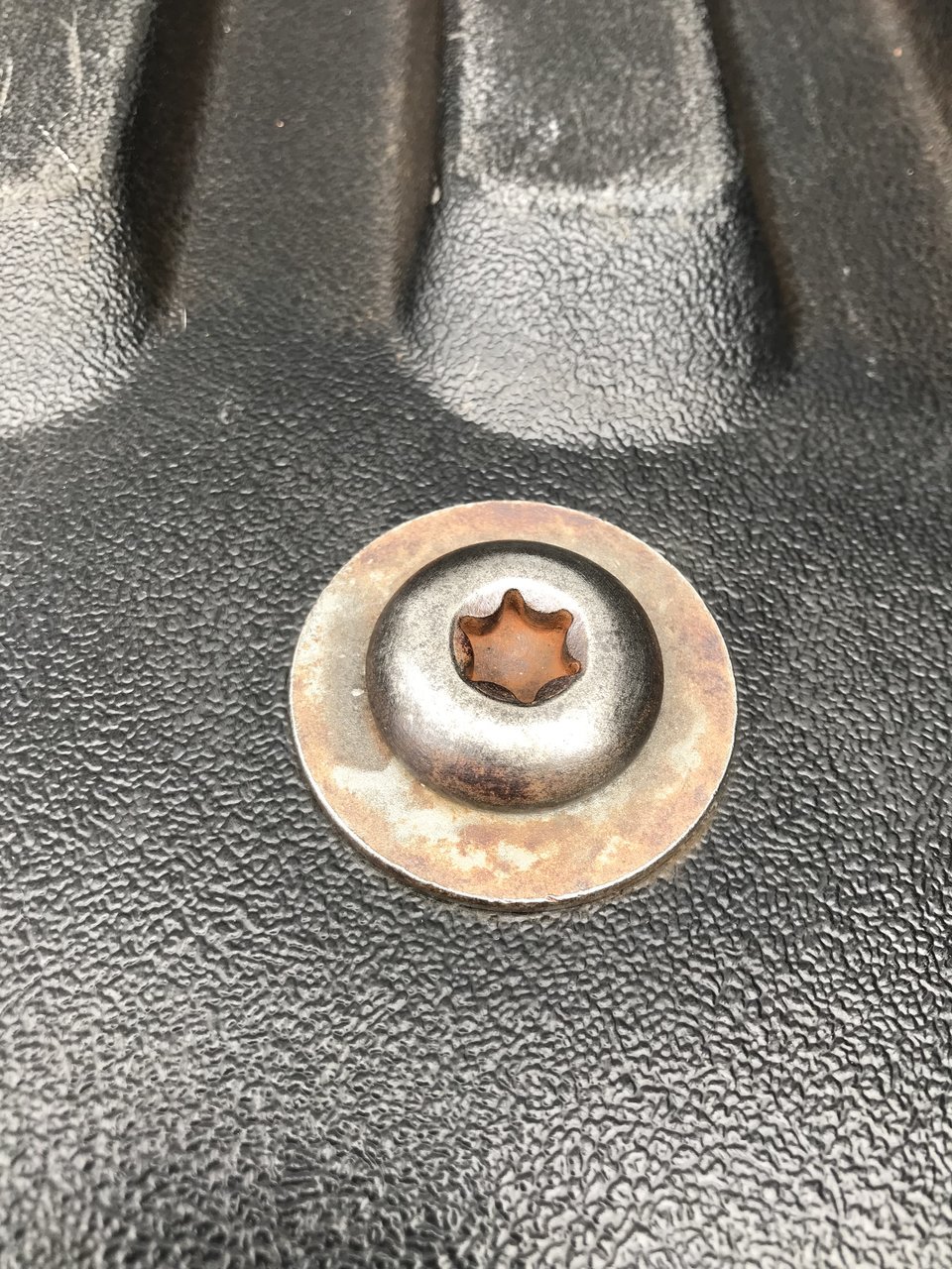

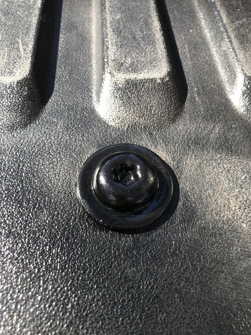

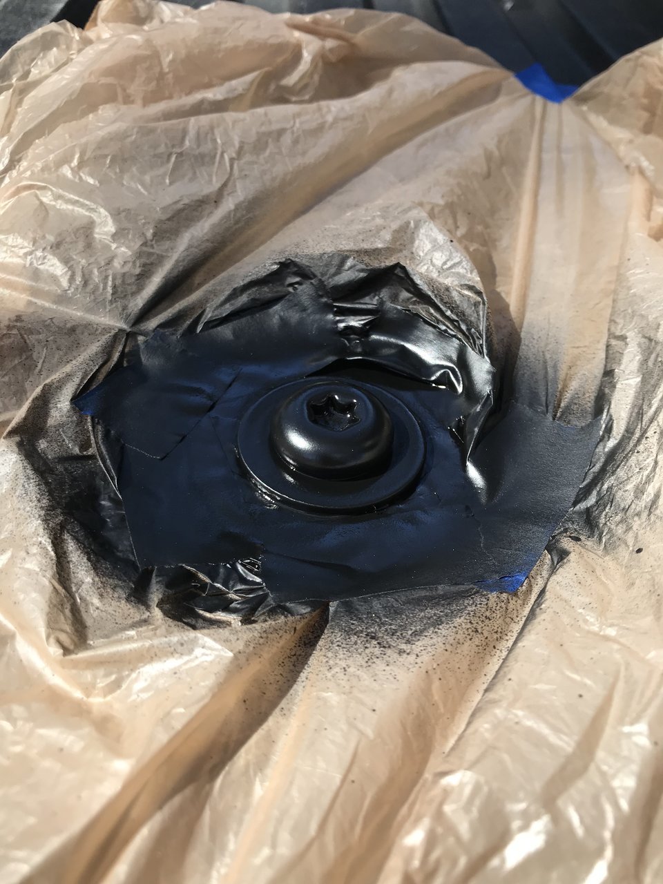

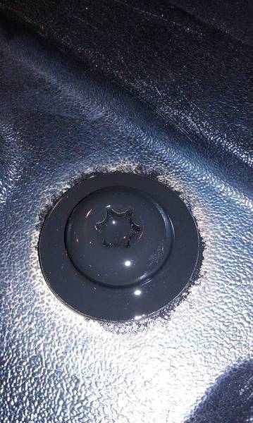

    Well XD40SC, this was a killer thread and since I live in the wonderful land of Florida, this had to be done on my truck. Followed your directions to a "T" minus the beer part. I cant explain drinking at 11am and yea yea, I know, its 5 o'clock somewhere. But here are my results...thanks so much!!
