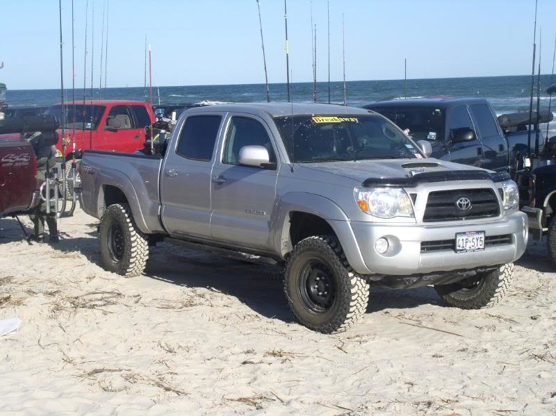

    Not sure what the over all lift came out to be but I love mine.
    Before......
    After......
  5. Mar 19, 2009 at 4:50 PM

    Cool pic!
