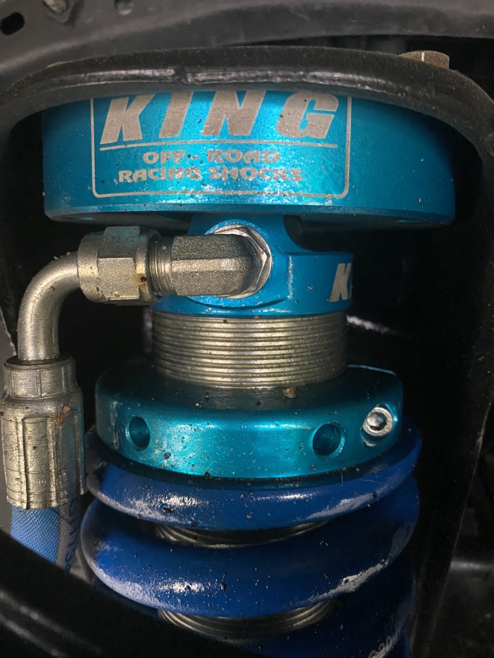

    Jack up the front until your wheels are at droop. Use WD-40 on the threads before turning. And when you loosen the collar screw, only turn it half a turn.
    https://www.polyperformance.com/kin...MI0P3_qJaO8AIVQQnnCh02GA8GEAQYASABEgJfhPD_BwE
    This tool saved the headache with reaching the collar holes blocked by the shock mount so I suggest you buy it. Not sure how many turns it took to reach the height I needed but I just measured hub to fender after a few revolutions until it matched the rear measurements.
    Lower the vehicle after re-tightening the collar screw and drive back and forth to settle and repeat if necessary.

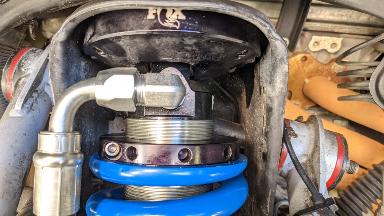

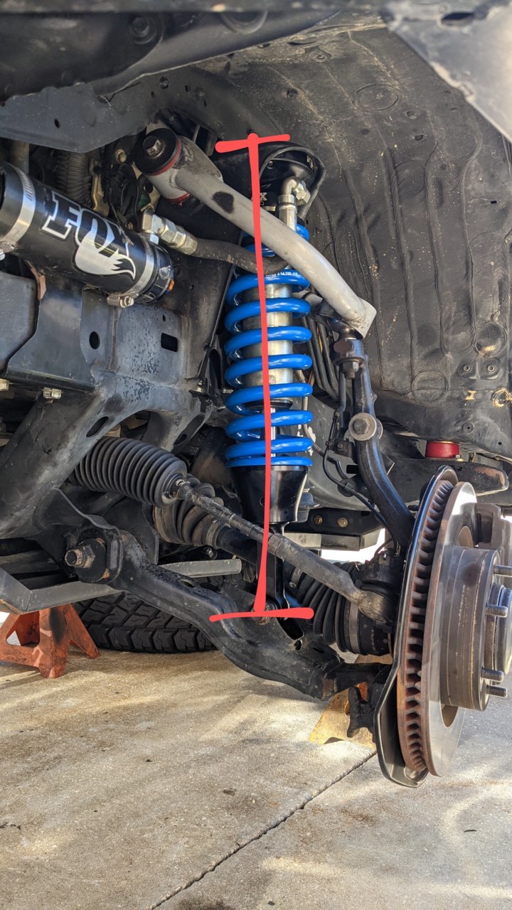

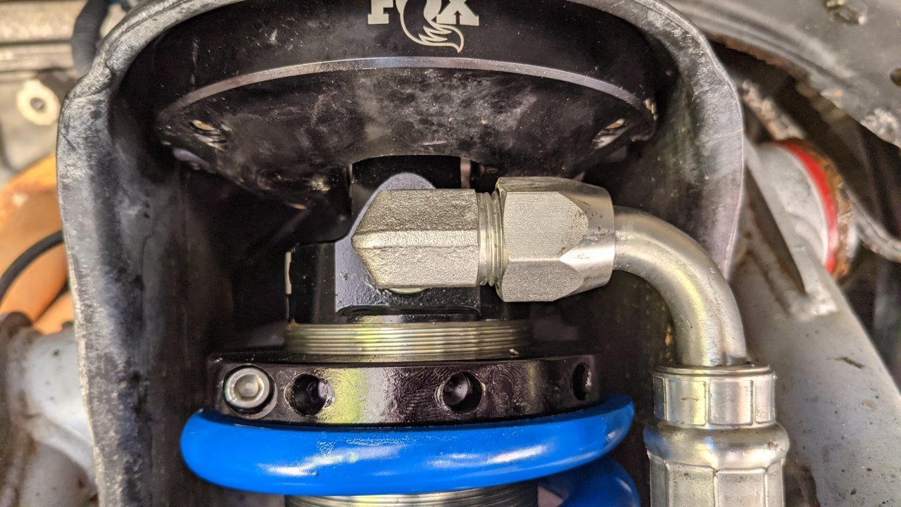

    I have Fox's not Kings, but I am running King 700# springs and springs is what sets height anyway In this aspect Fox and King are close enough.
    I have an ARB bumper, a 8000# winch (Synth line) lots of gear and lights and I am running 3 threads passenger 7 threads driver.
    Irregardless the length with weight on the truck from center of eye to center of eye should not exceed 21" per Accutune Off-road.
    I am dead nuts at 21" with weight on at this set-up and my weight, your results will vary.
    21" there to there
    Driver more threads for Taco lean (battery driver fuel tank) weight accomodation.
    Passenger:
    EDIT THIS IS WITH 14" 700# SPRINGS!
    If your's are shorter you will need more threads.
