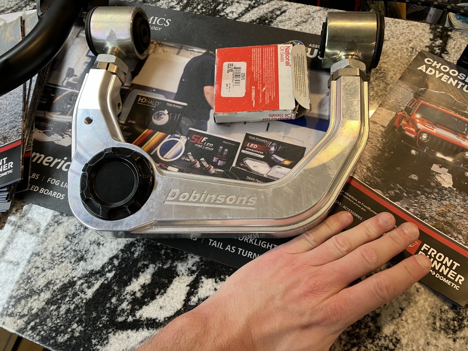

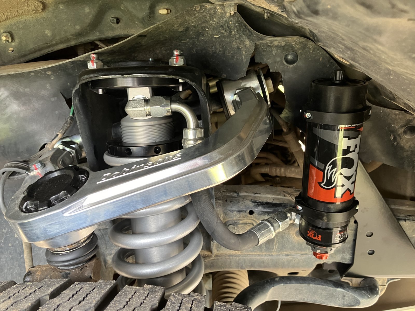

    I went with Dobinsons adjustable UCAs for the adjustability like JBAs and SPCs, but also because they;'re aluminum (so no concerns with rusting issues and lightweight vs steel) and use a parts setup similar to the factory UCAs (so if something breaks it's pretty easy to source replacement parts and other than checking/cleaning not much more maintenance than OEM UCAs). Main downside is they aren't cheap, so I waited for a Black Friday sale and also got a deal with the shop doing my suspension install work. They also of course need a shop with the right know-how and experience to properly adjust them for your alignment setup to get the full utility.
    https://exitoffroad.com/product/dobinsons-billet-aluminum-ucas-toyota-tacoma/
    Andrew.arw[OP] likes this.
