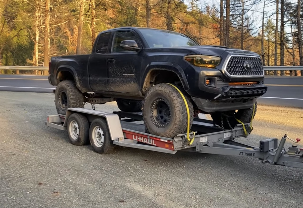

    This video is about a 120k mile 2018 TRD Sport Access Cab 4wd with a manual and a pretty extensive mod list that had a quiet questionable life so far. Blown engine at 120k and a interior that can tell some stories.

    That truck has a lot going for it, a shame it ended up that way to begin with but nice come up for this guy. Would like to see the outcome of what he does with it.

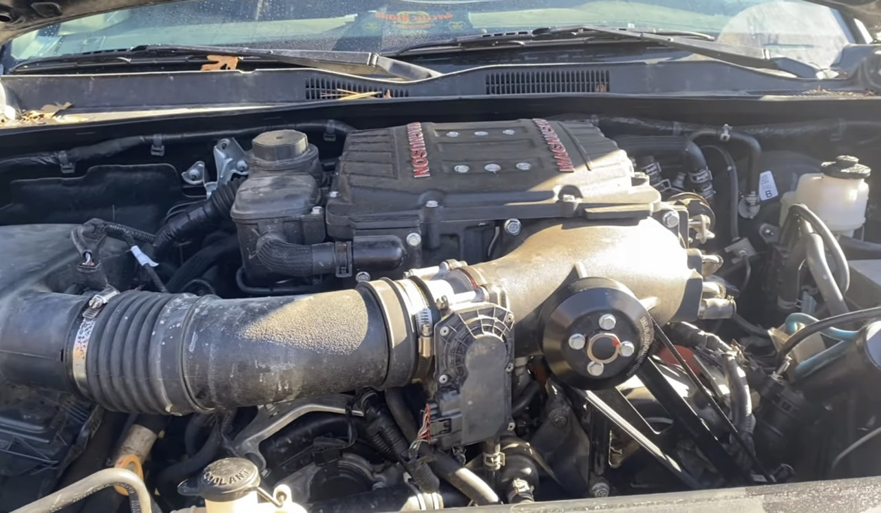

    Those sounds from the engine!

    Wow that thing is trashed in so many ways

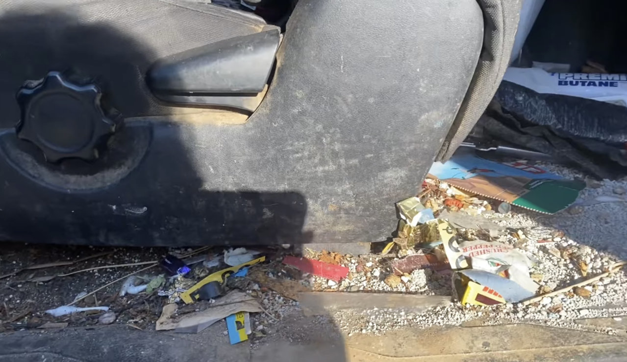

    are those little crack rocks all over the floor?

    The previous owner.. geeeeeeez what a tard.
    Maggy on there eh? Hmm. Betcha someone on here could figure this out.

    Looks like a fun project. That engine noise in the second video really doesn’t sound that bad. Engine internals don’t make those sounds. That is supercharger or another accessory. My vote is on multiple stuck supercharger idler pulleys and a broken nose drive. I’ve had both of those fail on my magnuson and make similar noises. I’ve also had many water pumps and alternators over the years sound like that.

    Sounds like the S/C to me.

    The clattering sound when the engine was running sounded like there was a broken piston rod or two clanging around in there. I wonder if lack of routine maintenance combined with the Magnuson was the culprit for the early grave?
