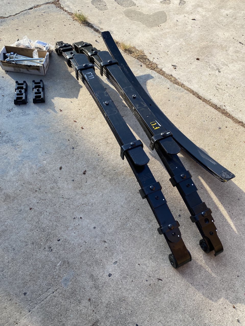

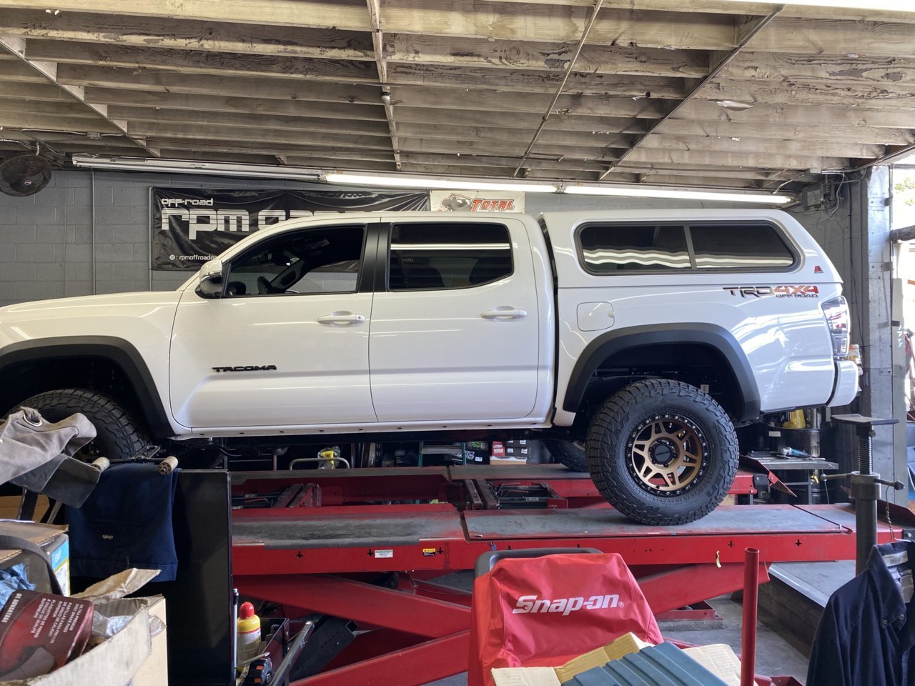

    I landed on getting the Icon RXT leafs delivered and installed (to eliminate said shell sag). Suspension is just something I don't do myself. I don't have the lift for it. So I got RPM garage to do it. They rule. Just incredibly nice, knowledgable, guys. I highly recommend them.
    My truck came from the dealership - brand new - with dealer installed TRD Lift, 17 inch method wheels, and 275 wildpeaks. I loved the rake and lift. And it was exactly what I would have done to the truck myself... plus I got them to knock off the dealer installed option markup (and got the truck at msrp).
    ANYWAY, I put a Leer 100XR on it. I lost an inch of rake and developed the appearance of a sag. Hence the above thread about sag.

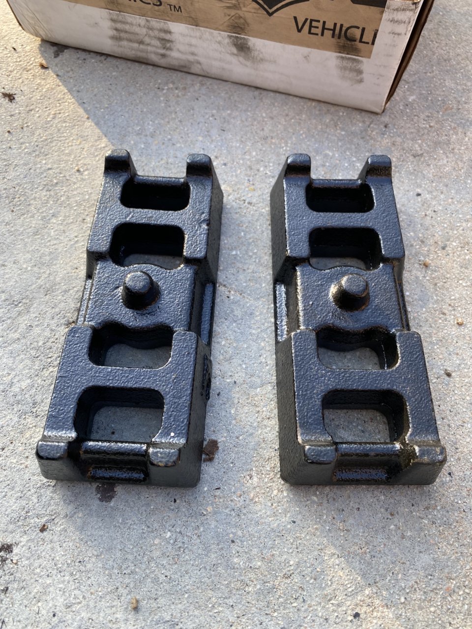

    RPM put the leafs on today. They pulled the rear one inch TRD lift block and put the Icons in option 2. I thought it would bring back the 1 inch of lost rake - but it seemed to boost me up two inches. I'm wondering if I should have gone option 1 now. The truck definitely gained some height. Love the drive. Just don't totally love the giant rear lift. I wish it was a bit more level. Would love some thoughts and opinions on whether option 1 would bring me down an inch? I really just plan on letting the shell live on the truck - and packing it up with camping/surfing/climbing gear when needed. But not all the time.

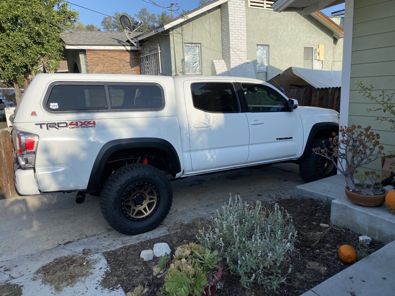

    After leaf install (before in the thread above):
    Now that it's done - and I'm up 2 inches (at least) do I need to upgrade my upper control arms at this point? I'm seeing a lot of conflicting opinions on this (searching old threads). It wasn't easy for RPM to align it with the oem uppers but they got it done - and I'm tracking straight etc. They managed to get about 1.6 caster out of the oem uppers which is about as much as they could go. Everything's great, the ride, nothings's rubbing etc. Just keep reading about how much I should want 4-5 degrees of caster on here lol. Not looking to spend an additional $1200 if I don't need to though, obviously (on upper arms). It really does ride great. Highway, city roads, train tracks... feels good. Easy to steer, not too stiff.
    One more of the truck in the driveway with the icon leafs on:
    On a side note: I only have 327 miles on the truck. So who wants oem Toyota leafs, U bolts, and TRD rear lift blocks with 327 miles on them? Come pick them up in LA for $100 for all (AAL's not included):

    I would guess that the new leafs will still settle some eventually, maybe it will settle out where you like it? I have a camper shell on my Tacoma and with some extra gear back there the sag is pretty noticeable. I'd like to fix mine too but I'm not really looking for more lift either. Oh and I want it to not ride rough. Hopefully you figure out the magic setup for me!
    I am new to the Tacoma game but have lots of experience with 4Runners and some Land Cruiser experience with UCAs. If you are fine with how it drives and tracks on the interstate and aren't trying to get some more tire clearance at the back of the wheel well, I wouldn't worry about new UCAs. I installed an Eibach Pro lift on my wife's Tacoma and think the caster after alignment came in at 1.6 too. Drives like it did before the lift as far as I can tell.

    I put a snugtop on my longbed. I found that just loaded for a quick camping trip my stock springs went flat. Switched to icon rxt on stage 2 in the back and replaced the coilovers and UCAs in front. I didn't change the front height much but got the 2" lift in the back described above.
    It will settle a little bit but not that much. I've grown fond of the little bit of extra rake when completely unloaded. Where it shines is loaded for camping or carrying a bit of firewood. No sag at all and rides like a dream.
    Don't sweat the rake. The look grows on you and it makes for better performance when loaded.
