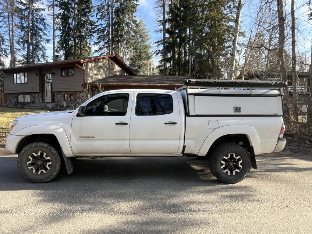

    I just threw some Icon RXT leafs in at option two based on their specs. I run the topper, awning, and decked in the back so was guessing around 350-400lbs constant weight (Pic below). I was hoping that weight would squat it a little more than it does. After installing the leafs at option 2, it bumped my truck up 3" in the back. Center wheel to fender is 24" in the back and 21.5" in the front. I put bilstein 5100 in the front to level it out and b4600 in the rear last year as per the shop recommendation. Now it seems i will have to adjust the front shocks up and potentially get new rear shocks or drop the RXTs down to option 1 and hope its back down to even out with the front. Im not opposed to lifting the truck furthter but dont need to and would rather save the money.
    Has anyone had the same issue and a good solution? I am assuming if i were to just run this i would blow out the 4600 shocks quick?
    Ive read through a lot of the threads and dont see much on this particular scenario.
