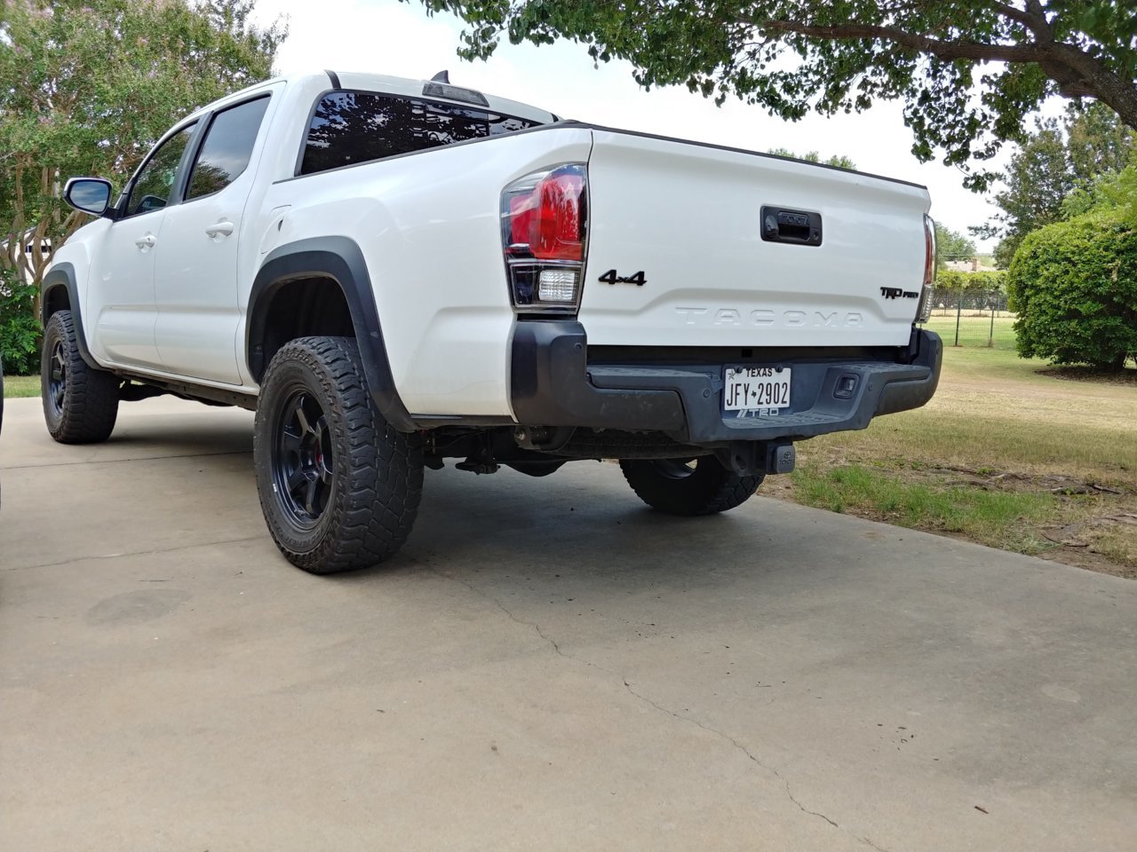

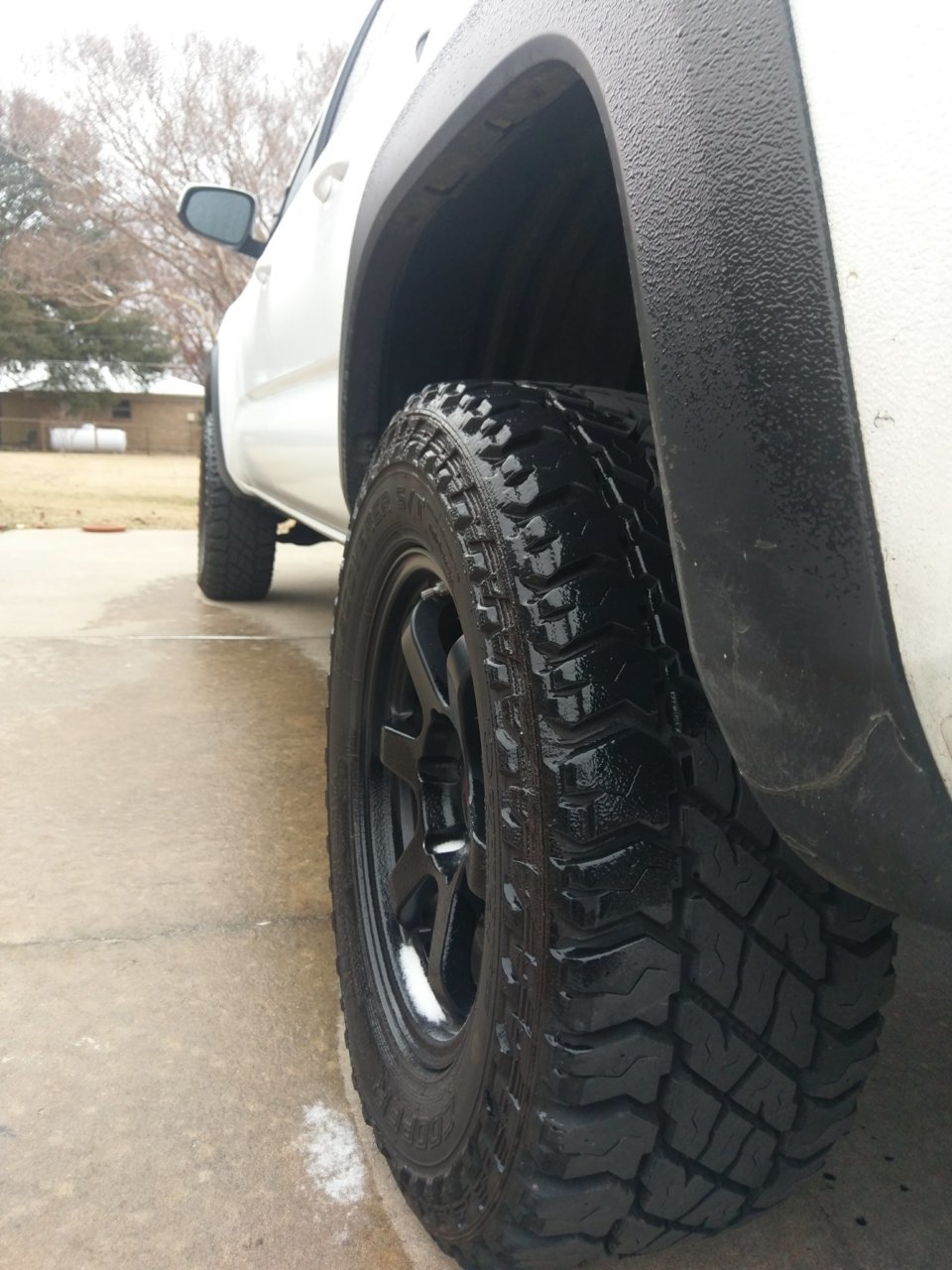

    su.b.rat
    su.b.rat broken truck
    Jul 30, 2016
    #193316
    9,869

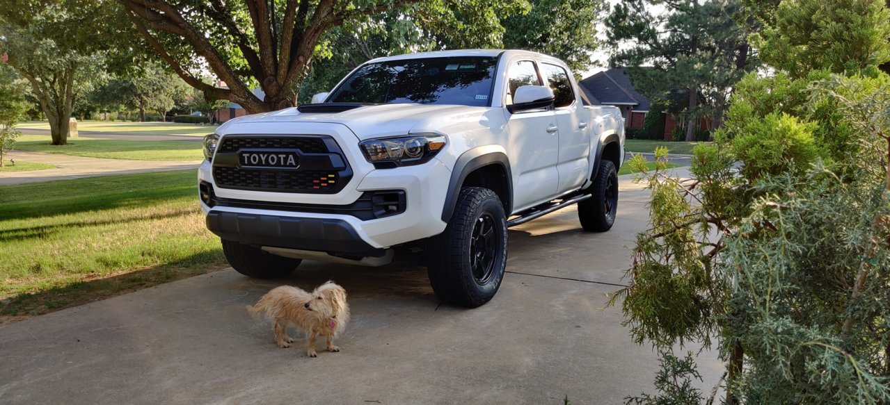

    yep. here is 17x8, 4.5"BS, 0 offset just for a reference.

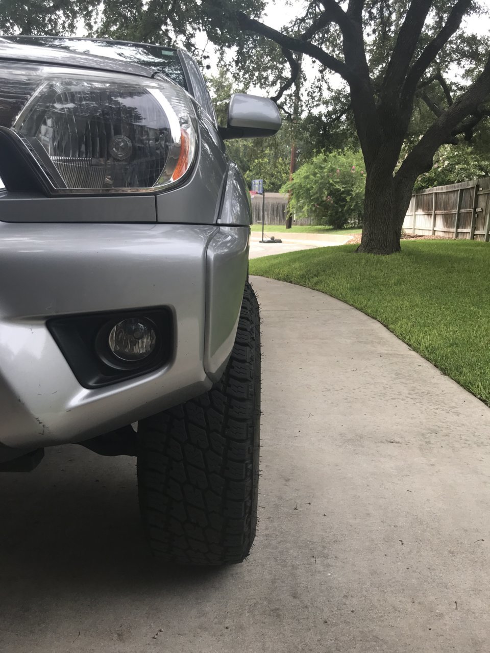

    gotoman1969
    gotoman1969 Well-Known Member
    May 30, 2018
    #254966
    6,961
    Steve
    San Antonio, TX United States
    2015 Silver Tacoma PreRunner
    3" ToyTec coilovers, JBA UCA's, Bilstein 5100's
    su.b.rat likes this.

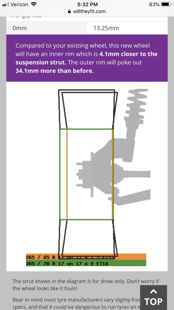

    eccracer104
    eccracer104 O.G. Member
    Apr 9, 2008
    #5854
    14,169
    San Diego, CA
    2016 Tundra 4x4
    Yes and no.

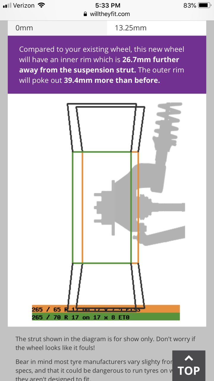

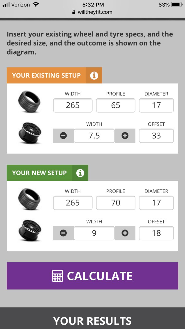

    Your new wheels are an inch and a half wider, but the offset/backspacing is a 1/4 closer to your strut and UCA.
    So they will stock out 1.25” and stick in .25”.
    Also check your tires, 265/70-17 can be stretched onto a 9” wide wheel, but this wheel is wider than recommended.
    You’d be much better off going with 17x8” with a 0mm offset / 4.5” back spacing.
    This is a nice tool for this: CA36F8A4-5335-402B-8792-6F91BE040237.jpg C676DEC8-C7FE-405A-AA96-62A0183A751A.jpg E62C8280-F8E2-43B6-B65E-E66CDE6359B4.jpg 79B28D65-6C2D-4C27-95F7-3ED3BE33527D.jpg

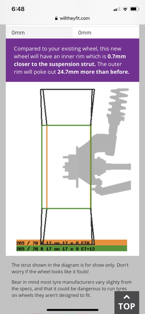

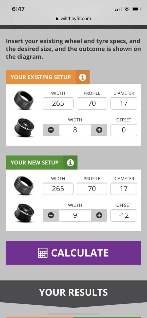

    danmtchl
    danmtchl [OP] Well-Known Member
    May 13, 2019
    #293151
    180
    Dan
    Bakersfield
    2019 Tacoma TRD Double Cab Sport 4x4
    I 03F75AAE-4005-46BE-8C0D-573CD0C51940.jpg 9C988776-5D2A-4E32-8B1D-2A67A6762E08.jpg
    Here is a 17x8 O offset vs a 17x9 -12 offset both with 4.5 offset. They are very similar.

    eccracer104
    Apr 9, 2008
    #5854
    14,169
    San Diego, CA
    2016 Tundra 4x4
    Both with 4.5" back spacing means the inside of the wheel will stay at the same spot. The only difference is the 9" wide wheel is an inch wider thus sticks out an inch further.
    You will rub the fenders with this wheel, requires some light fender trimming to accommodate the more aggressive fit.
