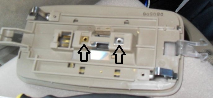

    To find +, with ignition ON, should read 12V, yes?
  2. Jul 14, 2019 at 10:51 AM
    #62
    caribe makaira
    caribe makaira Well-Known Member
    Feb 13, 2011
    #51121
    11,781
    Caribbean, Puerto Rico
    05 PreRunner TRD Offroad AutoTrans
    Hood Struts, My version Fogs always ON, Map & Overhead Light Mod,
    The overhead lamp is "always" hot...yes 12v DC +

    So that “hot” side is where I’ll screw a terminal ring crimped to the + side of my KC whites and the other side, the - side on the
  4. Jul 14, 2019 at 10:58 AM
    #64
    caribe makaira
    Feb 13, 2011
    #51121
    11,781
    That is correct...no checking for bubbles.
  5. Jul 14, 2019 at 11:25 AM
    #65
    caribe makaira
    Feb 13, 2011
    #51121
    11,781
    Do not allow the screws to touch the metal roof, insulate.

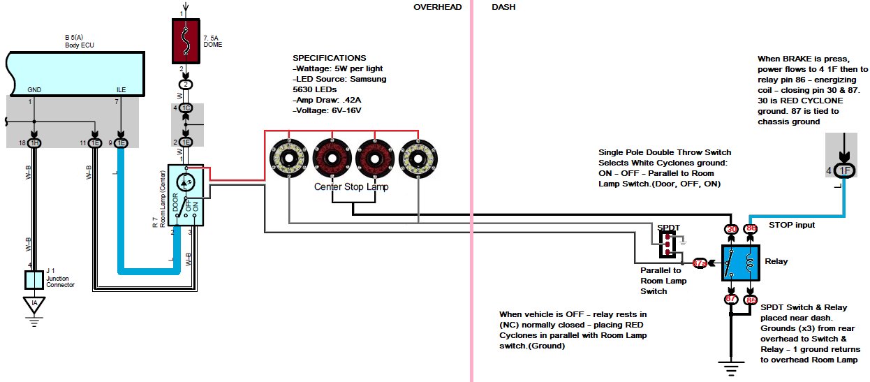

  12. Jul 14, 2019 at 2:17 PM
    #72
    caribe makaira
    Feb 13, 2011
    #51121
    11,781
    Read the drawing...it has a few paragraphs on it.:burp:
    There are a few mini spdt switches out there. Can be hidden, this switch will select whether the Whites RC Cyclones will be ON without the cab lamps being ON or All lights ON with the position of the cab lamp switch. (Door-OFF-On)
    The relay is for the RED RC Cyclones - No matter what position the cab lamp switch is selected the input of BRAKE overrides.
    ..."when you can't pick a rate go boatswain mate".:rofl:
    Aviation Structural Mechanic - Environmental. AME - Liquid Oxygen, Ejection seats...

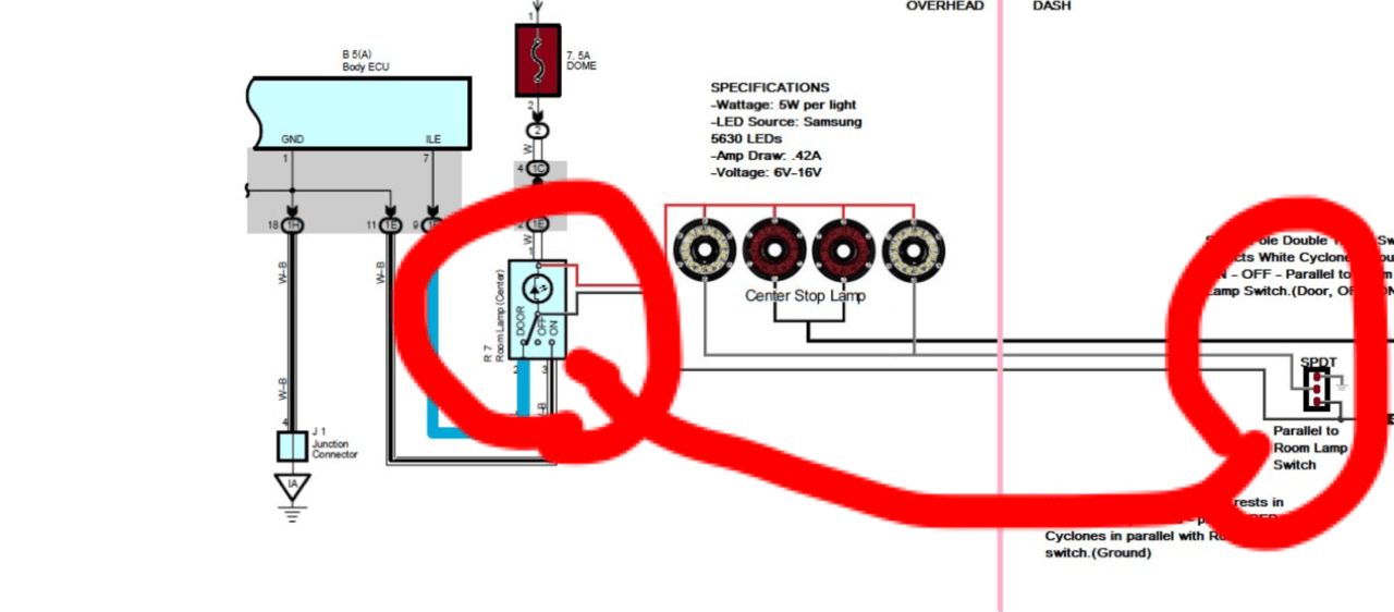

  13. Jul 14, 2019 at 3:56 PM
    #73
    NavyDiver72
    NavyDiver72 [OP] I DO ALL MY OWN STUNTS
    Mar 18, 2013
    #99967
    411
    Rick
    Millington, TN
    2006 DCLB TRD Sport PreRunner
    Any Mods? One. Maybe two, tops...
    How about this switch?
    https://www.parts-express.com/parts...e-momentary-rocker-switch-center-off--060-676
    That one I could hide pretty easy...
    And yeah, wasn’t really sure what I wanted to do when I came in 23 years ago, so I was undesignated Seaman, made BM3, then BM2 in Guam - and then went to Dive School, still having fun...
    Also, if I understand your notes correctly, this solution would ALMOST (no turning white lights all by themselves by using the mini switch only, the dome light switch would be involved) make the whole setup work with 2 out of 3 positions, yes??

  20. Jul 14, 2019 at 4:41 PM
    #80
    caribe makaira
    Feb 13, 2011
    #51121
    11,781
    No..one is the room lamp switch, the other is the one you'll be hiding somewhere...
