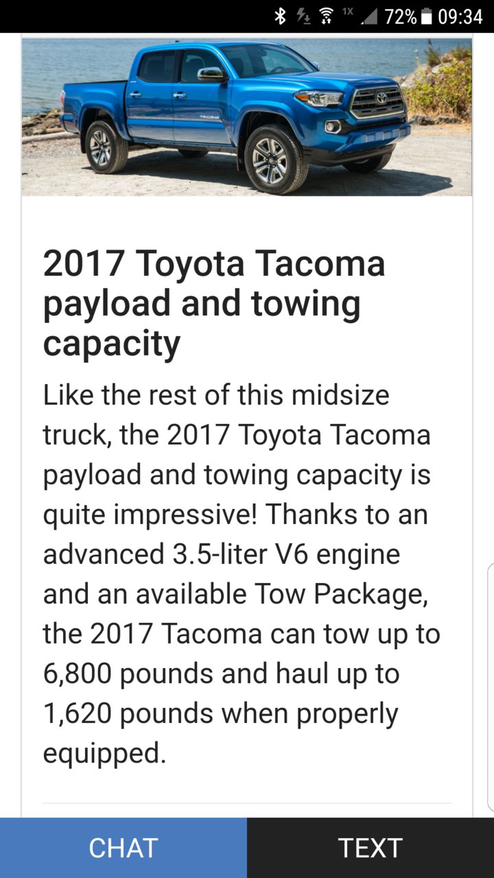

    You will be fine - but you say GVWR is 5000lbs? Is your tow package OEM or dealer installed? If by dealer, make sure it has the oil coolers too. Your GVWR should be 6800 lbs with the OEM tow package. Also, if the dealer added it, check to see if it has everything they say they put in.

    You should be fine. 4cyl rated at 3500lbs. 6cyl up to 6800lbs with tow package. I would stay under 5000 and not max it out on long trips.

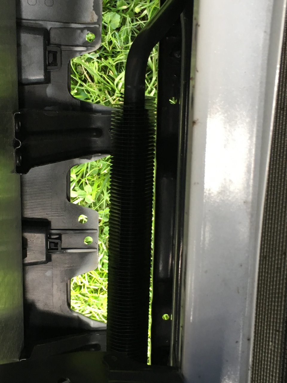

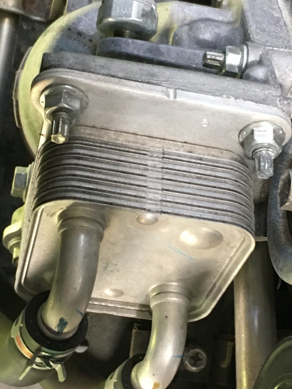

    Factory tow package will have these three coolers: oil, transmission and power steering
    4F953A04-CC76-46CD-B8DE-D0EDF7DF57BC.jpg AAA9A810-B2D9-41BF-8813-F549AA5DE2A3.jpg 25ADC560-D458-422B-801F-339773200E22.jpg

    I believe the 6800 pound rating is for 2 wheel drive 6 cylinder models and 6400 or 6500 for 4 wheel drive

    It's 6400 for 4x4 v6 with a 640 pound max tongue weight.
