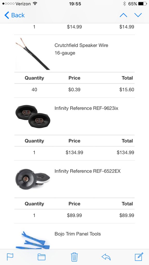

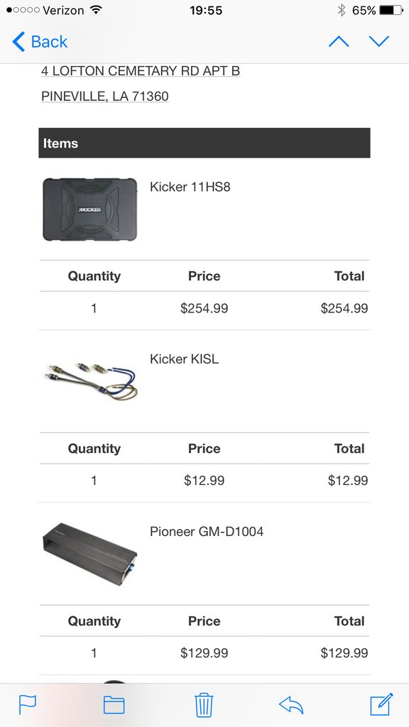

  15. Aug 15, 2017 at 5:58 PM
    BOONDOCKSAINT
    BOONDOCKSAINT [OP] Well-Known Member
    Jun 17, 2012
    #80803
    78
    Central Louisiana
    WHITE 2016 DC OFF ROAD 4X4
    Pioneer 400w amp Infinity Reference Ref 6x9 (front doors) Infinity Reference Ref 6 1/2(rear doors) Kicker HS 8" hideaway
    Well @NIU_Huskies @rob feature @crashnburn80 its ordered.
    Mick at Crutchfield was awesome, got me inside my budget.
    Only thing I wasn't sure about is, I went with an under the seat sub.IMG_0890.jpg
    Hopefully this is better than stock, at this point I was just tired of researching it.
    Hopefully I didn't do to bad.

  16. Aug 15, 2017 at 6:13 PM
    #16
    mbrogz3000
    mbrogz3000 Well-Known Member
    Oct 11, 2011
    #65009
    1,086
    Northern NJ
    2020 Toyota 4Runner Limited
    1. Need proper Source Signal that's flat - so you need a DSP that flattens the factory signal or a new head unit.
    2. Head unit power is almost always inadequate - at least get a 45 w x 4 power brick.
    3. that amp seems inadequate for 2 subs.
    Some shops are very fast to take your money especially if you don't know what your getting into. Be careful.
    BOONDOCKSAINT[OP] likes this.
  17. Aug 15, 2017 at 8:02 PM
    #17
    NIU_Huskies
    NIU_Huskies Well-Known Member
    Feb 21, 2017
    #211258
    475
    2017 Toyota Tacoma TRD Sport DCLB
    Looks like he went with a self-powered sub in the kicker. So his Pioneer amp will power his four door speakers.
    But yes, ideally he would have a DSP or an aftermarket headunit to get rid of the factory signals and properly fix the audio signals going to his speakers.
    @BOONDOCKSAINT The bad thing about staying with the factory headunit is that headunit was specifically tuned to work with the cheap oem speakers they put in it. That way they can make those speakers "sound good" despite being cheap paper cones that are underpowered. But a DSP is a bit complicated for a first-time car audio user so best bet is a new head unit. But you should install it all and see how you like it. An aftermarket headunit or a DSP might be more money and require more technicalities than you wanted to get into.
