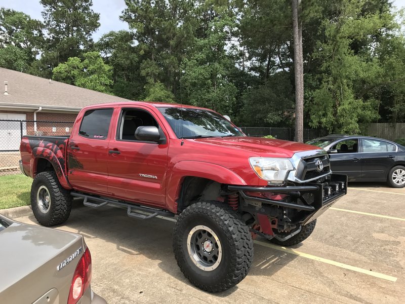

    6inch lift sitting on bilstein coilovers. Lexus is300 studs in front to keep stock wheels, general grabber red letters, nfab front bumper.
    Here you go. Stock 16 inch wheels

    same wheels as me except mine are black. who kind of height/lift ya got
    I have no idea of the back spacing. It's a fabtech 6 inch lift. And what I did is I used extended studs off a Lexus is300 and used an aluminum half inch spacer that just slides onto the studs and extended my stock wheels out far enough to clear my outer tie rods. I hate bolt on spacers. I like my solution better.

    ya I'm looking to get the space using offset and i like the lift but i don't do enough crazy offloading to warrant 6"
