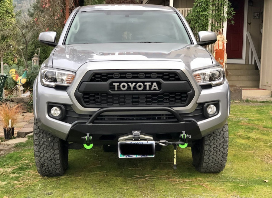

    Merlin88 $8.95 large hawaiian
    Jun 2, 2018
    #255312
    484
    Southern Oregon
    2017 Silver SR5 V6 4x4 DCSB AT
    SSO Slimline Hybrid Bumper Smittybilt X2O 10k Wireless Winch N-Fab Rock Rails w/Removable Steps Fab Fours Premium Rear Bumper RCI Engine Steel Skid RCI Transfer Case Steel Skid RCI Transmission Steel Skid RCI Crossmember Steel Skid RCI Fuel Tank Steel Skid Pop & Lock Auto Tailgate Lock Decked Short Bed Storage System ARB OME BP-51 2” Lift Kit with ARB OME BP-51 w/adj res coil overs ARB OME BP-51 w/adj res rear shock ARB OME Differential Drop Kit SPC UCA’s w/adj Ball Joints OME Dakar Heavy Duty Leaf Packs BFG AT KO2 T/A 285/70/17 tires Ultra’s Maverick 235 17x8 wheels Full Size Matched Spare Thule TracOne Ladder Rack Toyota Matte Black Grille Smoked Amber Raptor Grille Lights Matte Black Emblems Toyota Chrome Exhaust Tip-blackout Bed Rug Tailgate Mat Optima Red Top 35 Weather Tech Side Vent Shades Weather Tech Laser Fit Floor Mats CoverKing Neosupreme Seat Covers Sabellco Tailgate Lock RedLine Quick Hood Lift Elite Subaru Tweeter’s JDMCAR liners Cupeez Scratch Protectors
    I use isolators to help with the rattling. Got my Seahawk green on at present.
