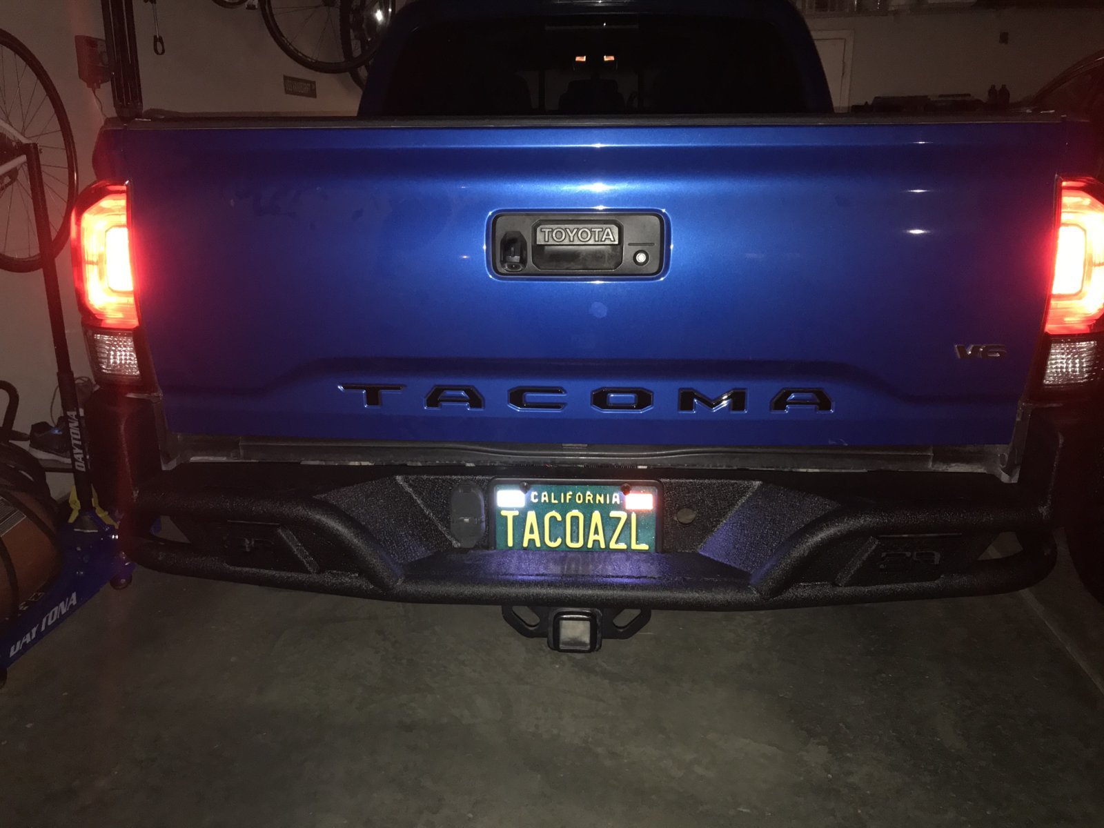

    Like I said I have this bumper. It was a breeze to install and I used license plate lights that act as screws for the plate. Yes I had to splice the wires but for me that wasn't a big deal.

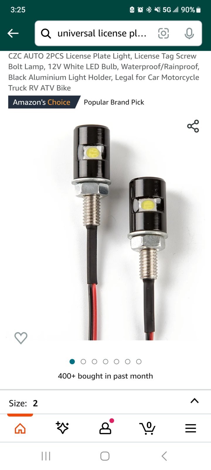

    I don't have BSM on my truck either. But everything else you said above is like reading German to me. I just don't understand it. Lol
    I'm not a complete idiot, I did install my auto tail gate lock, but it was plug and play. Totally not comfortable cutting into wires.
    How much would something like this cost?
    Was hoping to be able just use the same lights SomeTacoDude mentioned.
    Or find something that would work in this hole beside the plate.
    Thanks
    CaptainBart45 likes this.

    Those plate lights are what I use.

    I went with the intercept since these plate stud lights have small gauge wire so it made sense to marry up the L and R into a single crimp.

    I did have to splice the wire going to the license plate light to wire up the "bolt lights." I just used a lineman's splice and some shrink tubing.
