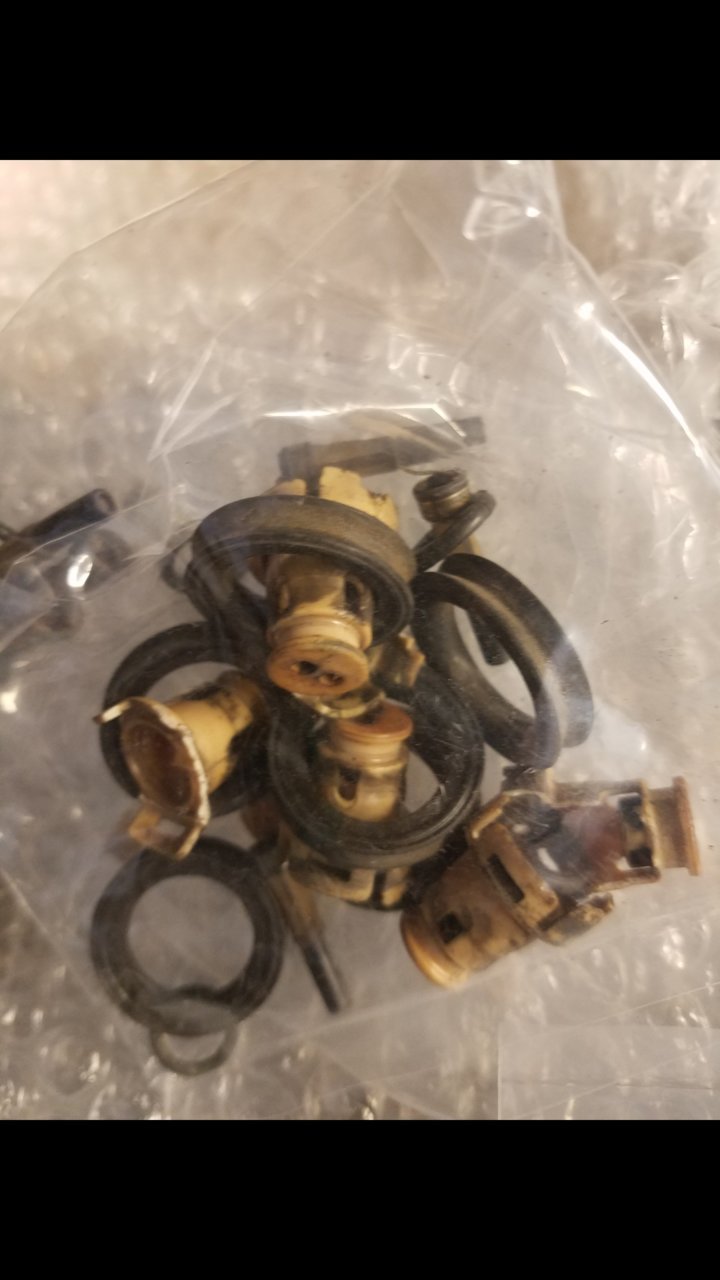

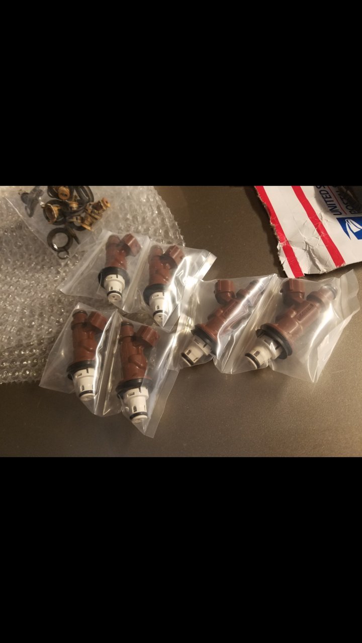

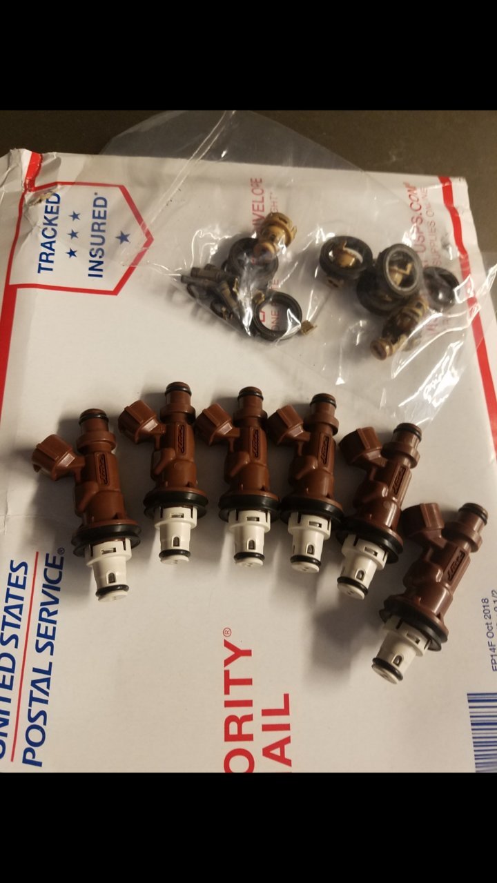

    Motor west did a great job, one week turn around for 130.00 with shipping and the old parts.
    Now just cross my fingers nothing will be leaking after it’s all back together.
    They actually were not in that bad a shape

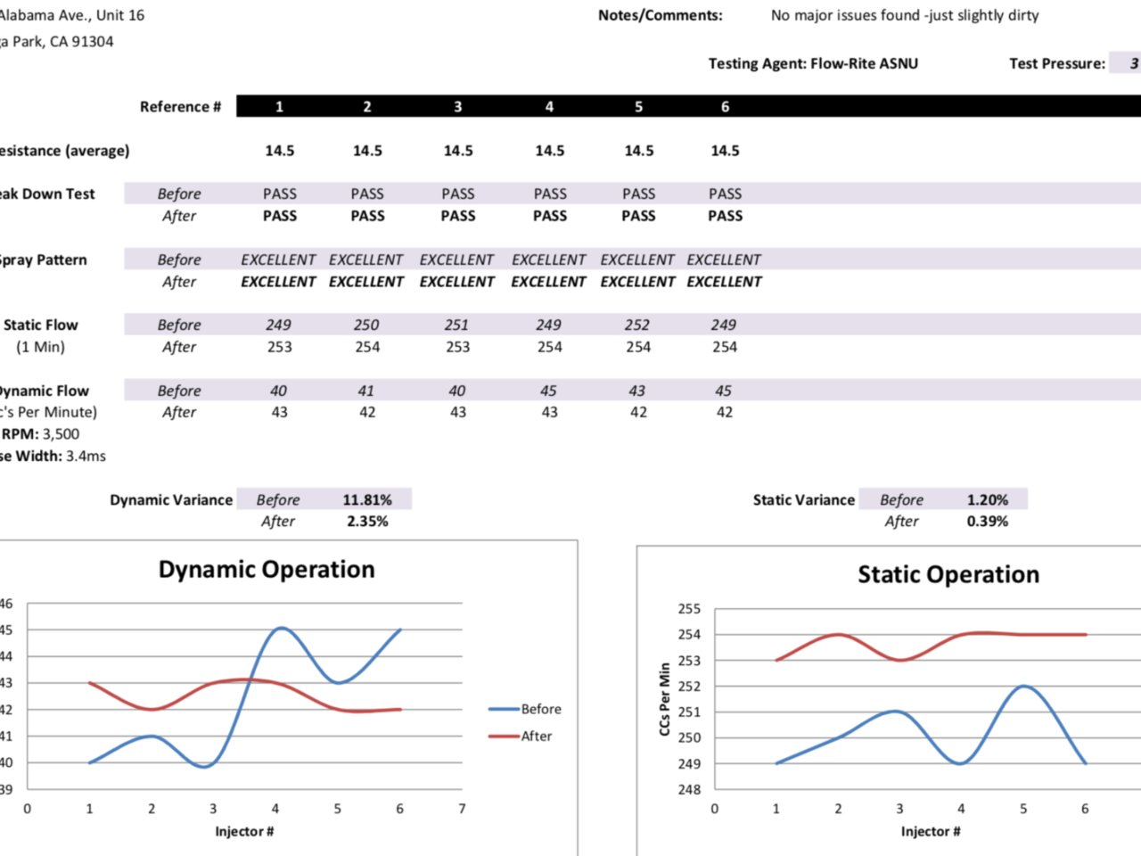

    One thing that irritates me about even a respectable company like Motorwest: they don't show any target info for the technical data. You can see the rebuild had an effect on the performance, but you still don't know if they meet factory spec, and by how much.
    I looked at 3.4L in both 1996 and 2000 FSMs( I don't have 1997). Both have exact same targets in the "Test" sections for injectors: resistance 13.8 ohms; dynamic flow 56-69 cubic cm. A company that specializes in injector rebuilds should get OEM specs and be able to tell us whether the performance meets the original design intent or not. Geez, but a target line on the graphs, tell us if the results are within the +- range as set by designer, allowable range, etc. Something to let us know we are back to within spec and by how much. I don't want to go to all that work just to put an injector back in if it is only 5% above a minimum of some sort.

    For that price and me to reuse the same coils and electrics part of the injector, I want a graph and I want data. I hear you. Check Witch Hunter. I'm pretty sure that's who the Cruiser guys used back in day
    I think I remember a company that does injector servicing that did plot and graph those specs and results. It was like 10 years ago but I think it was Witch Hunter. I think.
    CS_AR and 1997tacomav6 like this.

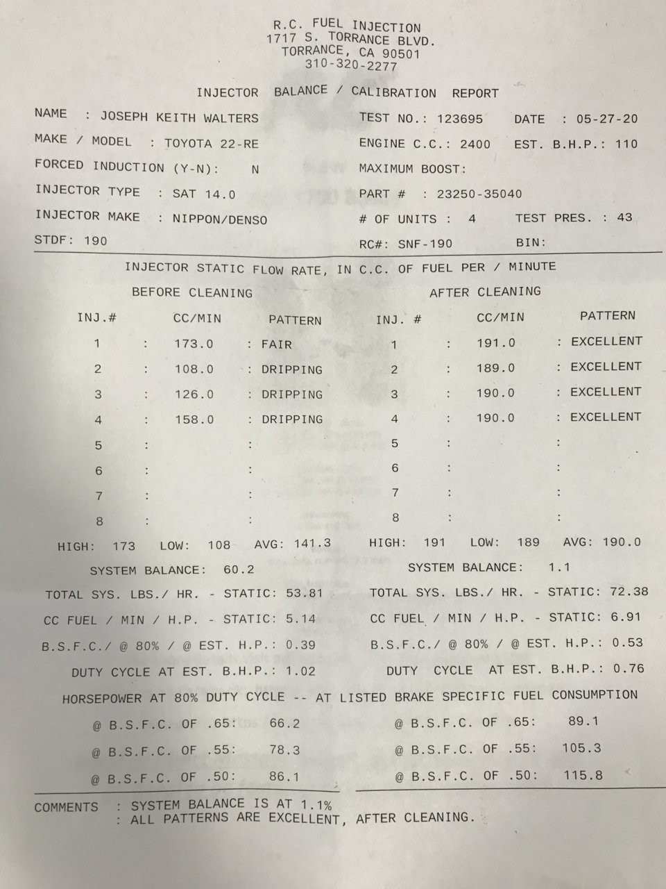

    I always have mine cleaned by RC Fuel Injection (been using those guys for over almost 20 years now) - it's about $20-25 per injector and usually a 2-3 day turnaround.

    I did send them an email about what the OEM specs were in comparison to what the final test was.
    They responded that the test after the cleaning was exactly same as the OEM numbers.

    For comparison; this is the report I get from RC:

    Now you're talking my lingo:cool:
    Good to have options man, the more options the better for us :D

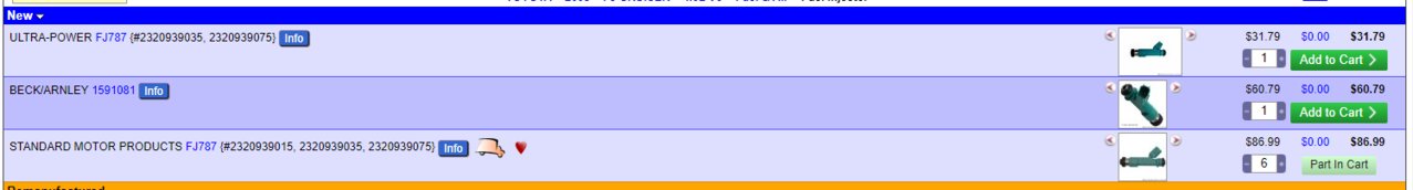

    Any thoughts on Ultra Power FJ787 versus Standard Motor Products (intermotor?) FJ787? Are they the same thing? This is for a 1GRFE 4.0 application.

    I've seen cases where Ultra Power or (budget brand) would use a picture of a well-known part like 555 ball joints. Then when you get the product it turns out to be something different. The part numbers being the same may indicate its the same product. Maybe it is the same product with an older lot date and needs to be rotated off the shelf. Something like an expiration date on some items at the grocery store. I recall a discussion on another forum where injectors do have a shelf life. It may be the preservative that is used to keep the injector blades fresh.
    It looks like all three products are the same injector. Beck has been known to be the same as SMP but without o-rings that need to be purchased separately. That never made sense to have two products from the same company.
    Roughly 11 years ago, SMP built injectors that were some of the best that money could buy from being flow matched-- and they were expensive. A club that I know got a set and sent them off to Deatschwerks in OKC for testing to prove a point. it turned out the flow was exceptionally close.
    My only reservation would be that if you get the product and it turns out that you don't like it, then returning it to Rock is not as easy as say Amazon where you get a full refund.
    In a few months, I would like to buy 8 new injectors for a 2UZFE. So at $80+ dollars a pop, that will turn close to $700 with tax and shipping.
    You might get lucky and find the Ultras are the original Densos that have been on the shelf for a while. If you have the time and $$ to deal with a return if you are not happy, it might be worth a try.
