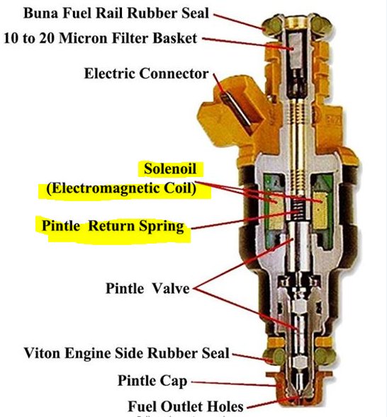

    I'm all about learning how MotorWest cracks open a plastic injector body to remanufacture the solenoid, coil, pintle return spring, and valves.
    They can clean the internals, replace the screens, pintle caps. and o-rings. I would like to know more about the remanufacturing process when it comes to internals and the plastic body.

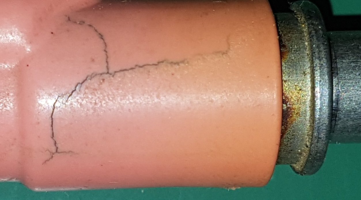

    Also, the plastic body part will crack over time.

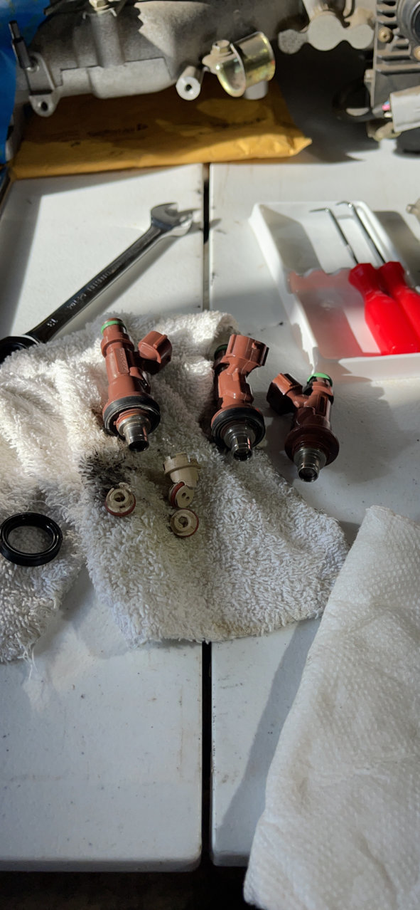

    F29C6F07-7936-4C44-88B2-486C143D00A8.jpg It’s embarrassing to admit but I was scammed twice recently on injectors
    do not buy from:
    Anira motors out of California
    -shipping took 4 weeks from California to Washington, probably because they ordered counterfeits to ship to me and had to wait for the garbage to show up
    -claimed denso refurbished, but no test codes on the casing.
    uxcell out of china(picture above)
    -claimed new OEM
    -leaked almost immediately out of the casing
    -bottom section broke off in the lower intake manifold when I tried to remove them. Luckily I was able to fish them out without dropping plastic in the head.
    I ended up going with motorwest:
    Denso Fuel Injector Upgrade Set for 3.4L V6 4Runner Tacoma and Tundra – HP831
    delivery is this Wednesday, I’ll update after installing76CB69B7-F302-4BDD-8456-55C297E80A3F.jpg
    Black DOG Lila likes this.
