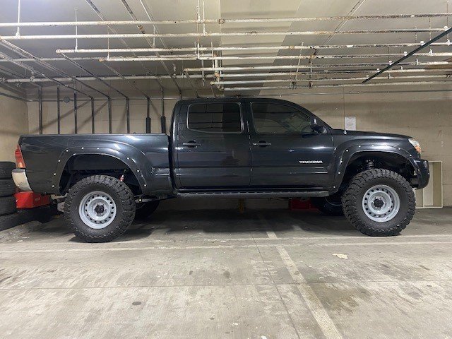

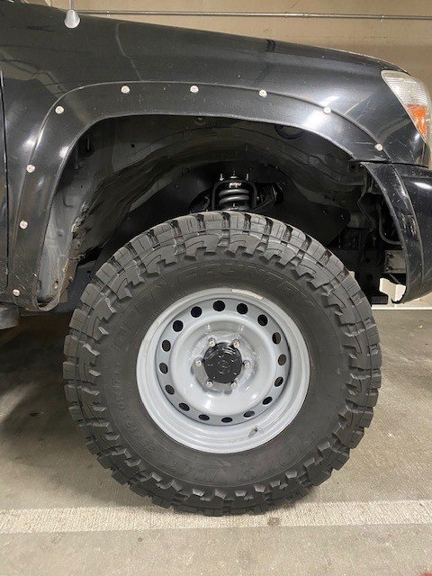

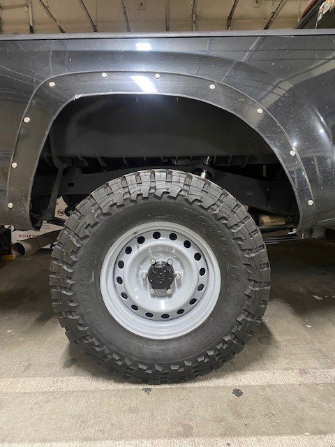

    I am having Eibach Pro-Truck Coilover Stage 2 currently installed on my Tacoma. I should be getting the truck back any day now. I'll update you on the ride quality. I will be running 35s with them too.

    I've driven the truck on the Eibach Stage 2 Pro Truck suspension close to a month now. I've spoken to accutune and eibach on the stiffness and both say the springs would need to be changed out for something softer or add weight. I am currently waiting to pick up my C4 bumper from powdercoating. I will report back once I have that on and have driven it for a while.
    At slow speeds, it does ride stiff when cruising around the neighborhood but it handles dips and the smooths out at highway speeds.
