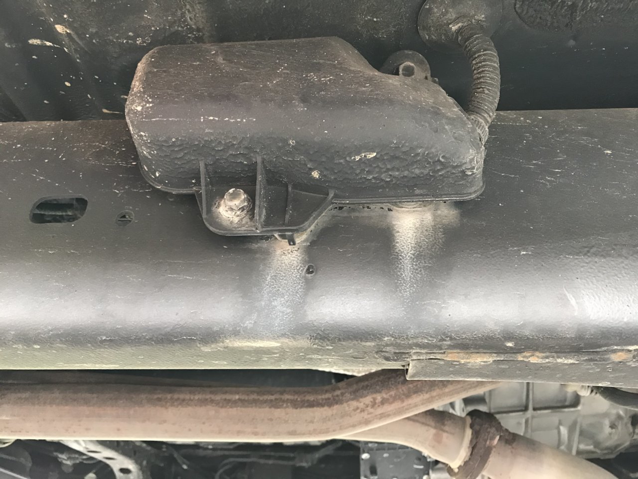

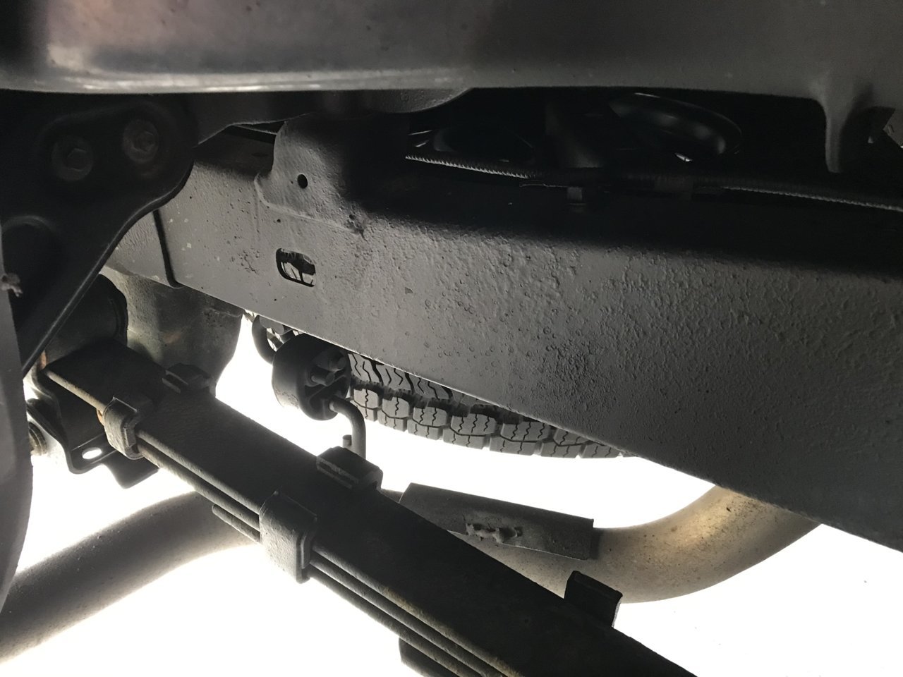

    Redline870
    Redline870 Well-Known Member
    Oct 8, 2018
    #268773
    711
    2018 Cement Tacoma TRD Off-Road

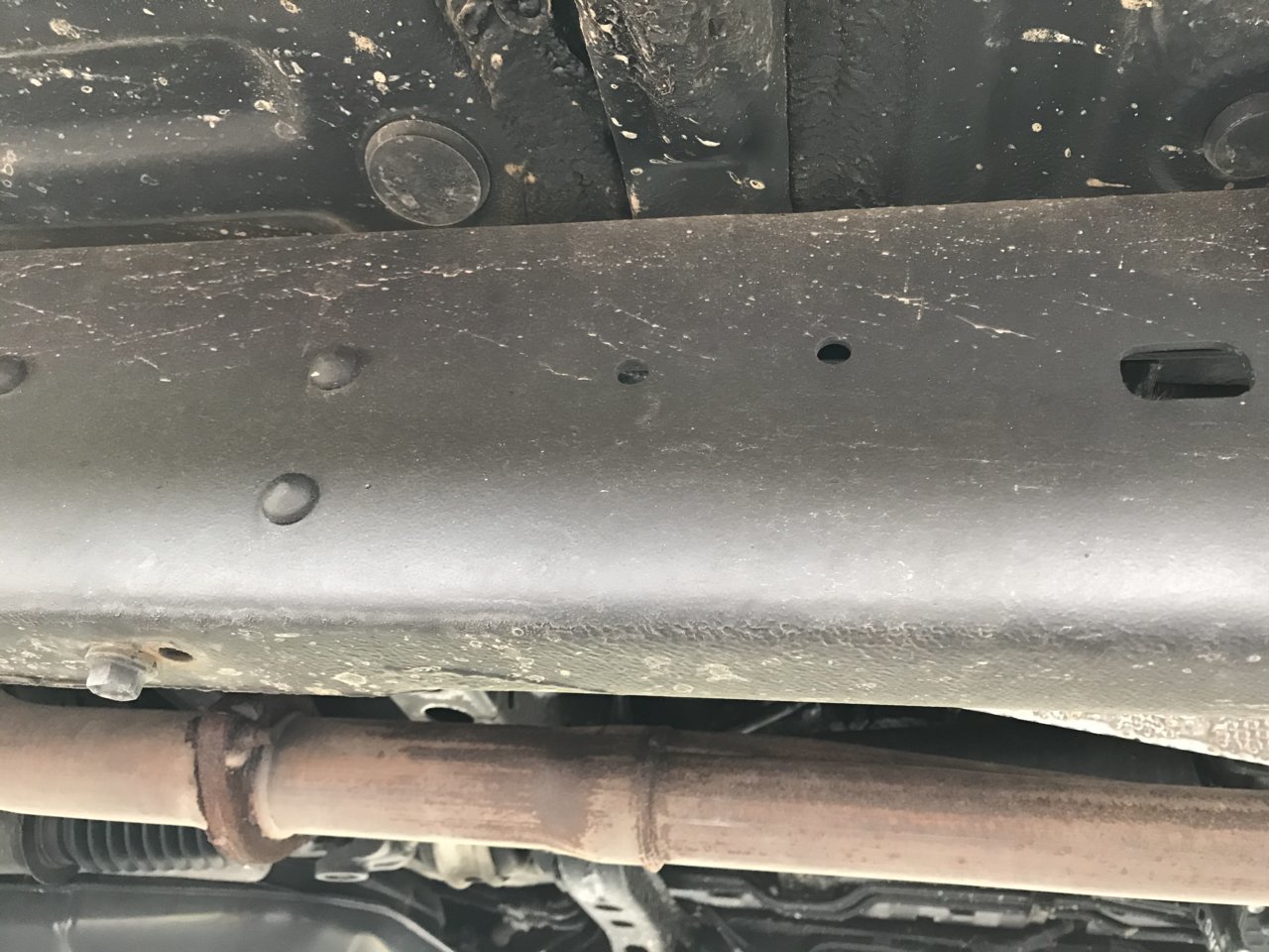

    @mullett757 as you can see, the hard rubberized undercoating on my frame is not the same stuff that’s in that YouTube video. There is some very light surface rust around some of the welds which just comes with the territory of upstate NY and salt. There’s no way to 100% eliminate it. The floor boards fuels lines and brake lines are 100% rust free.
    the stuff used under the hood is clear, it’s almost like a sticky wax substance that they spray around the whole front clip and along the inside of the engine bay. They also drill holes in the doors and quarter panels and insert a wand that’s used to spray the same solution, it prevents it from rusting from the inside out. They then use small little plastic plugs to plug the holes, looks factory when it’s done.
    This is only 2 winters but I’ve been under trucks that have been through 2 winters In the same area and not had any undercoating and I can tell you with 100% certainty that they have more surface rust than mine.

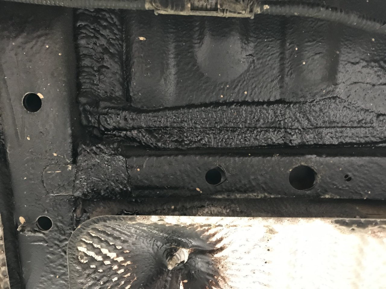

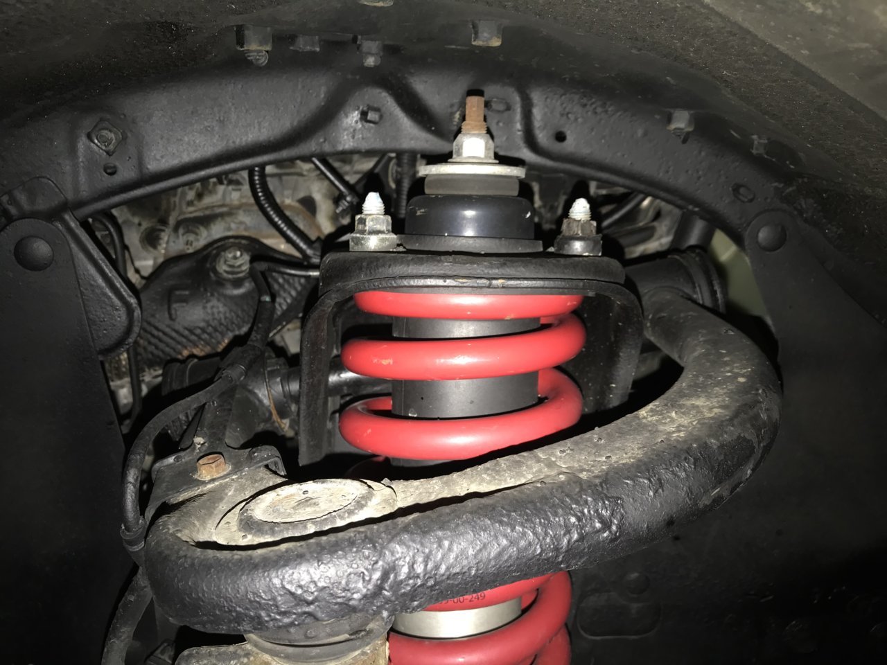

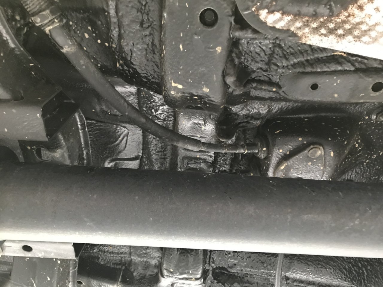

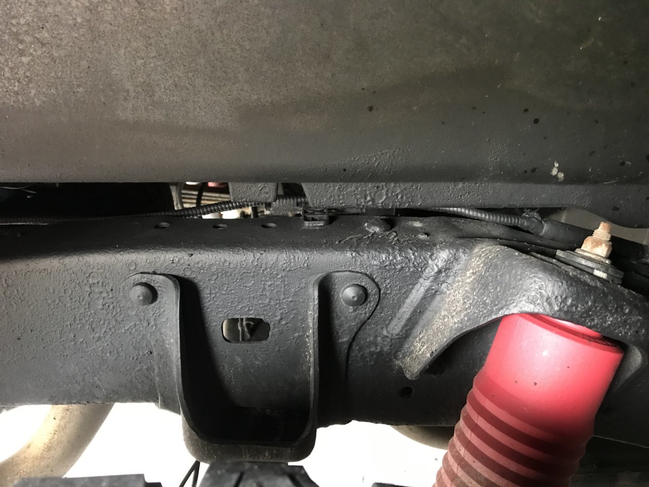

    Redline870
    Oct 8, 2018
    #268773
    711

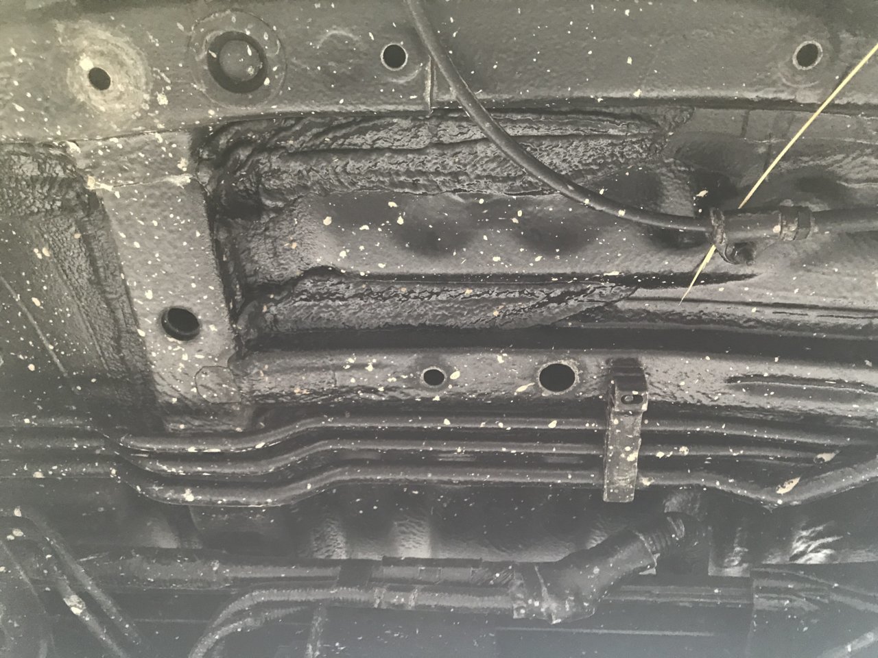

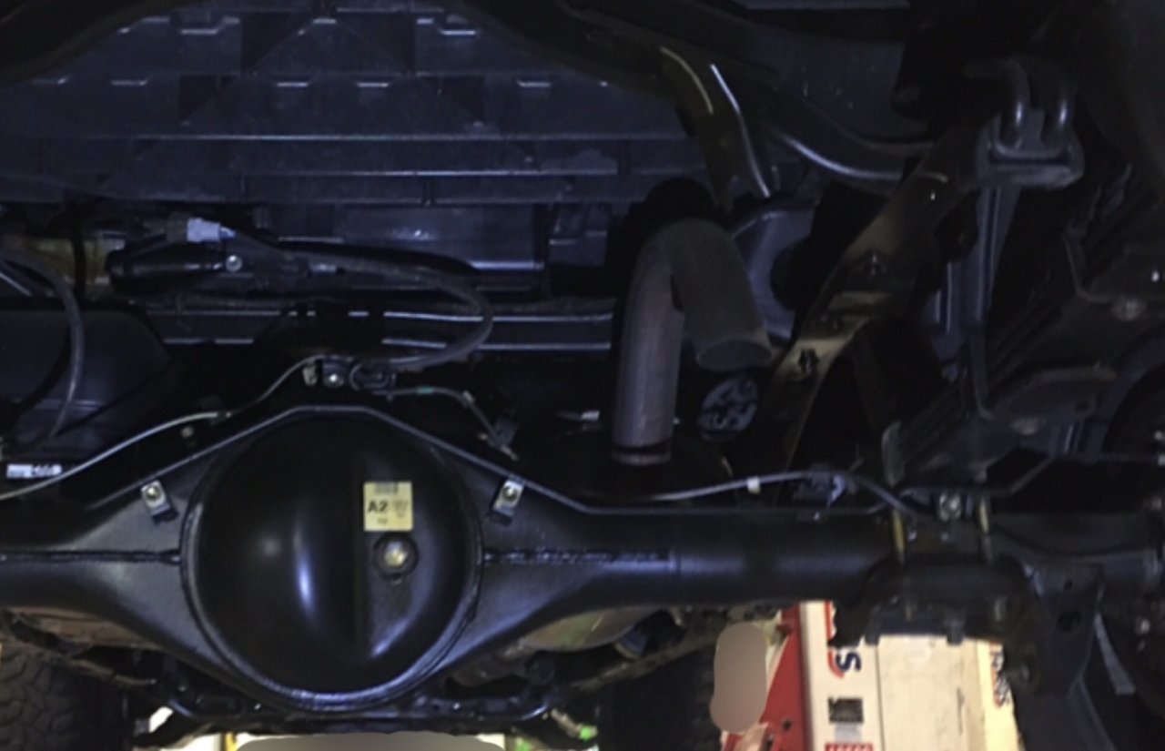

    @mullett757 heres a couple more pictures of the frame and UCA’s showing the hard rubberized undercoating. Like JayTRD88 said, washing is still needed, I was at least twice a week in the winter at a nice drive through place. If you do the undercoating when the truck is new, it’s the best way to prevent the rust. Waiting even a few months will introduce moisture and surface rust that will just be sealed in if sprayed over the top. That’s clearly what the owner did in that YouTube video.

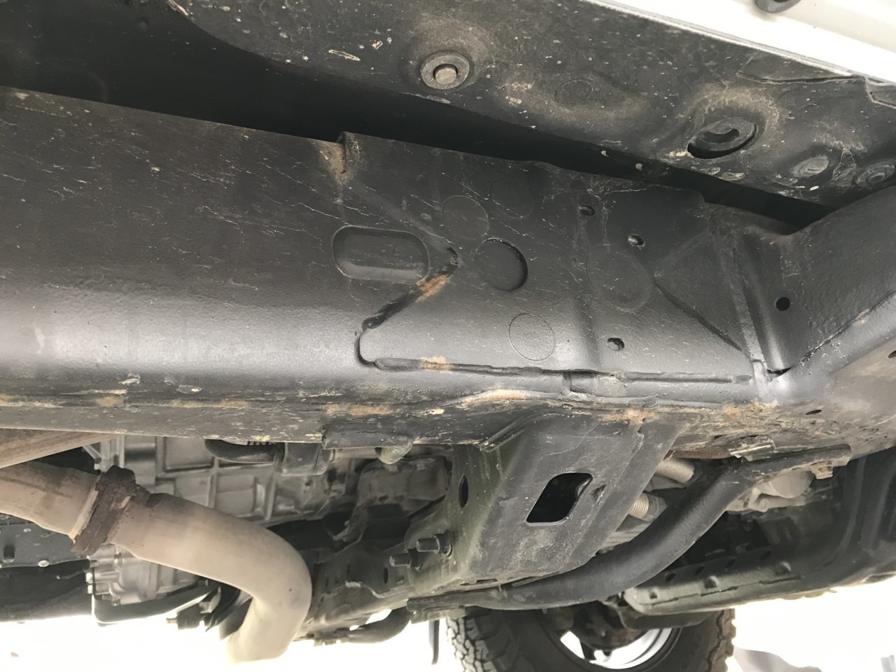

    My advice is to not use a hard undercoating. It will inevitably crack and let in moisture, and hold it there, and components/frames rot out even worse because they never dry. Use a wax type undercoating that self heals, like mavcoat. You’ll have to apply once (or twice) a year, but 1) it’s not a slippery build up of gunk, so when you get under your truck to work on it, it’s clean, dry, and not slimy or sticky 2) it doesn’t smell like a goat 3) you can weld through it, it doesn’t contaminate welds/needs no de-con
    I don’t have any pics on my phone, but I’ll gladly go out to the garage yard and take pics of hardcoated undercarriages to show the damage that occurs.
    this is my truck after 4 northeastern salty winters and a can of mavcoat. EBE375DE-B6BC-49F1-8E4A-115605DECB1C.jpg
