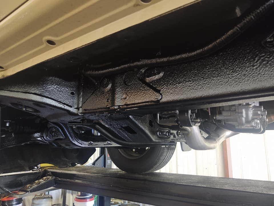

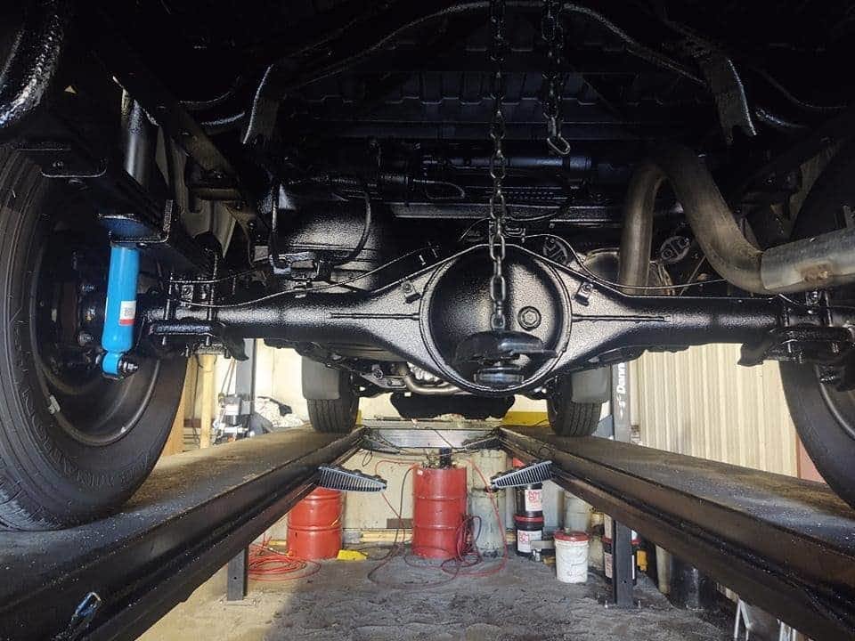

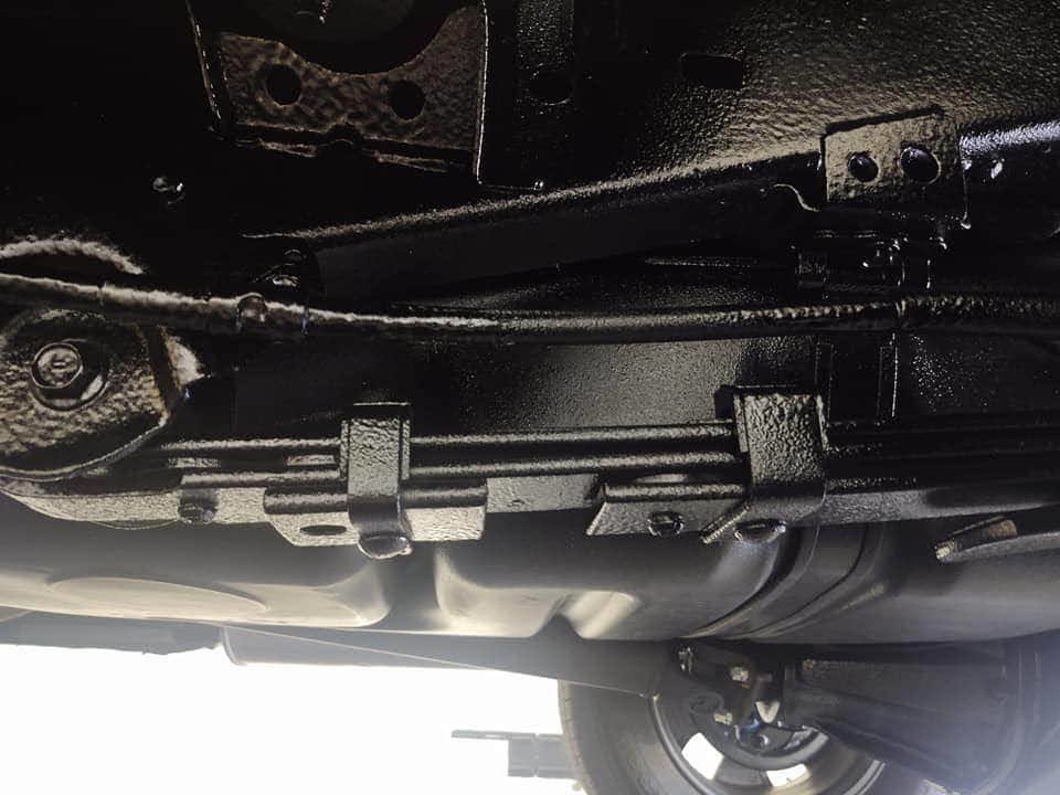

    Do you know this from your vast experience working on vehicles in the rust belt? Or are you forming these opinions from a YouTube video?
  9. Jul 31, 2020 at 4:37 AM
    #49
    Redline870
    Redline870 Well-Known Member
    Oct 8, 2018
    #268773
    711
    2018 Cement Tacoma TRD Off-Road
    Yes you’re right. The worst stuff you can get and I’m trying to justify it to myself. Nice try. I’m just sick of fairy tells that are pushed by people with zero experience on the matter. Perfect example of this is the thread on locking gas caps. People saying there’s screens in the filler necks to prevent people from siphoning fuel, another guy saying if you put a beer cap in someone’s tank it will get sucked up into the fuel lines and cause a vehicle to not run. These people literally have never even taken a gas tank out of a vehicle and are talking out their asses. They’re not subject matter experts, they’re subject matter enthusiasts.
    I posted pictures of my own vehicle with the stuff applied, can you point out the cracks in the coating and the rust developing underneath please? You can’t, because the only rust is on the bare metal parts that weren’t coated. I’m forming my opinions from the thousands of vehicles I’ve serviced in the rust belt and seeing through my years of experience what works and what doesn’t. I’m not forming my opinion from a YouTube video that clearly is trying to mislead people. I agree, fluid film works great. It’s also something you have to apply yourself every year. I bring my truck in once a year and they touch up any areas that need it, which generally is very little. I’m replacing my leaf spring in a few weeks. If anything, a flexible spring should support these fairy tales, right? Lots of flexing, cracking, moisture trapping, and rust, right? I’m going to scrape the undercoating off the old ones so keep an eye out for that post.
