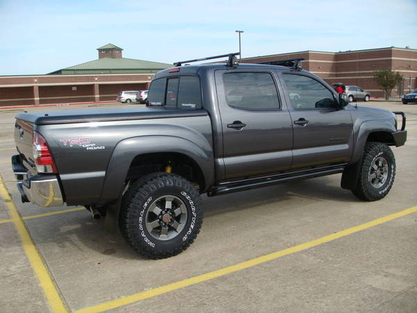

    i'm running goodyear dura trac 285/75/16. it looks really sweet on a 3inch lift. but i don't think is very realistic for a daily driver. unless you use them offroad a lot. that would be your preference. i'm switching my out for 265's, c range. there's a couple of reasons for that.
    1- i definetely feel a power loss on it
    2- mpg went down about 3.5 mpg
    3- i do feel the harsh ride.
    i think 265/75/16 will do just fine for what i need it to do.

    Are those the 265/75/16 on your truck? those look pretty good, i dont wheel my truck as much as i would like to but i do get out every now and then
