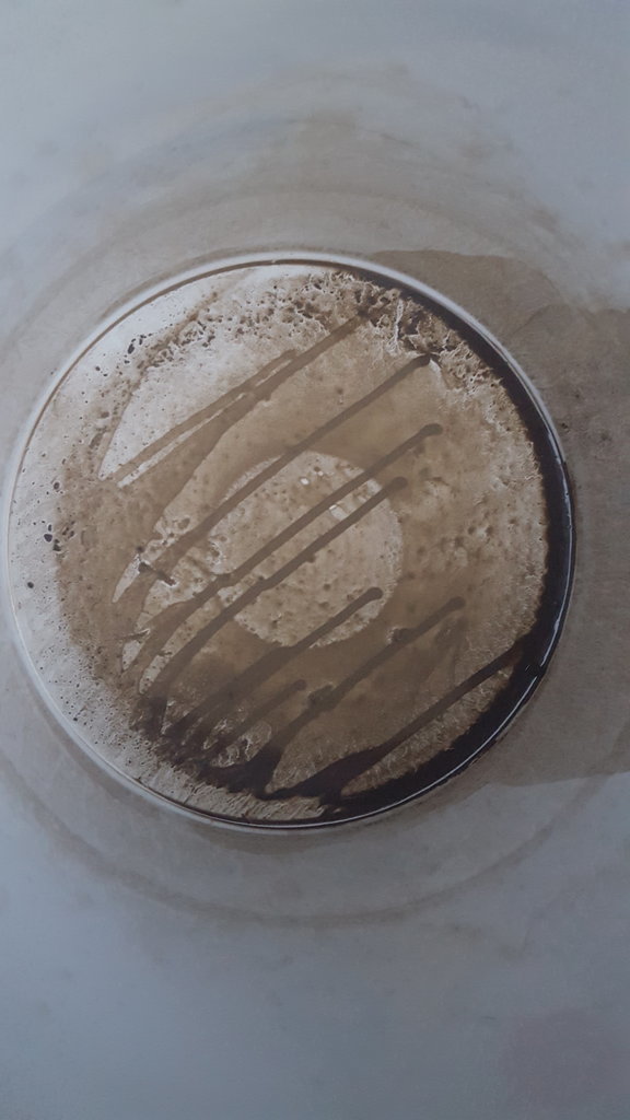

    Straight out of a fuel filter with ~140+k. '97 2RZ Tacoma. All around better acceleration once changed.
