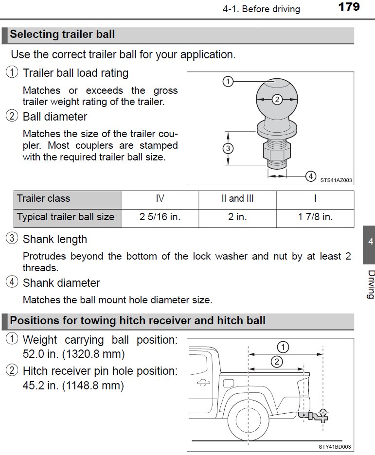

    I thought the factory hitch was only a class 3 though so would that change from your earlier mention on 640 to 500?

    I believe we are Class IV. This is the only reference that I can find in the manual and nothing on the sticker. A 10% tongue weight would jive with Class IV for the trailer max weight of 6,000lb to 6,800lb.

    I think that’s what I remember seeing and in the table under 2 and 3 it has typical 2” ball Which is what I have as a standardization- that could be what lead to my confusion so I hope your right

    I found Class IV noted in the attachment. Check out Page 28.
    No class description in the main product info other than straight up numbers.

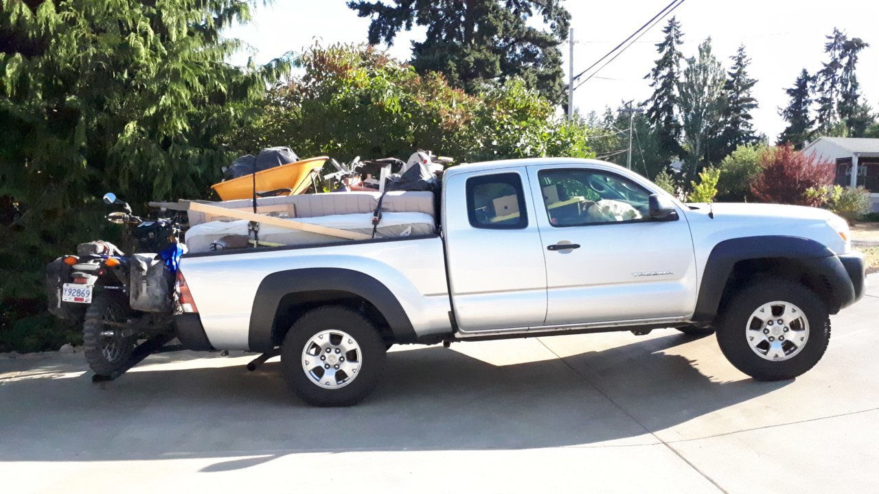

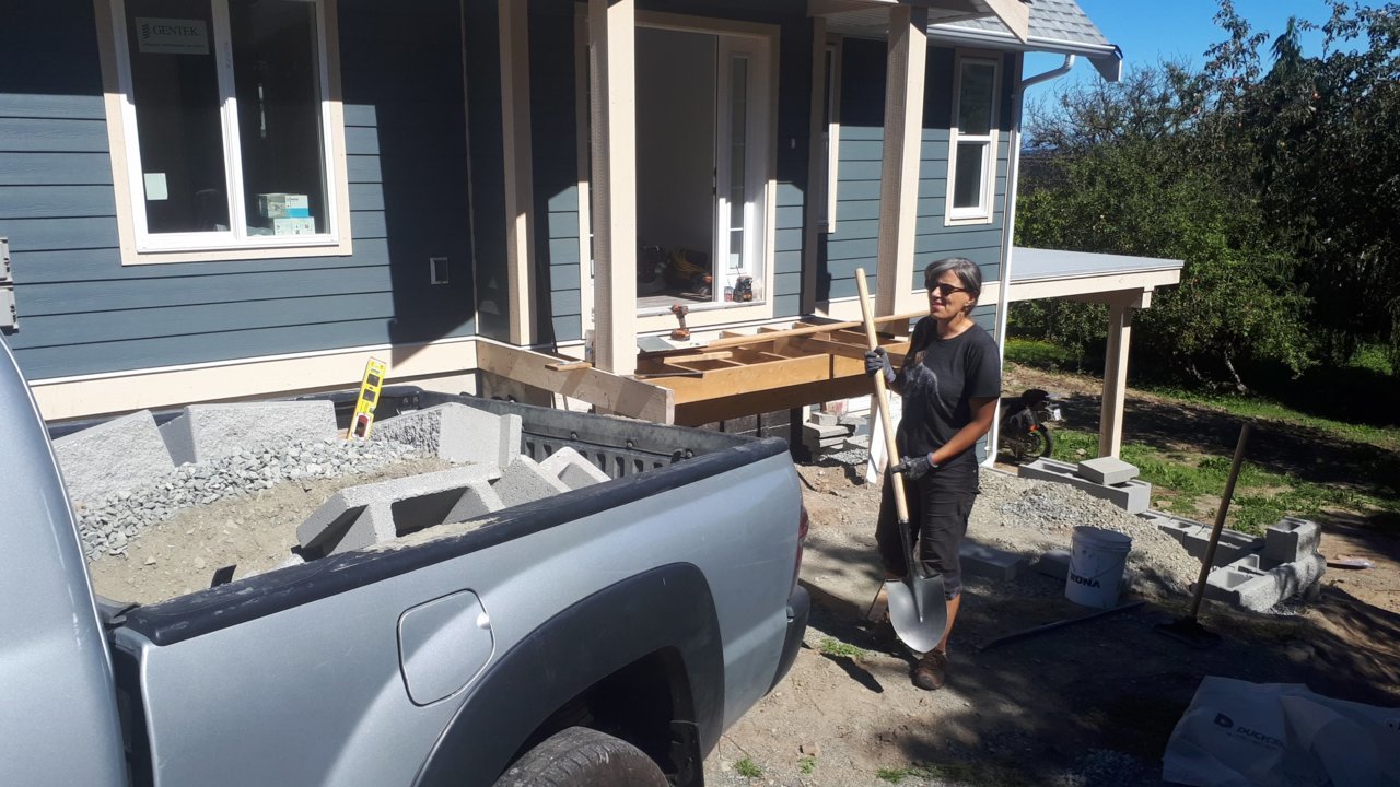

    I have airbag suspension. With 5 psi in the bags, there is sway, it is not overly dangerous, but evident. At about 30psi I do not notice any sway or sag. Feels safer at 30psi.
    I have the airbags because I was often hauling loads of navvy jack and 3/4" crush, as well as Allen Blocks, or loading all my tools into the bed of the truck when I built my house. I would probably buy them anyway, just to use the hitch carrier. I tend to put them on all my trucks, as the ride quality when at load is so much better, and the truck feels much safer to drive.

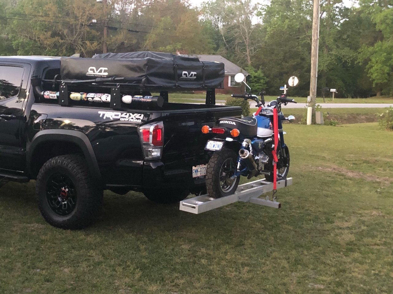

    Update- Have since bought my choice of carrier (mototote m3) and it’s held up great. I find myself looking out the back more often to make sure it’s even still there (included anti wobble bolt plus liberrway hitch tightener). And no squat! Granted it’s only a grom coming in a 225 but no lift/stock leafs w/ hs progressive 3leaf aal and sumo springs progressive bump stops.

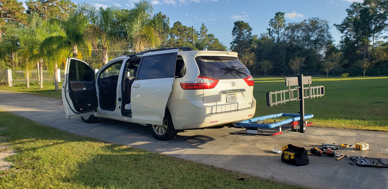

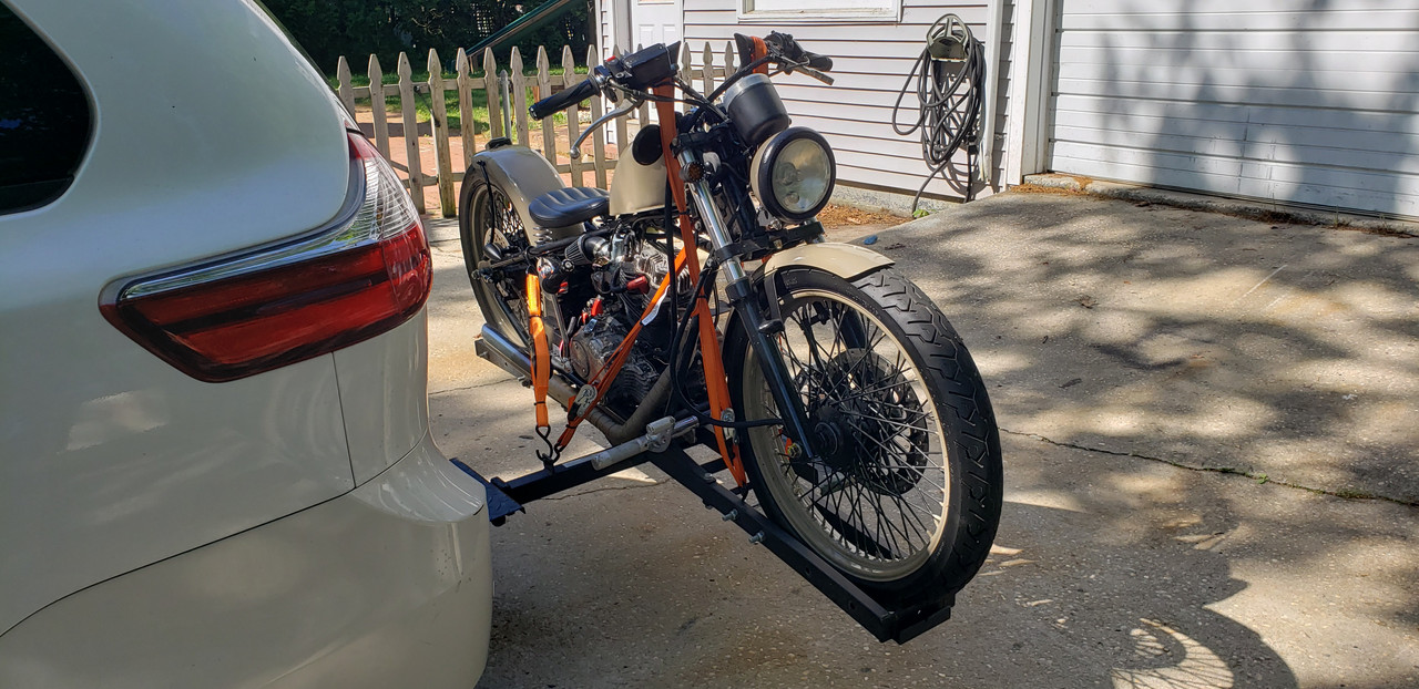

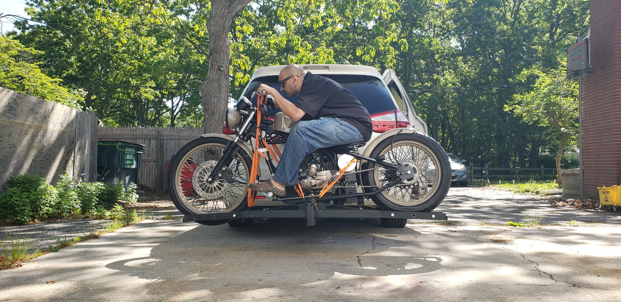

    Earlier this year, I picked up this dirt cheap bike project and the seller gave me a brand new hitch carrier just to haul it away
    After a little tinkering and some paint, I had no issues hauling it 1200 miles down to our house in Orlando
    [​IMG] [​IMG] [​IMG] [​IMG] [​IMG] [​IMG]
    Easy loading on my van, but the receiver on my 80 series is like a foot higher, so I have to back it onto a steep incline to load anything.
