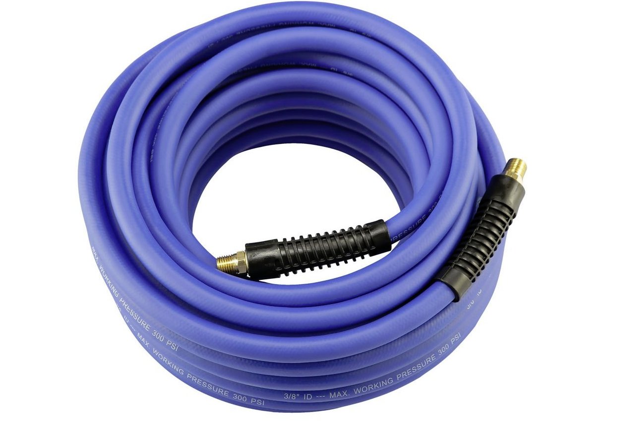

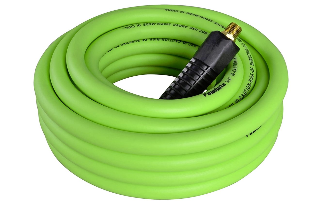

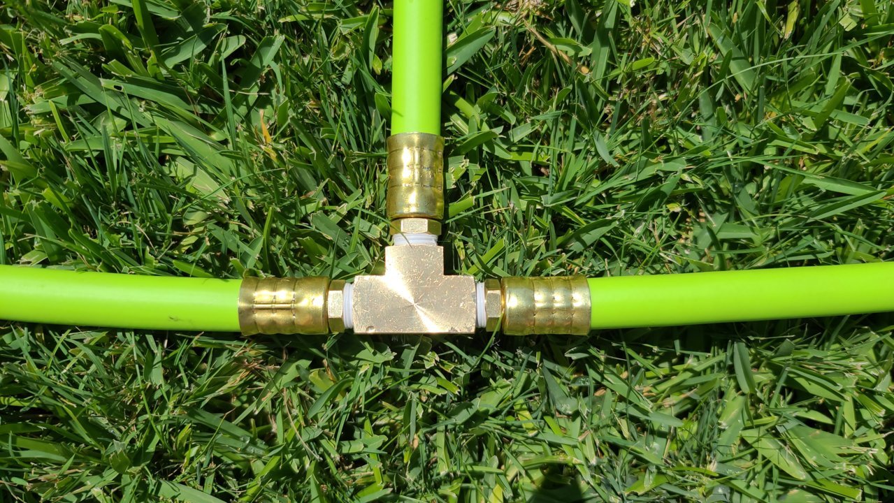

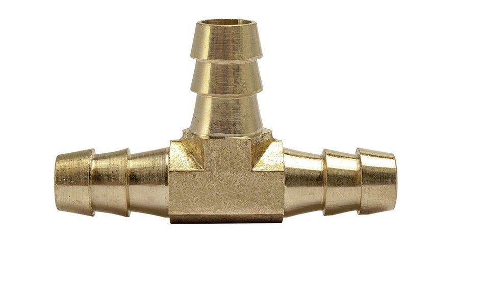

    The QuickAir uses 3/8 flexible hybrid hose and all connections are ferruled together to barbed fittings.

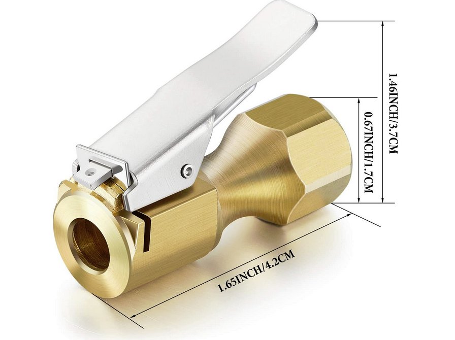

    This means replacing a broken hose requires cutting and re ferruling (or using a hose clamp). The air chucks are a different style as well. I have been using these air chucks with no problems but I have noticed they like to get caught on more things.

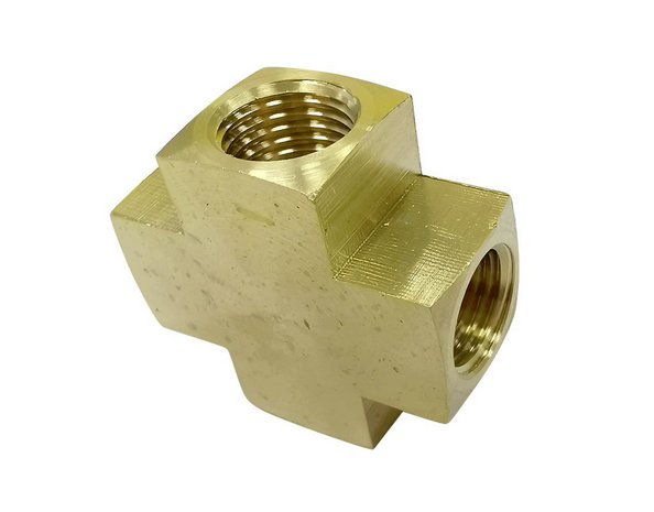

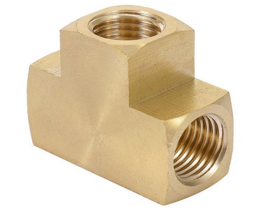

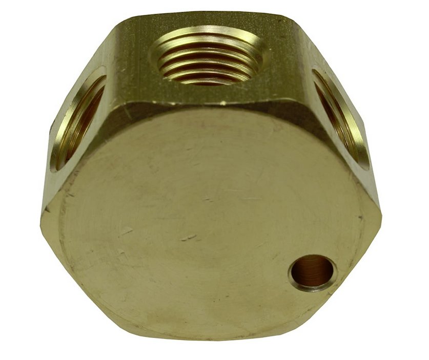

    Finally the 4 way fitting on the bottom is a cross and not the cool hexagon.
    Building with these materials is cheaper in cost but not quality and I can sell these for $100 a peice.

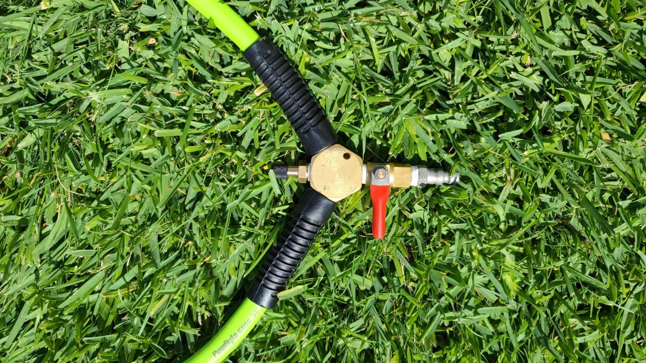

    QuickAir Pro:

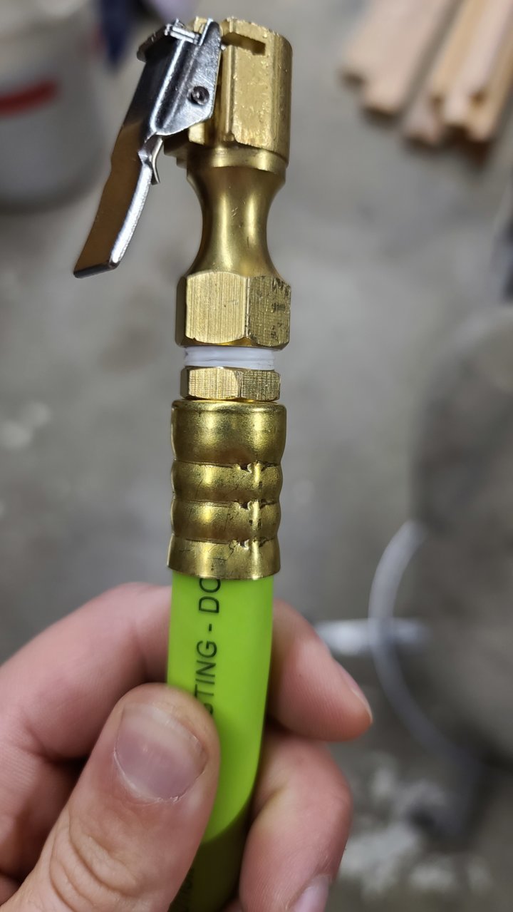

    Now on the the Pro model. The only parts shared between the 2 are the hoses and valves. Each fitting on the pro one can be unscrewed for easy hose replacements. The Tee fittings are very nicely machined and are way stronger then the round ones. They also have 3 female fittings meaning standard male hose can be screwed on to all ends (no need for special female ends)
    The 4 way fitting is a cool hexagon which looks better and is a much larger chunk of brass.
    The air chucks are the nicer Haltec ones you see on the MORRFlate.
    The pro model can be sold for $150, which I think is a very good deal.
    Product Images:

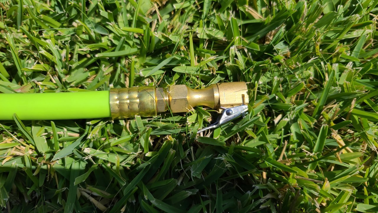

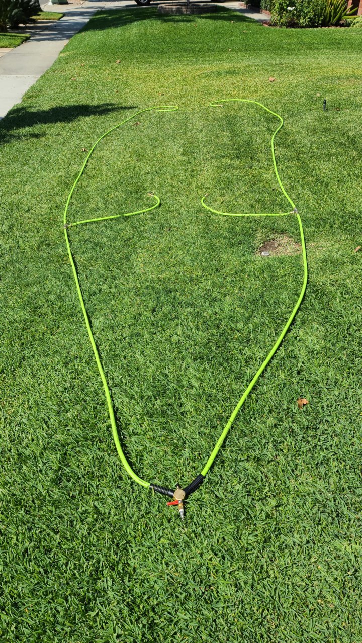

    Here are some images of one i just made my father (he got a custom one with pro fittings, normal air chucks, and lime green hose):

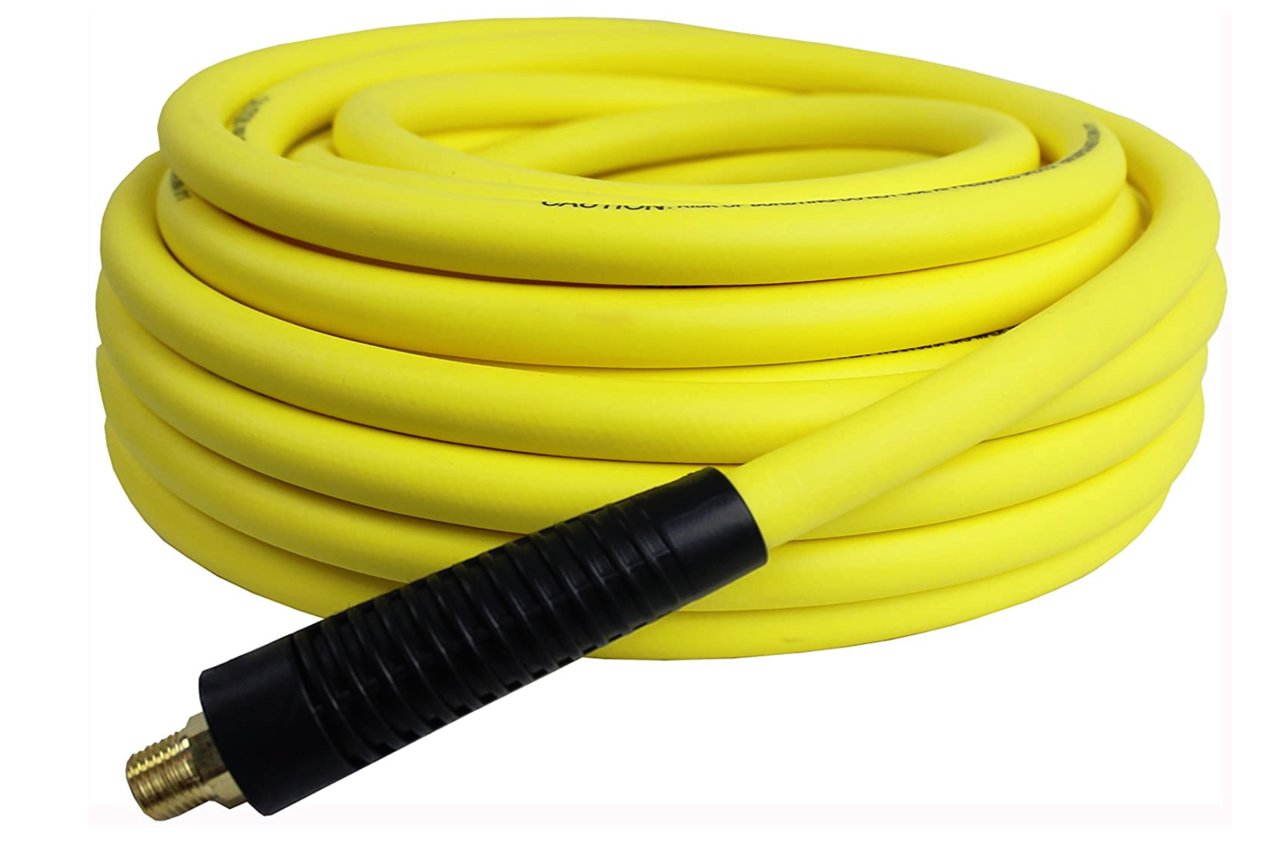

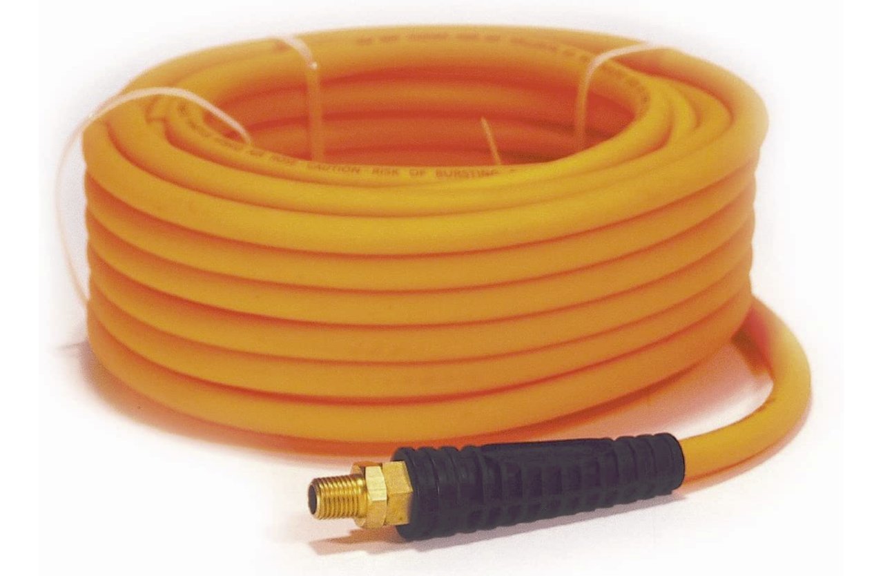

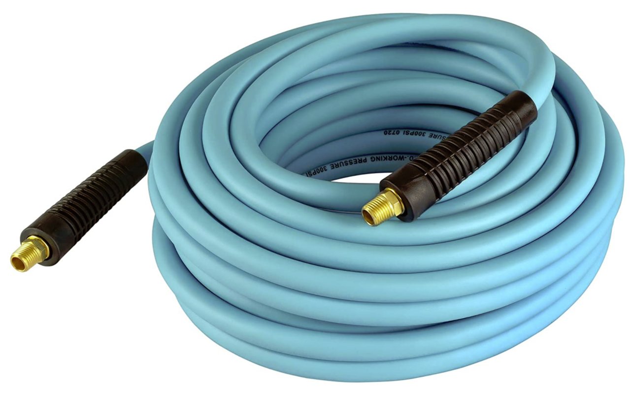

    Each one comes with the hose color of your choice:
    blue:
    turquoise:
    orange:
    lime green:
    yellow:

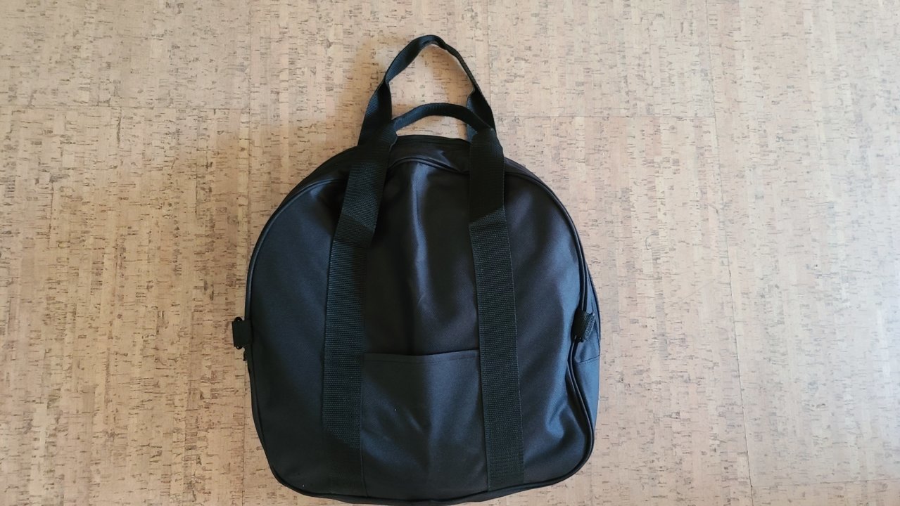

    They all offer a handy bag to tuck it away in too.

    What tools do you need besides some basic hand tools? The only thing I can think of is a crimper for the brass collars and personally I'd just run barbed fittings and hose clamps. I apologise if I come off like I'm arguing or something, just honestly curious and want to have a conversation.

    Yeah a crimper is the only special tool you would need. I didn't want hose clamps because when rolling the hose it can be easy to cut your hand or get them caught on things. They sell cheap crimpers but they are garbage. The Vice-Grip style don't work well at all so you'll definitely need to buy the next step up which is about $100.
    As for cost, I spend about $123 on each pro one. However that's pricing parts out after buying them in bulk. Buying the exact amount of components online would cost about $180. Buying them in bulk packages cost about $190 but when I build the next one I don't need to purchase some parts, if that makes sens. And the ferrules are super cheap compare to hose clamps. I spend about $0.10 per ferrule where a hose clamp would be a lot more.
