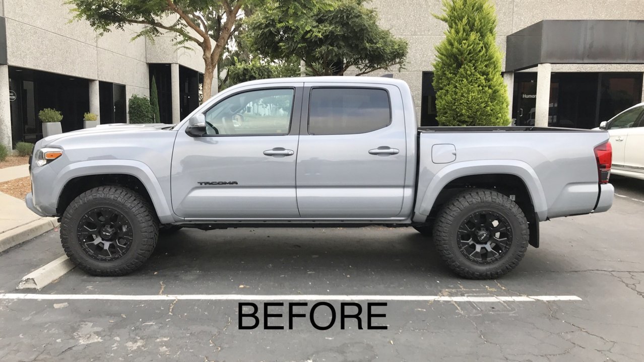

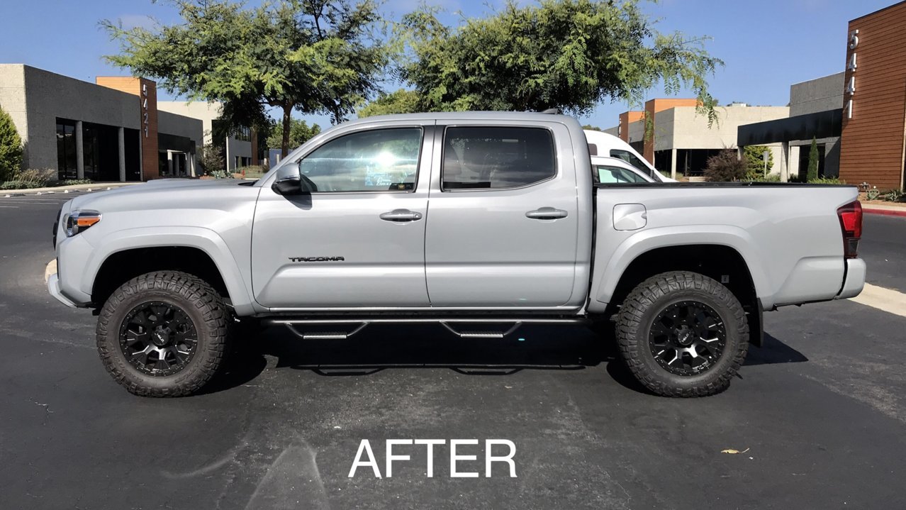

  11. Aug 31, 2019 at 4:38 PM
    #91
    fcowell
    fcowell [OP] Active Member
    Feb 9, 2019
    #282433
    33
    Frank
    2019 Cement Tacoma TRD Sport
    FINAL UPDATE: Attached are before and after photos. Went with the kit posted in the original post from ORW, price matched down to $550-ish.
    Short story: 5100s all the way around with Icon AAL in the rear. Front left has the 1/4” “Taco Lean” spacer. Front 5100s are set on the “4th notch” inside stock coils.
    The ride is really comfortable!
    This slight increase in height did alleviate the minor rub issue I had, which sparked the whole desire for the lift.
    Thanks for everyone’s input!
