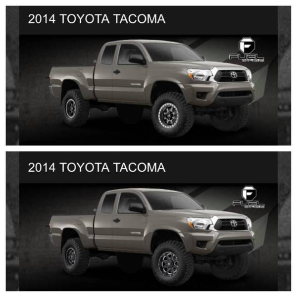

    Whats your guys thoughts on the rough country 3 inch lift? anyone have it installed? Pics?
    Also thinking about switching rims and tires going with KM2s with one of these sets of rims..
    Opinions on top or bottom

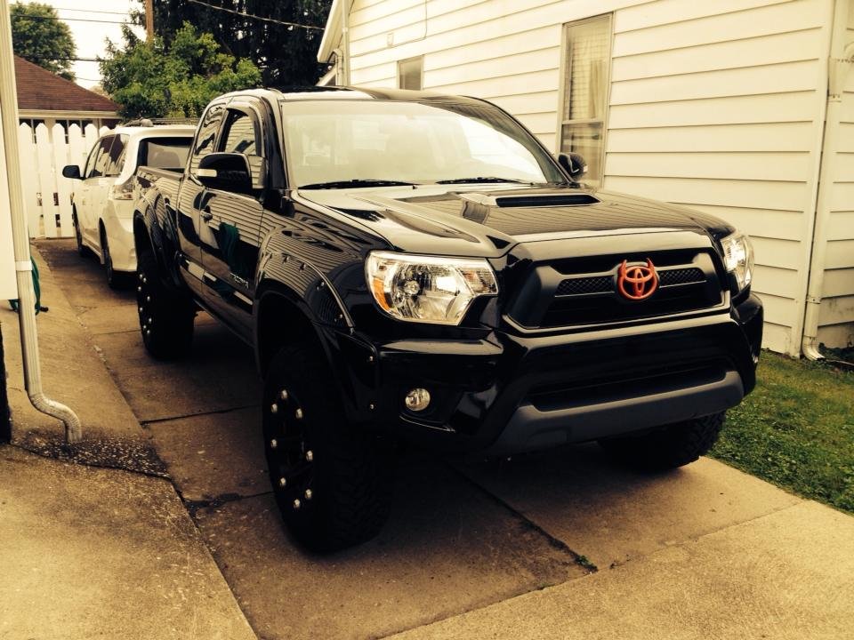

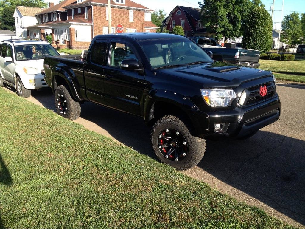

    Here is what I ended up with, no rubbing. It will fit 285's with 0 offset for sure, but it will definitely rub off road. Hope this helps.
    Rough Country 3 inch
    17x9 Ballistic Jester 0 offset
    265/70r17 Cooper Discoverer STT's
    Also, pics.
    10620395_838730009479622_638274268177942_b4340e5719c948779f686d055e292bd989e26c4b.jpg
    10628013_840706882615268_526084488084570_02231267b07f3f7c0150ffad1b85410e32329bf2.jpg
