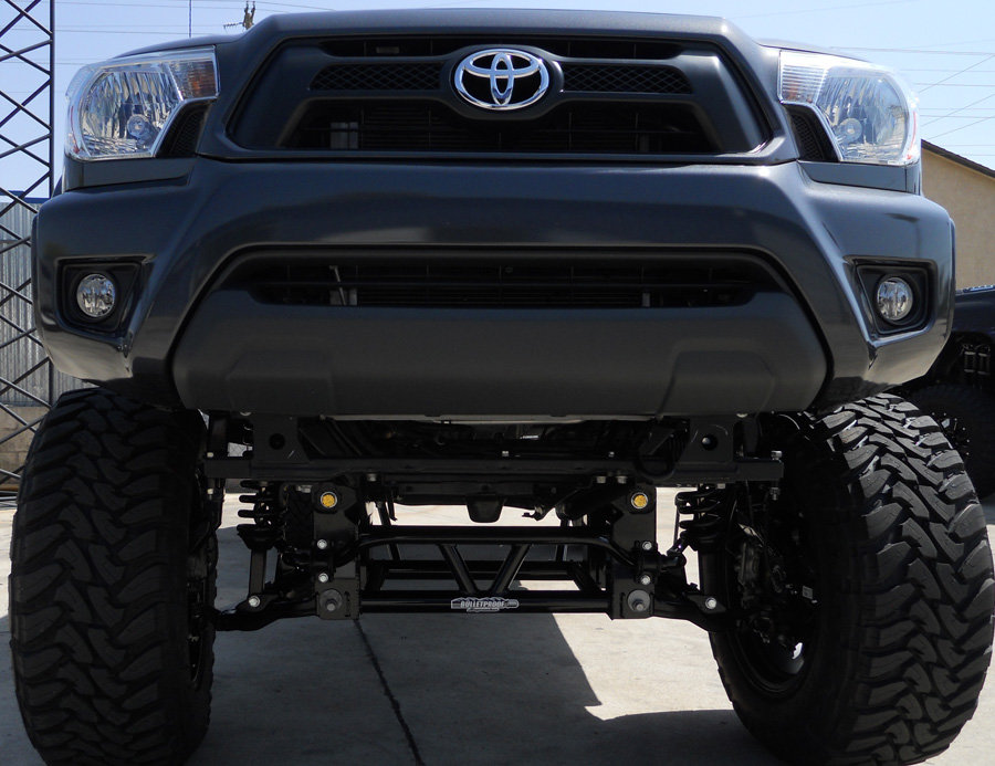

    2wd-Tacoma-003-web.jpg This is an extreme 6 +inch lift.

    Post a picture of the front cross member

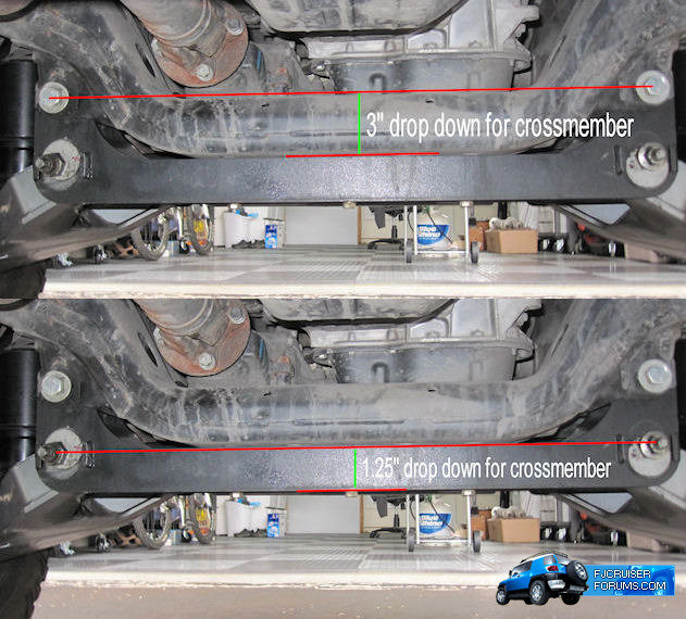

    NO NO NO!!! Bad choise, just spacers and crappy shocks. You have now a good platform to update it. Just get rid of the spacers or shorten the fronts and install some better shocks or even decent coilovers to front. Bilstein makes longer 5100´s too. You could maintain a factory like geometry with 3" lift.
    This is from FJ´s RC 6" lift, your crossmember is cut, but the dimensions are the same I think: https://s3.amazonaws.com/roughcountry/install/92174700.pdf
