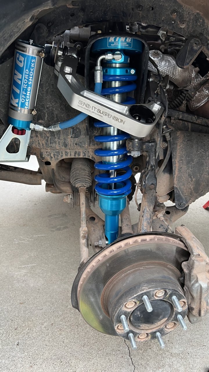

    Anyone given them a try? I saw them mentioned in the "Complete list of UCA's for the 3rd Gen Tacoma" thread. Billet, but with lower maintenance sealed ball joints. Most of the UCA discussions I read seemed like the differences came down to personal preference, uniball vs balljoint and how the alignment was done, etc. I think most other balljoint UCA are greaseable.

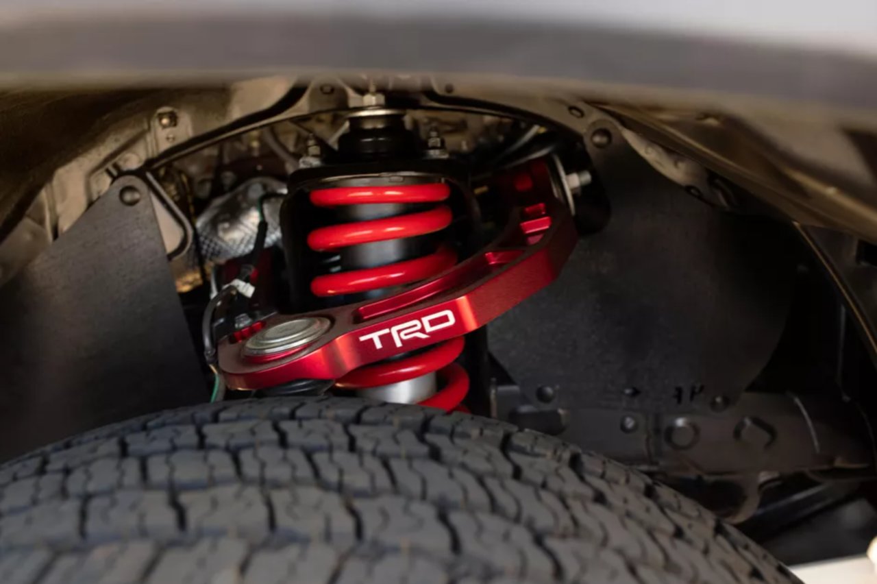

    Additionally, the new 2022 TRD Pro will come with a billet UCA with rubber bushings and a ball joint

    I went with their uca. Didn't come with instructions but pretty straight forward to install. Would have appreciated torque specs though.

    Solved my issues with the OEM stock ones. No more bumping into the springs and adjustable for alignment. Seem to serve their purpose.
    I haven't noticed any annoying feedback like someone else mentioned with heim joints. I imagine if you got heim and uniball that's where it gets rough.
    I put them through their paces today and everything seemed great.
