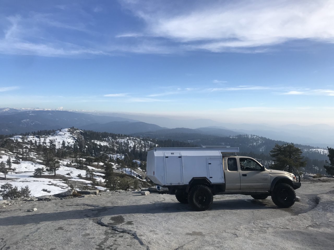

    You can build yourself one of these. It’ll consume your life for a while and take forever and end up costing around $10k including tools.

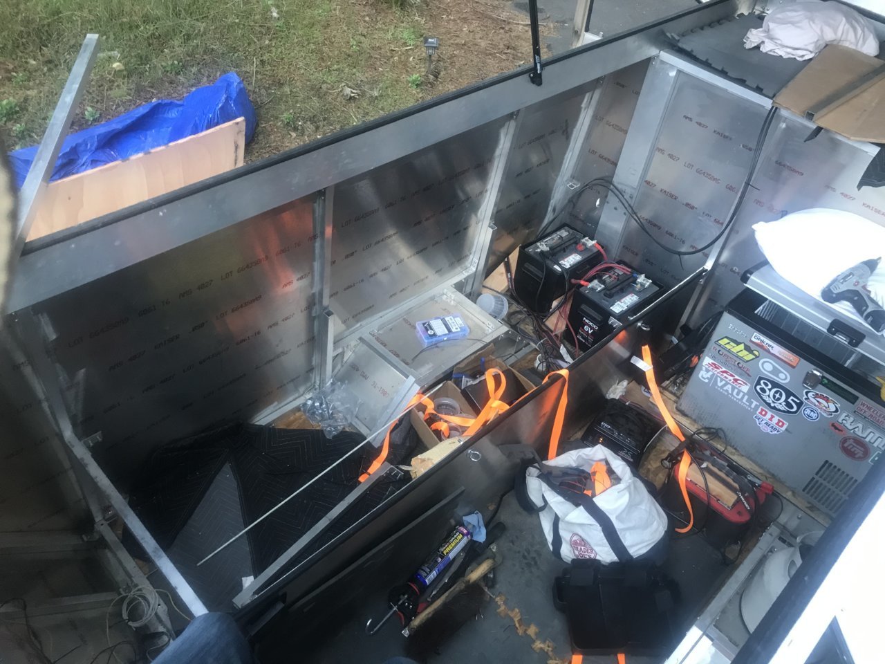

    I only have this one. It’s far from finished. The shot is taken from near the main entry door looking forward/driver side from the rear of the truck. The batteries are in the upper left with the fridge to the right. The batteries, in front of the wheel well, are normally under a sheet of plywood with a cushion on top forming a couch.
    The space under the couch is a lot of storage. I’m going to put an exterior access door near the rear to get to recovery gear and onboard air.

    I was keeping track of the hours for a while but stopped. Based on when I was tracking plus estimates since then I think I'm around 400 hours or so.
    I believe it weighs around 700 pounds as it sits. That's how much all the materials that I bought that are on it including the spare tire, batteries and fridge plus 10%. I still need to add the upper sleeping platform, a kitchen cabinets, the tent, water system and some kind of flooring and interior wall coverings. It'll be around a thousand pounds wet weight in the end.
    The bed, sleeping platform, drawer and camper shell I had before was about 550 pounds so the new camper is a lot more but the weight is distributed much better. It's all lower and in between the axles.
    I have timbren load bearing bumpstops. Before when I had it loaded for a long trip, like to Baja, the truck would sit solidly on the bump stops. Now there's a 3/8 inch gap between the bumpstop and the axel. I think this is due to all the weight being in front of the axle with the exception of the spare tire.
    The only thing I've made like this is my old sleeping platform which is now a shelf to hold camper odds and ends. I do work with my hands but this is not quite the same as cooking.
    There are a bunch of reasons I went this route. 4 Wheel flatbed is super nice. The reasons I didn't go that route is the sides are much taller and straight so if you lean the truck over sideways it takes up a lot of space. The trails I go on can be tippy and very narrow. The 4wheel flat bed don't have much exterior access. While I want a camper I come from backpacking and I've found I get to a point where I no longer feel like I'm camping. I want to spend most my time outside. I just need a space inside for sleeping and in crap weather (although I am known for sleeping on the ground with no tent ) Another issue with a flat bed is in order to clear the tires you either need to limit up travel or create a space between the frame and the bottom of the camper. With mine is sits down lower making the center of gravity lower. The downside to mine is that it will only fit on a 1st gen access cab. Also 4wheel campers cost a lot. They're probably well worth it though.
    Tommy Campers are closer to what I want but not quite. They cost a bit less than a 4wheel camper too. Also, at the time I started this I don't think they were in the US yet. Now they are. Jerks.
    Cost - I could spend a lot more money on this thing but don't want to. I'd rather work less. And I have a lot of other hobbies.
    It was recommended that I start some kind of project after I got t-boned by a car on the highway on my motorcycle in April 2018. It was a means to help recover. I started the camper a year later. At that point I was still having some small physical issues but was also diagnosed with PTSD. Halfway through the camper build I had an accident related surgery. This set me back quite a bit but the camper really helped in recovery. It was the best form of PT I could ask for.
    I kinda wanted something unique. I'm hoping more people will see others making their own stuff and will start making their own. There are a lot of really nice products out there like 4wheel campers, the vagabond drifter and Tommy campers. But making your owns is a good experience.
    I've yet to have that moment where I regret getting into this thing. There's been zero frustration even though I've built a wheel well three times before the version it has now. I've built the main entry door twice and will probably build another. Getting the fuel filler necks (I have 2 gas tanks) to work properly was a huge challenge and still on going. The fridge slide broke in baja and a seam on the camper broke. I'm maybe halfway done but it's all good. I'm looking forward to finishing it.
