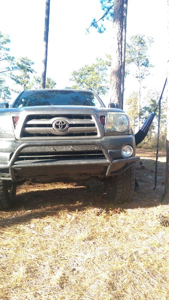

    SlowlyButSurely
    SlowlyButSurely Everything in moderation, including moderation.
    Aug 7, 2015
    #161258
    35
    2010 2.7 PreRunner, 78k miles
    Piaa Fogs BHLM Avid Off road light bar No mas Mudflaps 3in OME all around, 2 leaves removed in Dakar. Sits level Upside-down intake
    IMHO the 255's with an aggressive sidewall (Cooper S/t Maxx) look fine. Kind of a terrible pic but here.
