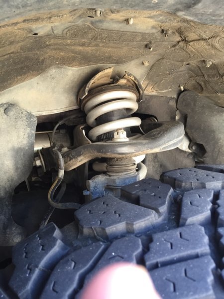

    1st gen shocks don't have a thin neck to clear CV shaft:
    It's still super jarring and can blow the shock, but won't strand you.

    It’s always the same few pictures of busted shocks every time this topic comes up. I’d bet less than 2% of people who have used spacers have had a shock fail like that. There’s obviously better choices for suspension but the shocks won’t magically explode just because you put a spacer on and drive down a dirt road.

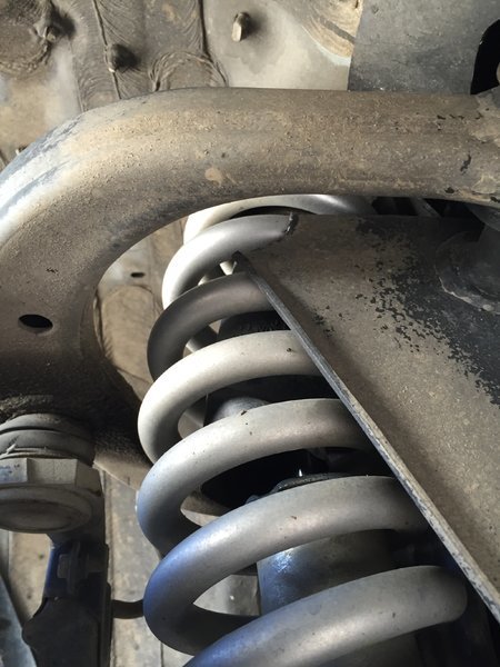

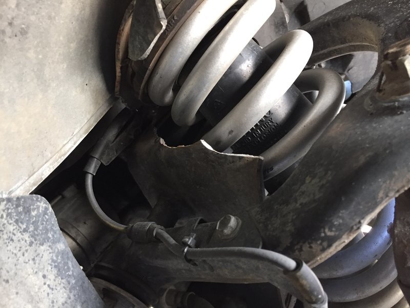

    It doesn’t change the fact that shock will bottom out before hitting bumps, and nothing good will come of that.
    This is from a first gen. Not necessarily from a spacer lift, but the energy from the hit has to go somewhere. This is from hitting a speed bump according to that OP

    A speed bump going 60 miles an hour maybe, shits on a break no matter what in that case.
