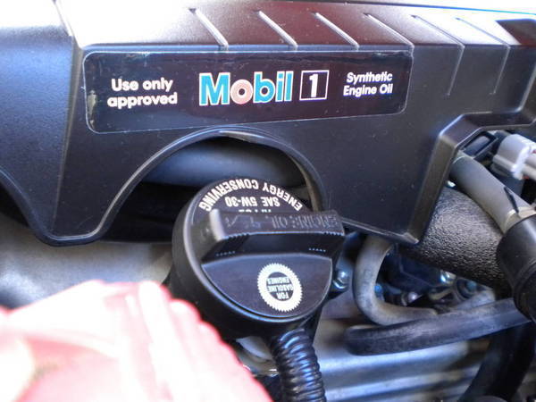

    I have read the owner's manual fairly well, and noticed the following:
    1) The spark plugs are not iridium - they have to be changed every 30K miles, according to the manual.
    2) They want 5W-30 oil in this engine, rather than following the trend towards 0W-20 that Toyota and other manufacturers are following.
    So...If the 4.0 is only a few model years old, why did Toyota follow the older conventions for this engine? Even engines that came out in 2007 in the Toyota lineup had Iridium 100k mile plugs and 0W-20 oil recommendations.
