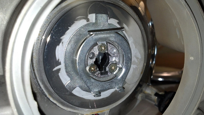

    Just looked at this thread again. OP I feel bad for you that is way too much work to be doing for a product that should be plug and play. I hope the seller realizes how much he has inconvenienced a customer.
    Back to the alignment issues. Did you ever figure out why it was off so much? I mean with the H4 plate installed I don't understand why it was that far off. Mine was a tiny bit but enough to be fixed easily. Just curious.

    I don't know what really caused it as I have never really messed with projectors until having to try and correct this.
    The seller kept referring to some alignment tab that was in the correct position. I didn't really look for anything like that. I basically just held the back up to a light and looked through the front and could see the projector shield, I used a wide blade screwdriver and was able to put it in the slot at the bottom and was able to rotate it until it looked level. The slot I'm talking about looled like the at on the bottom of the image below.
    I did similar to the passenger side but they both still need tweeked a bit. The small phullips heads on the passenger side were already stripped but I was still able to get rotation out of it.
    Whenever I get brave enough to try the lense swap(if the OEM lenses will even fit the Eagle Eyez housings) I might look into it a bit further, but will definitely get them horizontally level.

    Yeah I don't blame you with carrying the extra set. As for swapping out the lense I recommend using a heat gun if you have one. It makes life easier and the heat is only directed in the area you want it to be so you don't have to worry about the entire thing heating up. Plus it doesn't take as long. If you don't have one you can get one at Walmart the probably for around $20 for a cheap one doesn't need to be anything special

    I can get a heat gun, doubt it will take much to remove the retro lense, it looks to be only attached with clear silicone and the screws. Just hope I can get it all cleaned up for the new lense.
    My biggest concern is the fit of an oem lense with an aftermarket housing, have a feeling I will be dealing with some sort of issue, either moisture or contours being slightly off.
    What do customizers normally use to reseal the lenses? I have some pretty good new silica packs already so I'll probably thrown one in each housing if I opt to go that route.
    Only other option is to find someone to do my factory headlights the right way. I haven't ruled that out yet, but by that point I'll be in it for $1500+.

    I know mine is an 04 Tacoma but I used just the lense on my housing and it fit just fine you should be alright. If you go to theretrofitsource.com they have the same glue that you use to seal up the housings

    Headlights failed this morning. Haven't had time to troubleshoot, but was a long dark drive to work.

    Ended up being a blown fuse. Not sure what it takes to pop the 25 amp fuse in the morimoto harness, but doesn't seem right.
    Not sure if blown fuses are a common occurence or not.
    Might see if I can get the pair of lense donor assemblies to install and see how much someone competent would charge to transfer everything over to my factory housings. I'd supply everything but the paint(don't want hazard shipping for aerosols). Just want it done right.
