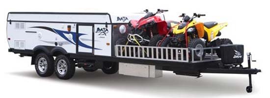

    We are looking at something like this

    Would have but I just bought a new camper without one. So oh well. Like the look though
