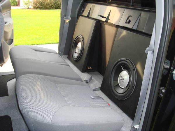

    Still trying to fine tune a descent sound system for my Tacoma. So far I think this is going to be the set up. Your thoughts, comments and opinions are welcome. Like I said, trying to fine tune before I purchase, but I think I'm very close. I don't want a competition series sound system, but I do want something that sounds nice. If 1 is for a crap system and 10 is competition, I'm looking for about a 6 or 7. Am I on the right track? Check it ...
    JL VR690-CXI front doors
    JL VR650 rear doors
    JL Stealthbox dual 10"
    Stock tweeters for now
    Alpine PDX-5
    I'm leaving the stereo stock to make it look like nothing has been done, but if someone decides they still wanna take a closer peak without my permission, they will have to face the Python 991 alarm/remore start system.
    Thoughts?

    The stealthbox is way overpriced for what it is... save money there
    Put C5s in the front doors... use the money ou saved on this upgrade ($300 for a component set) There is just no way Id be OK with a low end coaxial set in the doors and keeping the stock tweeter on top of that? No way...

    I was looking at the Stealthbox too, then I remembered I had some JBL subs lying around and built a box for them. Total investment: $50 for materials. The subs were a hun something when I bought them I think.
    Sooo, 600-700 for the JL Stealthbox turned into $50 and a few days worth of tinkering. With the money you save you can buy some wicked other stuffs, and I'd definitely go component for the front doors if I were you.

    I'm getting the Stealthbox at a pretty good deal. $599. I also don't want a huge box going accross the entire back seat of the Taco. I keep all my fishing lures, leader line, gloves, pliers, etc on one side, the stealthbox goes in the other side. It's perfect in that sense.

    Hynrid Audio Imagine on all 4 doors
    JL 13TW5 sub in one of Mr. Marvs custom boxes
    JL HD900/5
    Thanks to Mr. Marv for his advice!
