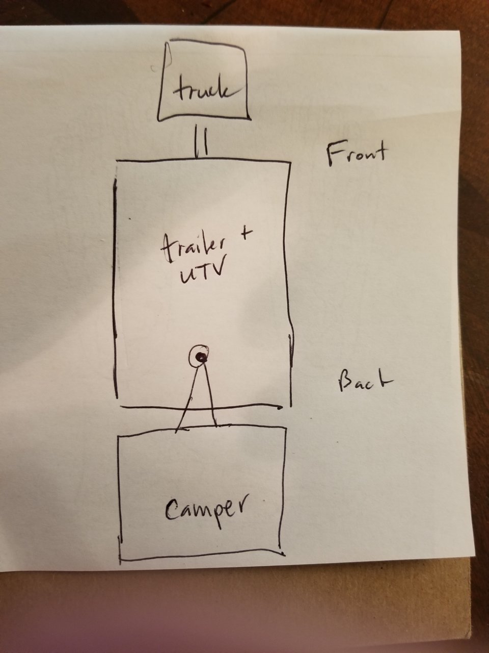

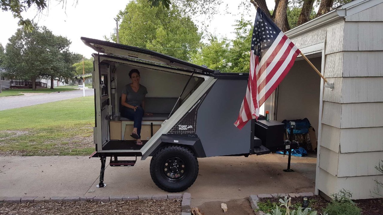

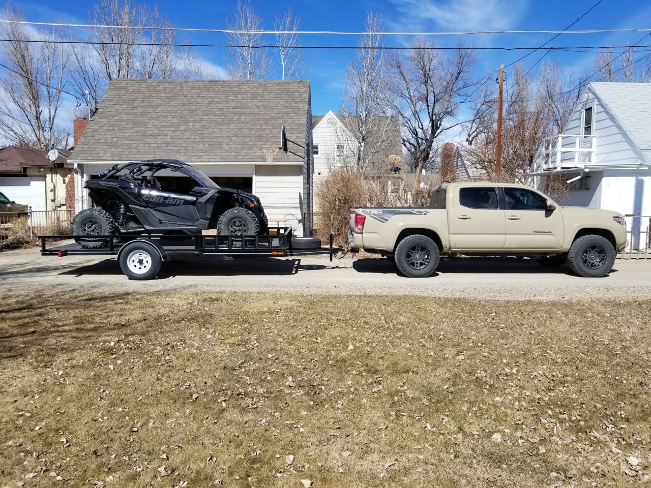

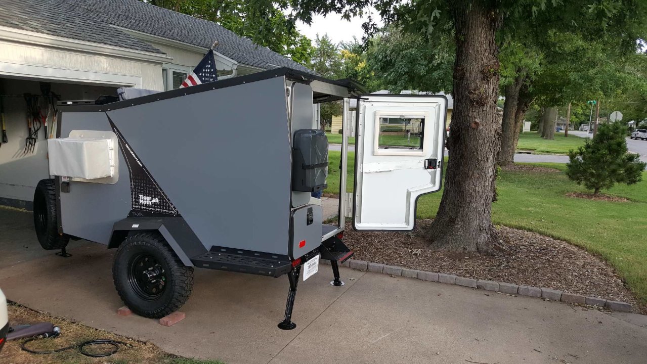

    I have a 3rd gen sport with the tow package. I currently have a Taxa Tigermoth (900lbs, maybe 100 more in racks attached to it). I also have a Maverick X3 XRS (1650 lbs). I also have a trailer (14 foot bed, 17 foot total length weighs maybe 1000lbs). I want to tow all three. So total would be roughly 3750 - lets round up with gear - 4000lbs.
    I will add some sumo springs to the rear end. I will add trailer brakes to the UTV trailer. What I have in mind is having a custom made 2 inch ball attached to the bed of the trailer, maybe 2 feet from the end. Then the camper overlaps/attaches to the trailer, making a 1 piece dual axle trailer ( I will make sure level with whatever modifications necessary). Overall length would be maybe 27 to 28 feet. Is this feasable? Or do I just install a hitch to the back of the UTV trailer and have another articulation? The overall length would then be 17 (trailer) and another 12 for the camper.

    - The camper is very easy for me to pick up and move by myself even without switching out stand for the wheel.

    The idea of putting a ball 2 feet short of the back of the flatbed is bad. The moment you go over a crest (ie driveways) the trailer will see-saw & the end of it will rise up to hit the bottom of the camper trailer tongue. Installing a standard receiver hitch (like what's on your truck rear) to the back of the flatbed would be the best bet. Towing doubles takes a lot of practice, space & forethought when parking. Check your local laws on towing doubles when neither is a 5th wheel or gooseneck.

    Ok, that makes sense about the see saw....assume this is all legal ( I have read some laws and will contact state highway ). Can my tacoma triple tow 4000lbs with 2 articulations - short version?

    Nothing really needs to be custom to the Utv trailer just weld a receiver and use a drop hitch flipped. Your putting brakes so your good there. You have more rolling mass with the two trailers and even though the last one isn’t heavy it’s added rolling resistance and drag. The truck can pull it but it won’t like it and I would be very hesitant to tow it far. I’ve towed a lot of crazy shit from cars, trucks, ambulances, random over sized objects, cattle on under sized vehichles and trailers and it always sucks and never feels safe.

    Your drawing is a BAD idea. The rearmost trailer has a lot of potential to wag the front trailer based on that weight distribution. Do what @TACORIDER suggested, it will be simpler and have far better road manners.
    I don't think you'll have a problem pulling it if you're ok going 65mph max. It'll be rough past that. I agree with the requirement for adding trailer brakes.

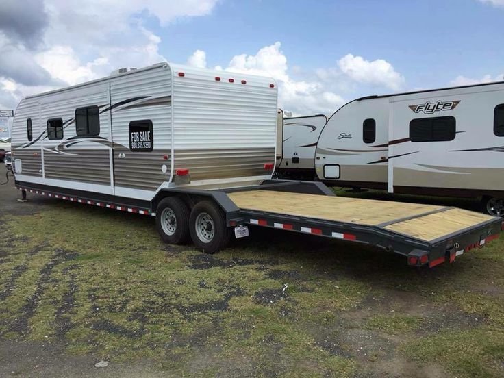

    If I had the toys you have, I'd sell the trailer the UTV is on and buy a bigger tandem axle, then put the camper on the front of the tandem axle. If you go that route, make sure the axles on the tandem are in a good position with the UTV to give you an appropriate amount of tongue weight. Think the below, but smaller:

    Buy a tandem utility trailer (~30') with hydraulic disc brakes on both axles. Hitch the camper on the Maverick and drive both right on the trailer. Tie down the Maverick & the camper to the trailer. Safe as can be.... Bonus, if you go riding with someone else, you can fit 2 side by sides on the trailer...

    FYI this is towing doubles not triples. Weight distribution is your friend, that Maverick has more weight on the rear axle so backing it on the flatbed would be a better scenario methinks. 60/40 front/rear trailer weight is the rule of thumb. Assuming the camper only has 150ish pound tongue weight it won't have a huge force on the back of the flatbed. Wagging is probably your biggest issue, but having brakes on the flatbed that you can tap will help calm things down.
    Welding a hitch on is only a couple hundred, then another couple for brakes & a controller. If it doesnt work out then you're out less than $1k, not much skin lost for trying :spending:

    1. Install the brakes on the UTV trailer. You should do this even if you're not double towing.
    2. Weld or bolt 2" reciever to back of the UTV trailer. Bolt's probably fine, your camper trailer is a picoweight.
    3. Wire extensions to the back of the UTV trailer for taillights. Install hitch, you'll probably need a 5" drop hitch installed upside down, but it really depends on your trailers height difference.
    4. Hook it up, and hope you don't have to reverse. :rofl:
    You're going to be LONG. If you haven't towed a long camper trailer or similar before, be really careful at first and swing your turns very wide. You will need a lot of room on the inside for cornering, because that travel trailer is going to track in even more than the UTV trailer will.
