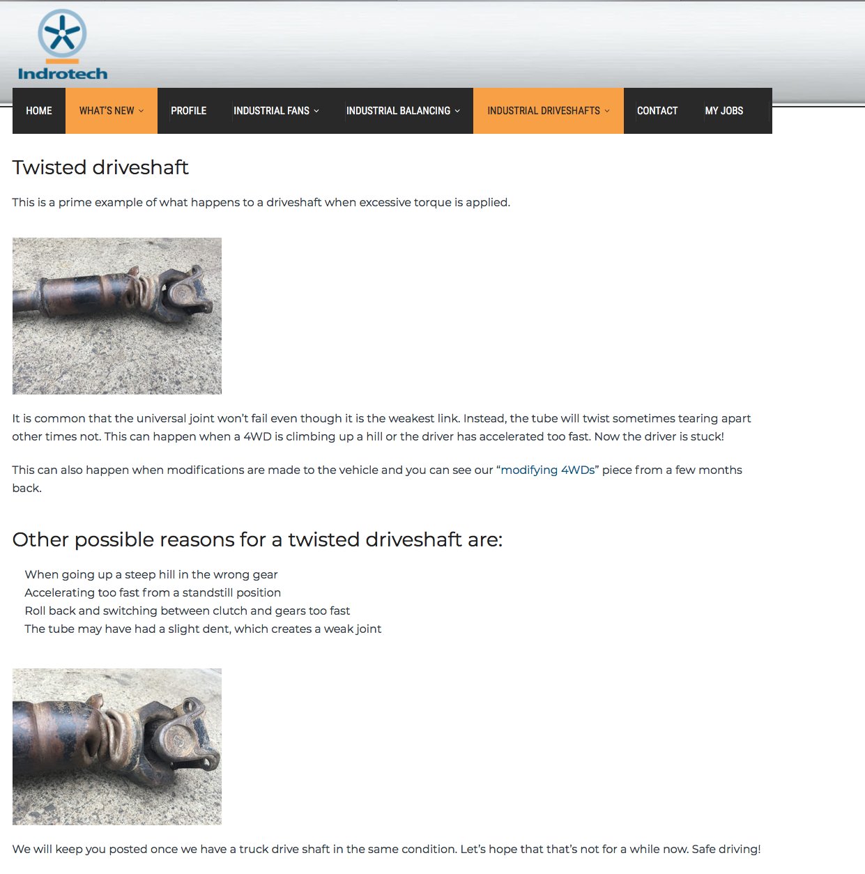

  11. Mar 4, 2019 at 12:31 PM
    #31
    eon_blue
    Mar 4, 2016
    #180213
    69,989
    Azusa, CA
    From @Boghog1 's link at the top of this page...looks like it was probably a combo of the wrong things at the wrong time
    Slashaar, su.b.rat and Boghog1 like this.
