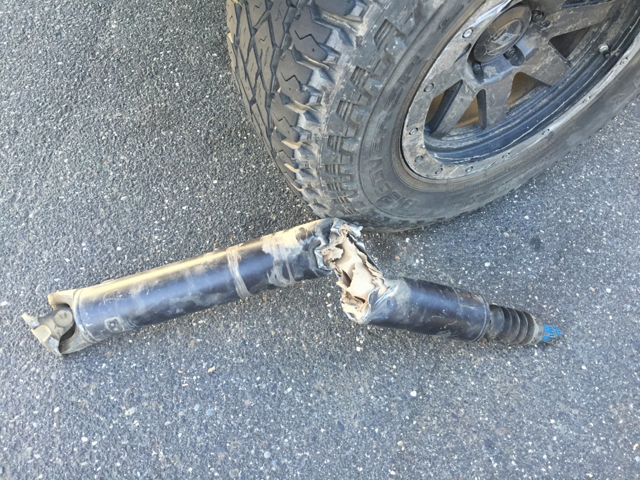

    Front tires or tire had to be hung up on something. Drive shaft was weakest link.

    There may be nothing to it, but both this truck, and the Ford "LOOKED" like there had been some previous stress on the driveshaft. I've got to wonder how many miles these trucks had been driven in 4X4 on pavement prior to this. Doing that would stress the front drive shaft much more than the rear shaft and weaken it to the point where it would fail first. Nether truck had damage to the rear shaft which I'd think we should see too.

    Purely FYI, but the stock rear driveshaft has cardboard inside the tubing. It works really really well as a fire starter.

    ZOMG there must have been previous damage or rust! Maybe bound up?

    Only time I’ve used 4wd was when I needed it in snow, sand or mud. Most of the time 2wd does just fine
