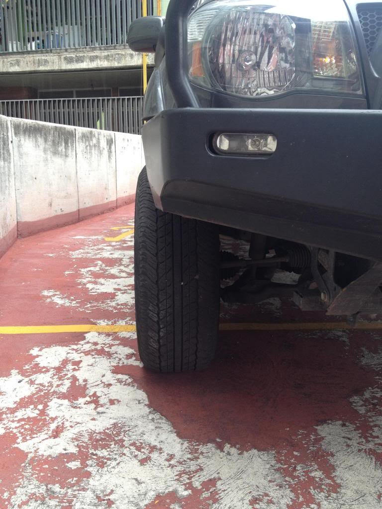

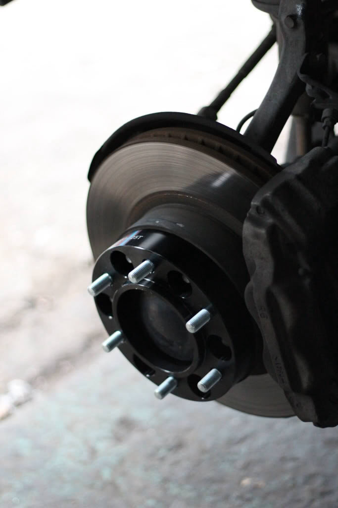

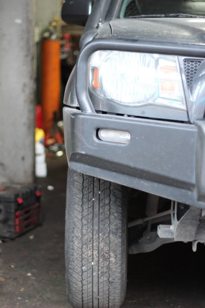

    I have 1.25 wheel spacers with no problems!
    If you want to buy them, buy them from a good company, remember all the weight and stress lies on the lugnuts and now in the spacers...
    Aaaaaand just make sure that you clean everything before installing, do not overtorque anything and use locktite...
    Many will say it's dangerous, many will say it's not... do a little more research and make a decision...
    BEFORE:

    INSTALL:

    AFTER:

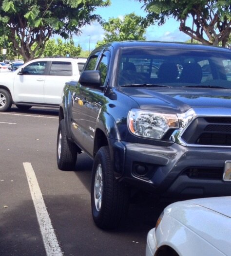

    I got the 1.25" spidertraxx spacers too on my stock trd's. I like how it gave the truck a stalkier stance without being too much.:)
