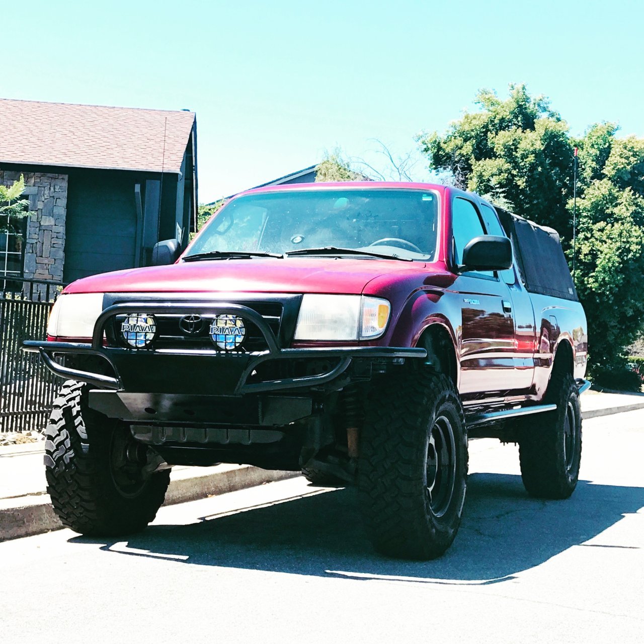

    Wheels: SCS F5’with 3.5 backspacing
    Tires: Falken Wildpeak MT’s
    Lift:OME with 882 springs, SPC UCA’s
    Bumper: homemade with no winch.... yet

    Do you chain smoke cigars? Your windshield looks ruff.
    Yotakid1998[OP] and NcTaco27 like this.
  8. Aug 10, 2018 at 12:20 AM
    Fuergrissa
    Fuergrissa If you build it, trails will come.
    Jan 9, 2013
    #94858
    2,123
    Devin
    San Jose
    2000 T4R Limited
    Hahha Nope, I removed the windshield wiper fluid reservoir and haven’t found a decent replacement
