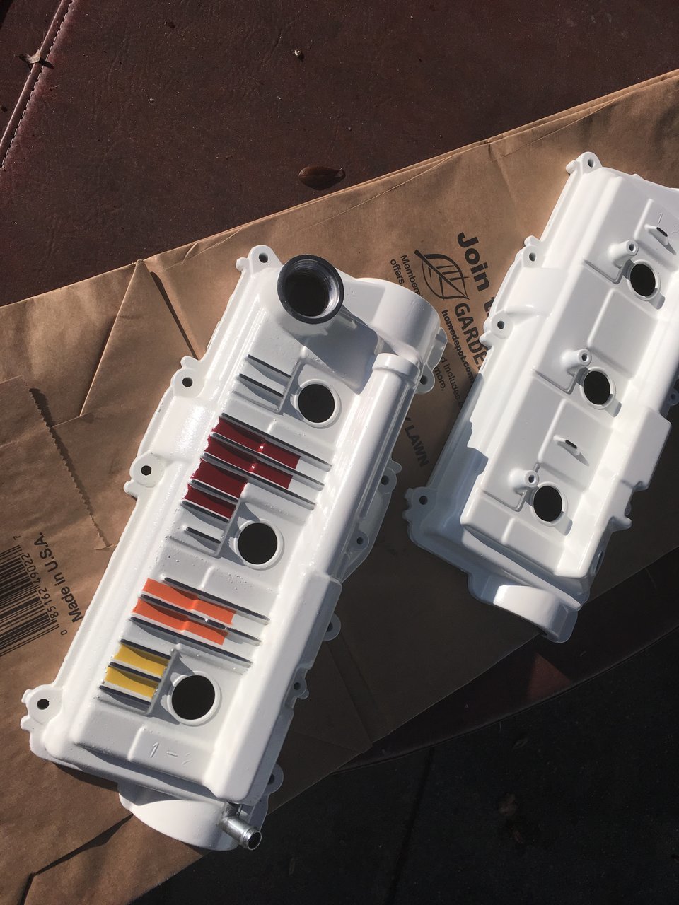

    Yes, this is really the question. Roughly $20. I've made my decision but I'm still interested in hearing opinions.
    It gets a little more expensive depending on what I'm going to do. I found someone with both valve covers at a decent price so I bought them both. After I inspect them I am thinking about polishing the new ones or painting them. On my Miata, when I was in my 30s, I polished the valve cover to a mirror finish and put a engine turned finish down the center of the valley. It looked awesome and I wish I had pulled that valve cover off to save it. I also wish I had pictures of it.

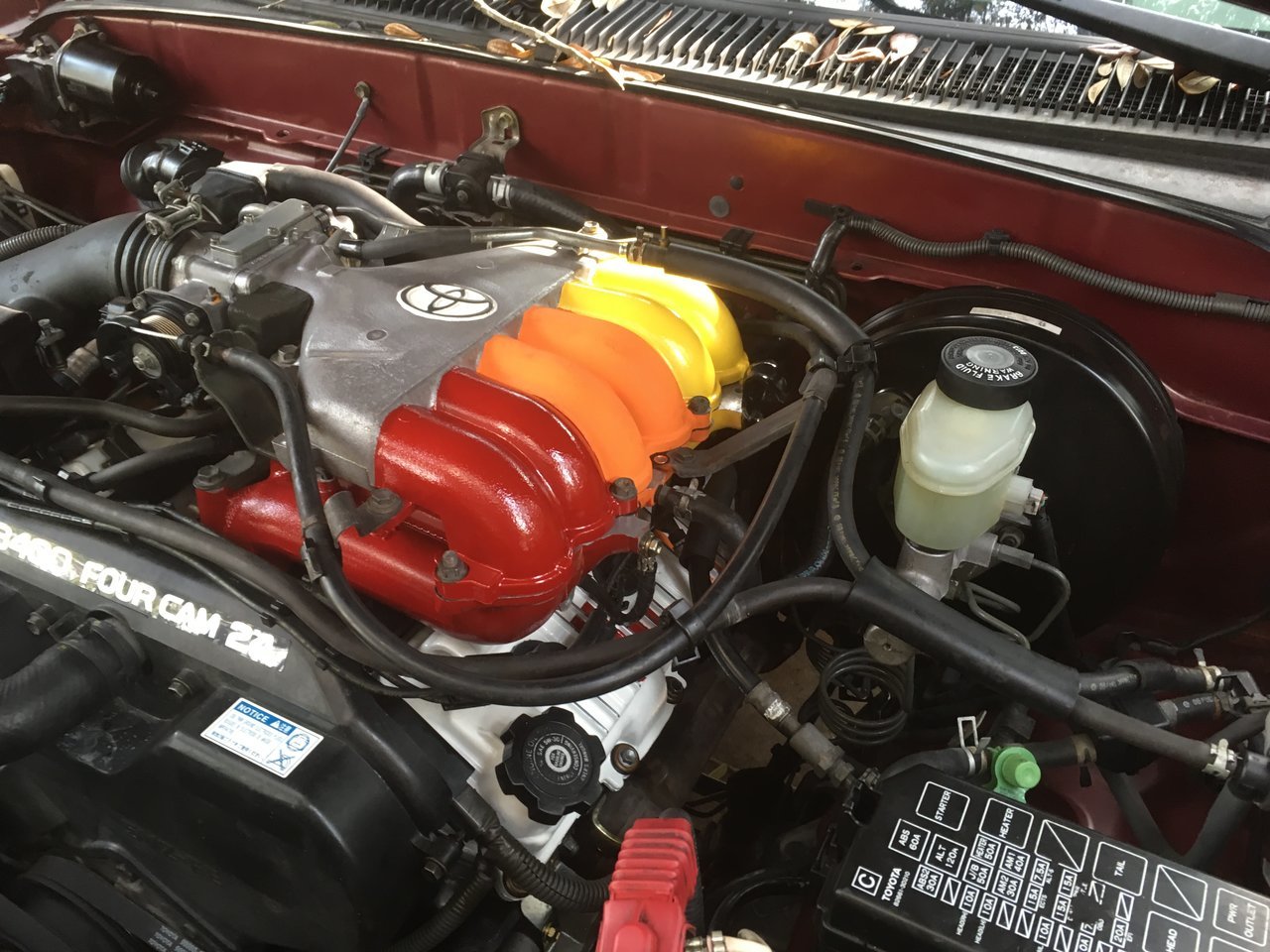

    The valve covers on the 3.4 are mostly hidden and the casting is pretty rough so a quality polish will be very difficult to do. Painting might be cool but again the covers are mostly hidden. Here is an example.
    @Rons01TRD did this one, I think.
    As I said I've made my decision but I could be swayed if y'all would like to continue to try.

    Yes, I painted those with high Temp paint. I wanted more of a Red color that was on the cap.

    Wow! That looks really good with the red! My engine bay is always super dirty!

    Since the valve covers are cast I didn't think polishing would give them the consistent shine I would want but painting was easier and a lot less labor intensive.

    They look fabulous. How are they holding up? How long ago did you paint them? Any special prep work? I agree with you on polishing. I could get them to shine but that isn't the look I would want to go for. If I'm going to polish I expect a mirror finish and if that is even possible with these covers then I'd be looking at many 10s of hours.
    What brand of paint? Just a rattle can?

    I sold my Tacoma a few years ago but the paint was holding up very well. I think it was VHT high temp paint (rattle can). Clean and prep was the main factor, the valve covers have passages and baffles and to get tape to stick and get everything oil free was difficult. I think it took me longer to prep and paint than it did to just change the valve covers. I had the truck two years after painting the intake and valve covers and it was holding up very well.

    Savannah, GA
    2003 Double Cab V6 PreRunner TRD
    I decided to replace the gaskets but wait, to order, until I pulled everything off just in case I needed to order some thing else. But when I had everything pulled off the gaskets are perfect and I decided to reuse them. I also decided to do a little painting too.
