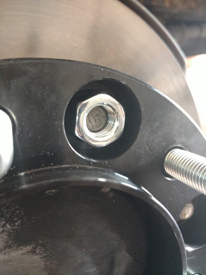

    I was installing 1.25in hub centric wheel spacers from Yita Motors. This is them --->( https://tinyurl.com/ydx8eex2 ) My question is what is a safe thread engagment on the wheel studs. Im getting between 6 and 8 turns. Is this safe? I will attach a picture. I'm aware of proper wheel troque on them and checking them and using red loctite. It just doesn't seem like a large enough bite on the threads.

  2. Jun 18, 2018 at 9:14 AM
    n1as

    2016 Tacoma DCSB TRD OR
    Not an expert but I wouldn’t go with that. Wheel stud should be fully thru the nut plus IMHO.

    5100 Bilsteins front; 17x8.5 Fuel JM2 racing wheels, 265/70/17 Nitto Ridge Grapplers
    IDK about other spacers. I went with BORA only because SpiderTrax is limited to 1.25 inch. As to your question, the lug should fully seat into the lug nut as described by n1as above. My BORA spacers even had a few extra threads exposed all said and done.
    I can't really tell from the pic, but are the lug nuts tapered or flat ? Should be tapered IMO and seat deep into the adapter.

    33's Bedliner Nerf Bars (Custom)
    they are tapered. I think its called acorn style?
    Yep, so you have the correct lug nut. Something definitely not fitting correctly then. The lug should go nearly all the way through. If the adapter isn't matched to the acorn lug nut there in lies the problem. You shouldn't have to modify anything on the hub, esp. the lugs. Doing that is counterintuitive to the purpose of the adapter itself. The only other thing I can think of is that the threads aren't matching. I would check the thread specs on the lugs (if they are stock you should be able to find it pretty easily) against the lug nuts that were sent before going any further. Easy check, try to thread one on without the adapter. If it goes, then I would believe it's the cut depth on the adapter.
    yeah they are correct for the threads. When you meant cut depth do you mean the hole in the adapter the lug sits in?
    Wait, I think I missed something. Are you using the stock Toyota lug nut on the hub ? - not sure I caught that earlier. I believe the new lug nuts should go with the adapter lugs when you put the wheel on.
    The picture I attached should clarify that for ya.
    Hmm. On the original post, that looks like a new nut which might be the problem. Try the stock nut on the stock hub, the new nuts with the adapter. Yeah, I was referencing the hole depth for seating the nut. This has got to be frustrating for you. I don't get it, it should fit. I was just looking at the adapter you bought.
    Update: This is what the company that sold me said.
    "7 turns is just fine, make sure you get 5-7 turns before tightening. and must be torqued down to Factory Specs."
