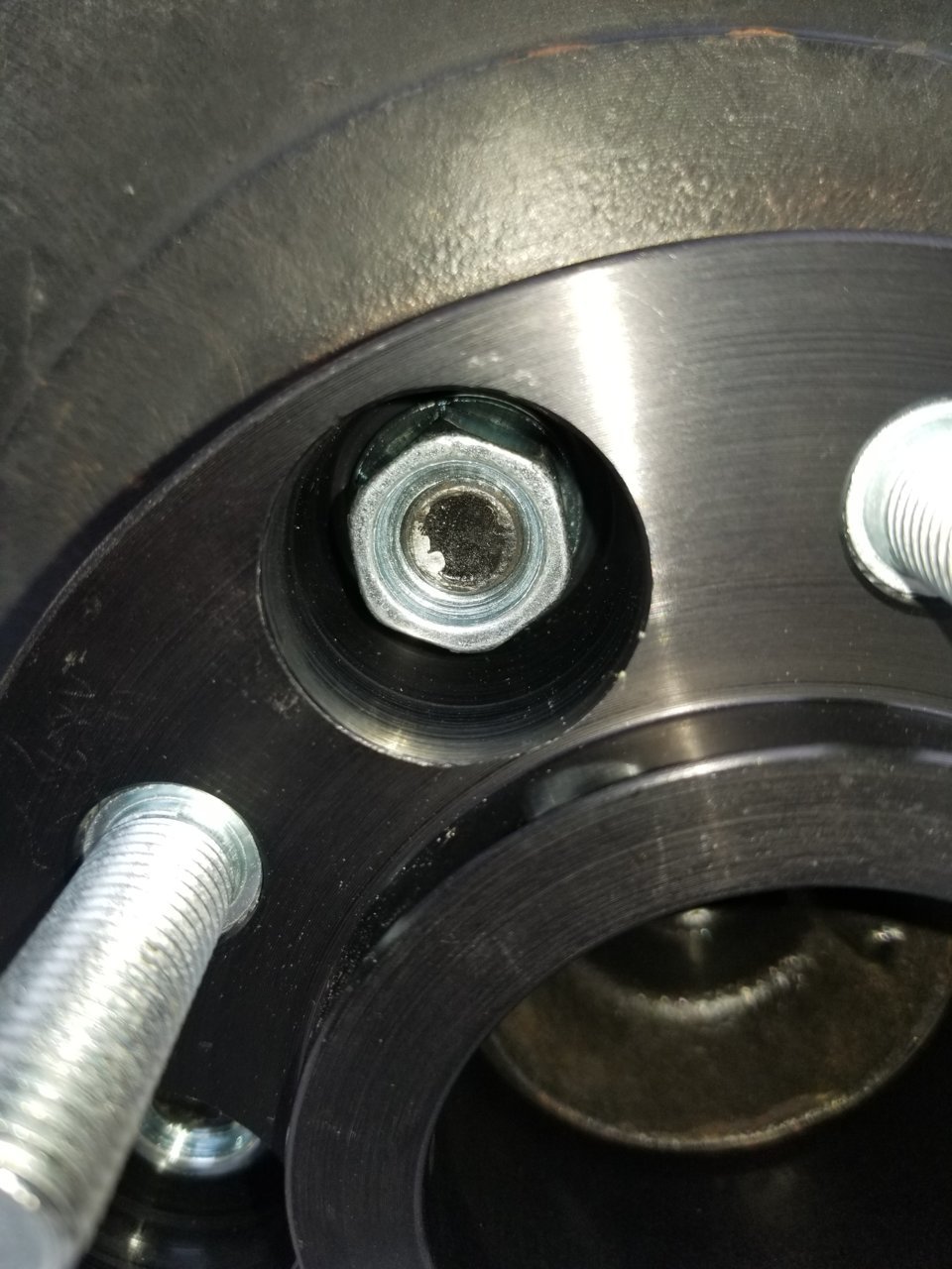

    @Sandman614 yeah thats what they gave me. My guess is the hole is not large enough.

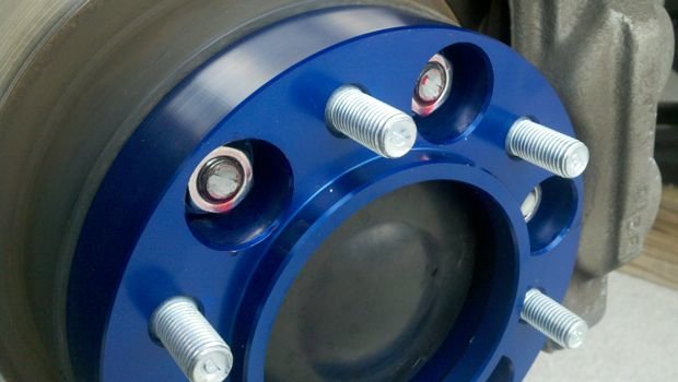

    There is just some difference in thickness in the lug nut holes.
    40932d1298937244-spidertrax-wheel-spacer_8d7ae2a18b0a2884eab09dfb377163229c0270b2.jpg

    Idk that extended lug nuts are the right solution.. Will they fit down the stud bore of the spacer?

    @Sandman614 I don't know. I don't have one to try. By the picture they have it seems it will work. @scottalot someone used these before and they broke?

    get some measurements.

    @Sandman614 what should I measure? The bore hole width?

    Diameter, yes. Both sizes in the hole.

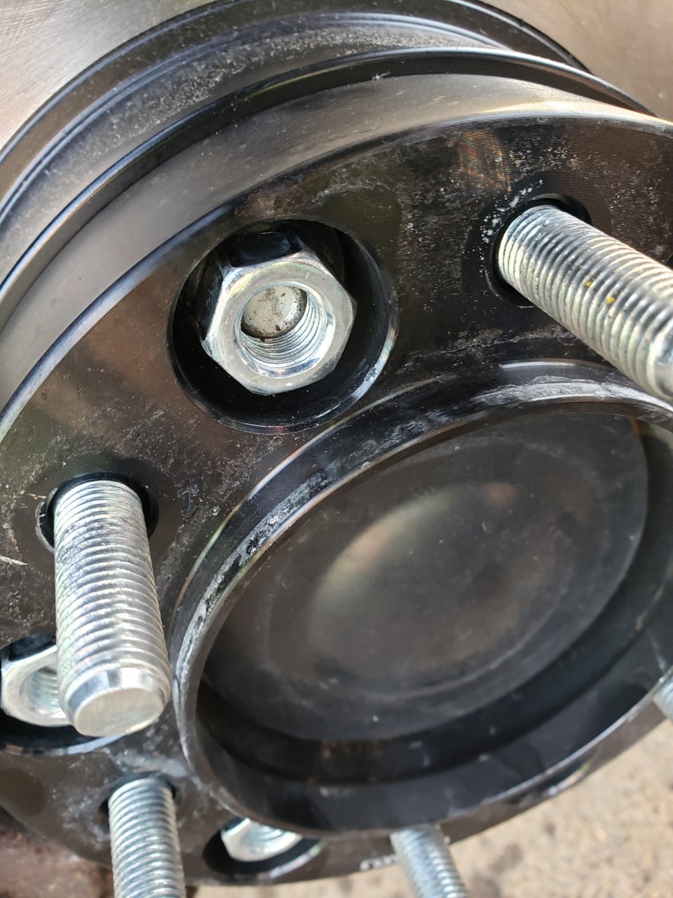

    i added 2” spacers on my taco and have the same thing going on with mine. Have you had any issues?? So far ive had mine on for 2 days and havent had any issues but just curious if you had.

    I was just getting ready to start a new thread on this when I found this one.
    I was told it was how they mount by a company that installs them. They told me they put on hundreds over the last couple years. Personally I don't like it and I am in conversation with Yita Motor about this. I think the extended lugnuts are the way to go if they fit.
    I will post an update when I hear more. If anyone knows more please post.

    Here is what is needed to be correct. Not sure why they don't send these with the kits.
    @Wheeler's Off-Road Inc has the in stock.
