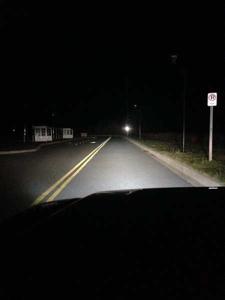

    For anyone reading this who hasn't seen the rigid bar on, it is BRIGHT. A buddy got a 50" knockoff double row bar that was rated twice as bright as mine. Needless to say, mine is way brighter. DEFFINATLY spend the money and get the Rigid if you're looking for useable light.
    No lights, FX-R retro headlights and rigid fog lights, SR2 30" in lower valence.
    All photos have same settings so visible difference is more true.

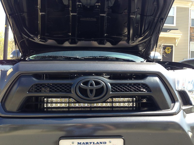

    image.jpg I got the BAMF light bar bracket and a 22in OPT7 light bar behind the factory grill image.jpg

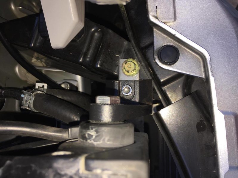

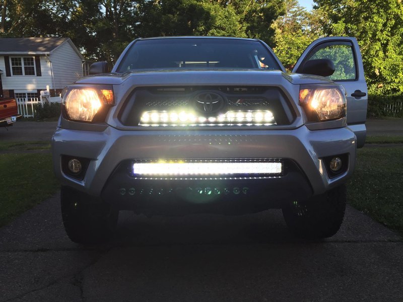

    I'll add this here for anyone that might find it useful.
    Both are 30" bar. My old bar I put behind the grill (other is a calirased 4d -- very nice bar).
    Install took me about an hour but that's due to using a dremel (no angle grinder). I used some thick steel stock and cut it around 1.5-2" and drilled two holes. I used I had to drill two holes for mounting and reused the led bar brackets. It's not 100% ideal but it's pretty solid. It does take some measuring/test fitting to make sure the light fits behind the factory grill on a '13. Going fast on rough roads I do see a little chatter but it's not bad.
    If you go in the lower grill you can't beat the Apex Fabworks brackets.
    I can't really comment on light output yet... The bar is older and I have them wired together so I can't switch between the two just yet. This was a boredom project until I can afford the BAMF mount.
