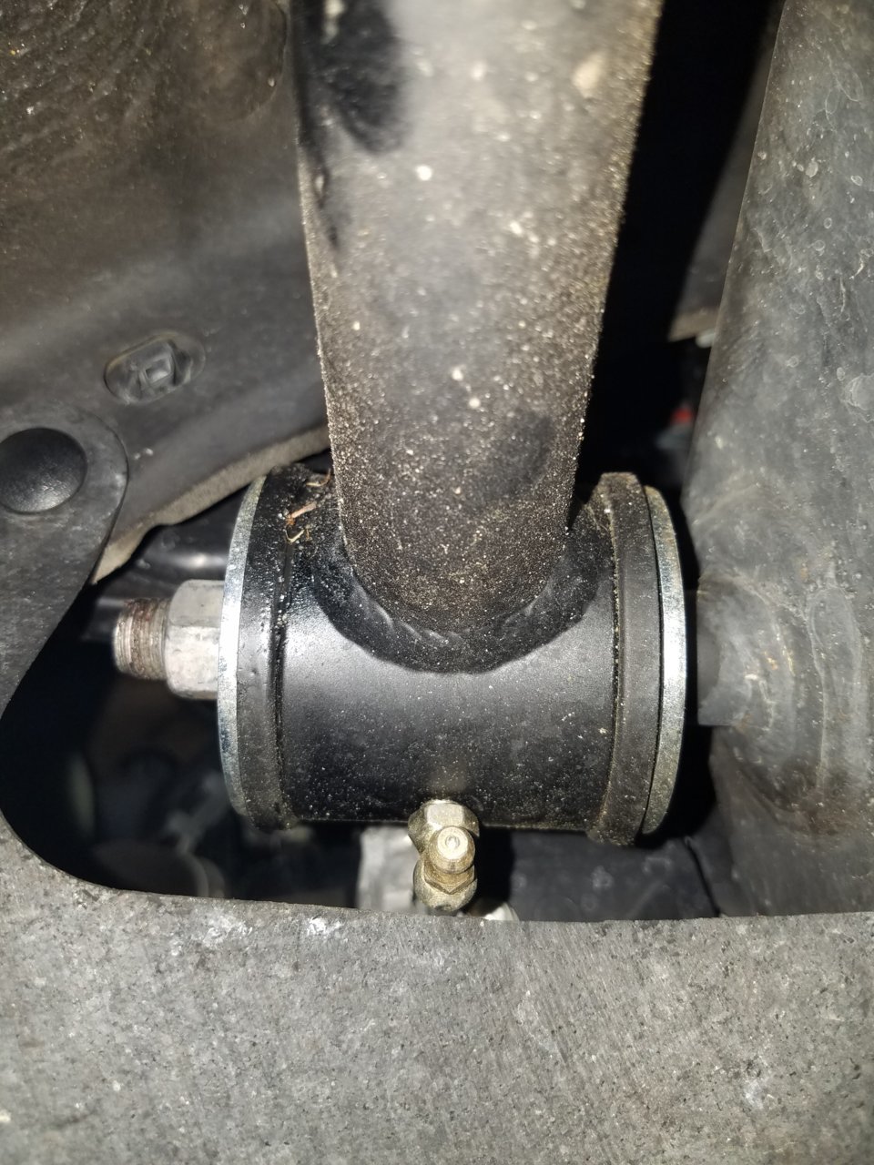

    Two thoughts - 1) go ahead and try to break them loose manually; and then 2) use heat, applied as close as possible to the site of the loctite with wet rags over the bushings.

    I thought about something like wet rags but even then I don't see how I would avoid heat transfer to the bushings. Here is a pic that shows the situation:
    As you can see a metal washer is all that sits between the bushing and the bolt. Heat would transfer through.

    Don't use a torch, use a heat gun. You really don't need to get it that hot to soften the locker.
